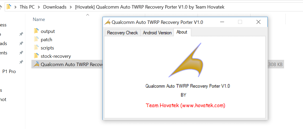

If you wish to root your Qualcomm Android phone, we'd dropped a guide on rooting using Magisk and stock boot.img at https://www.hovatek.com/forum/thread-21427.html , no custom recovery is required.
We'd already released a Mediatek TWRP porter and Spreadtrum TWRP porter. Now, its time for a Qualcomm TWRP porter.
[Image: Qualcomm-TWRP-porter.png]
  • Stock recovery.img (extracted from the firmware or by dumping the phone's ROM using Miracle box, NCK Pro, Infinity CM2 etc )
  • Download QLM Auto TWRP recovery porter by Team Hovatek from the link at the bottom of this post
  • Windows PC
How to port TWRP recovery using Team Hovatek's QLM Auto TWRP recovery porter
  1. Extract the QLM Auto TWRP recovery porter zip
  2. Copy the stock recovery.img into the stock-recovery folder
  3. Double-click Auto TWRP Recovery Porter.exe
  4. Click the Recovery Check tab then the Check button to confirm that the tool detects the stock recovery.img
  5. Click the Android Version tab
  6. Click your Android version and wait while the tool ports
  7. Lookout for a DM_Verity status message
  8. Check the Output folder for your ported TWRP
