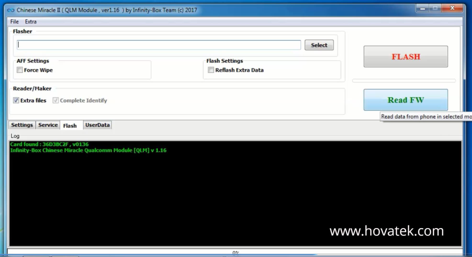

  2. Click the Flash tab
    [Image: How-to-backup-a-Qualcomm-Android-phones-...-QLM-2.jpg]
  3. Click Read FW
    [Image: How-to-backup-a-Qualcomm-Android-phones-...-QLM-3.jpg]

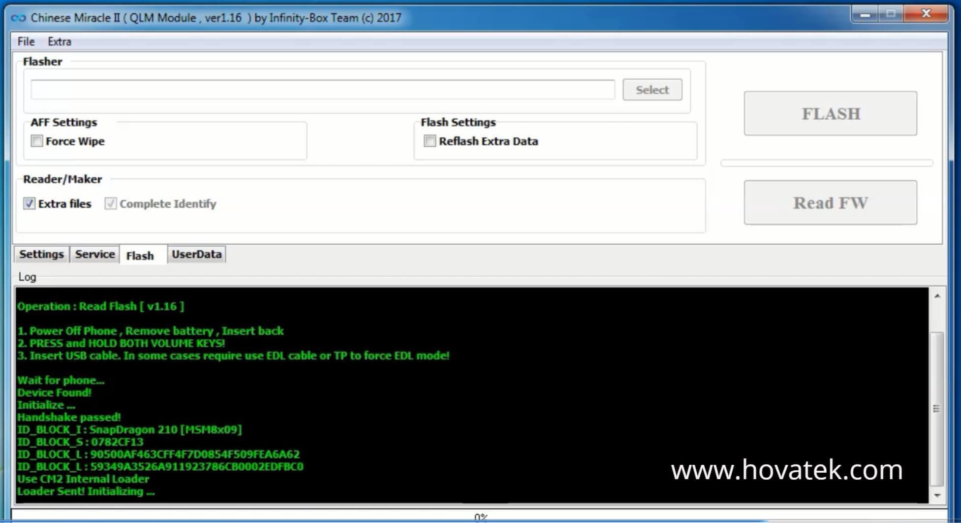

  4. Once you see Wait for phone... , Power off the phone (still with battery inside), hold both Volume Up and Down buttons then connect the phone to the PC via a USB cord (this boots the phone into Emergency Download / EDL mode)
    [Image: How-to-backup-a-Qualcomm-Android-phones-...-QLM-4.jpg]
  5. The device should get detected
    [Image: How-to-backup-a-Qualcomm-Android-phones-...-QLM-5.jpg]

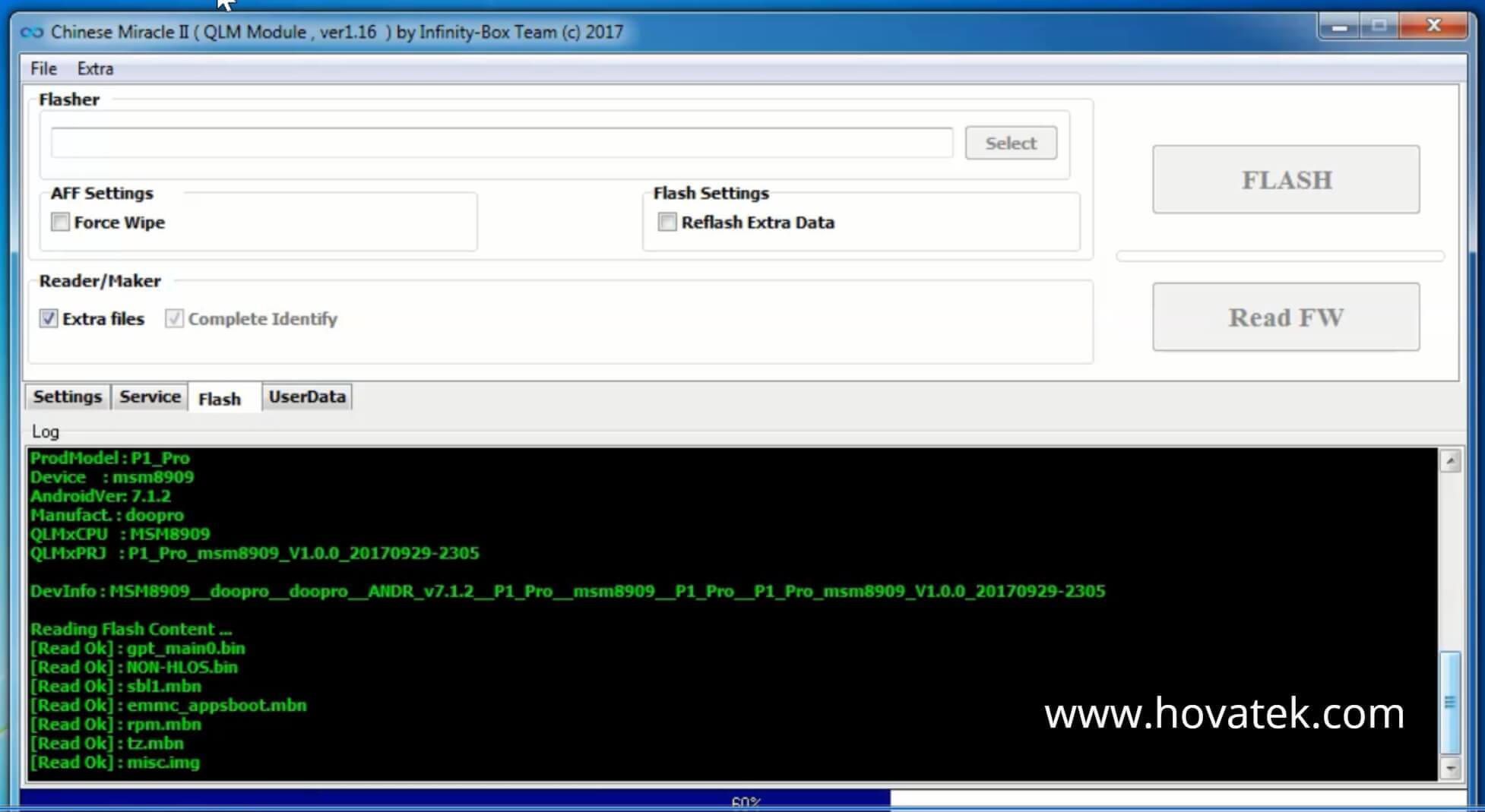

  7. Infinity Chinese Miracle II QLM should start backing up the phone's partitions, do not interrupt
    [Image: How-to-backup-a-Qualcomm-Android-phones-...-QLM-7.jpg]

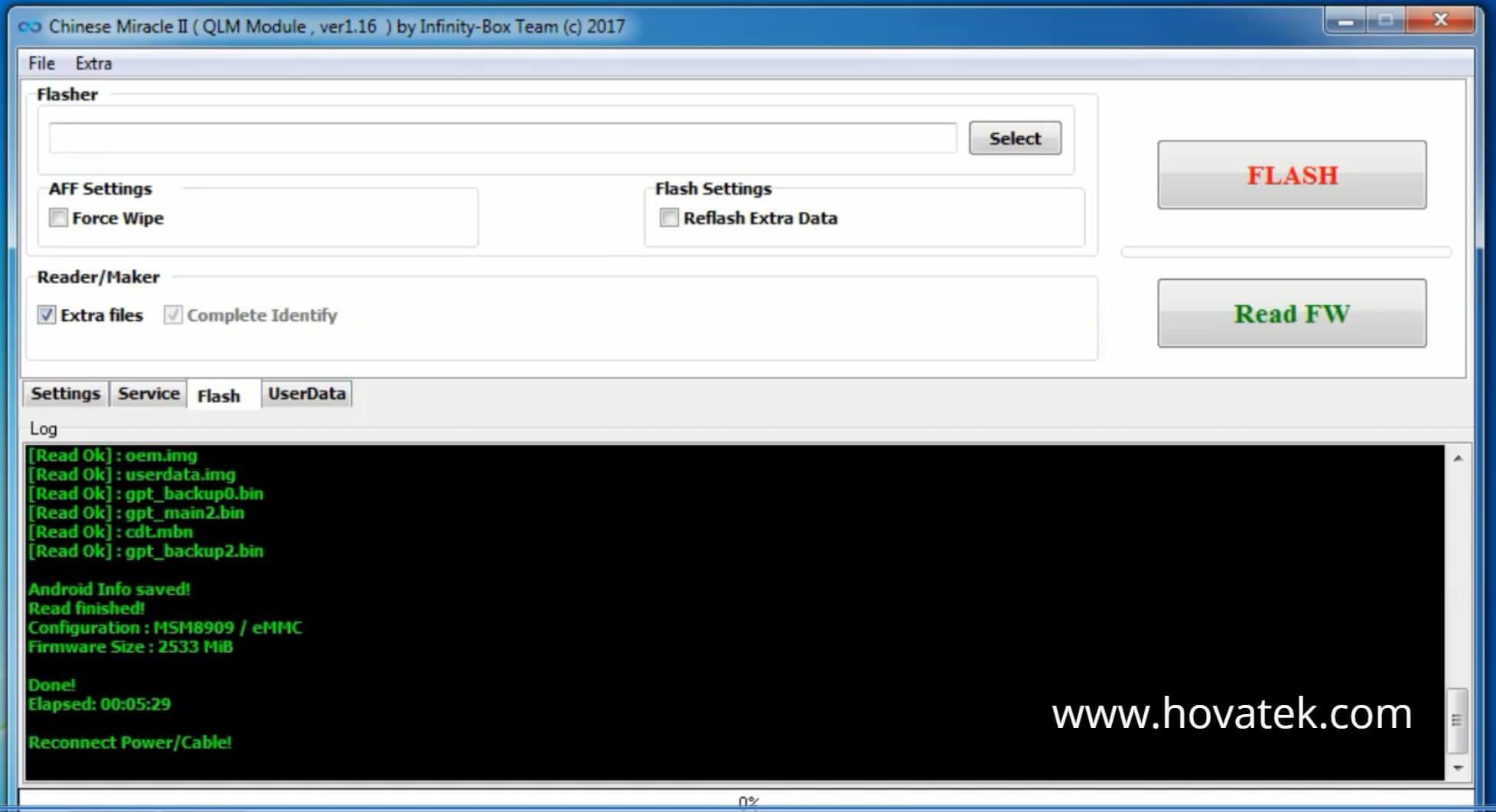

  8. Once backup is complete, you should get a Done message
    [Image: How-to-backup-a-Qualcomm-Android-phones-...-QLM-8.jpg]
