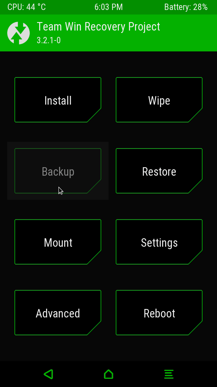

Alternative 1 - Use OTG-Mouse in TWRP
  1. Boot to TWRP recovery
  2. Connect the OTG-cable to the phone then connect the mouse
  3. A little mouse icon should appear in TWRP, you can move the mouse around and select items by left clicking
    [Image: TWRP-otg-mouse.png]
