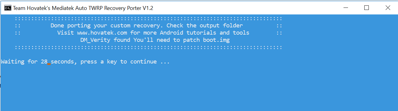

DM_Verity & Auto TWRP porter tool
DM_Verity found You'll need to patch boot.img
In MTK Auto TWRP porter v1.2, we included DM_Verity checker. For a recovery image with verity_key in ramdisk, the tool will give a warning like:
If you see this warning then the TWRP recovery won’t work (when flashed) unless the device’s boot has already been patched.
How do I patch boot to disable verity checks?
Update: Follow this guide to disable dmverity
The easiest approach is to patch stock boot.img using Maagisk. Upon flashing back the patched_boot.img, you shouldn’t have issues with DM_Verity and will also gain root in the process.
If, on the other hand, you only need a custom recovery (without root) e.g looking to flash Gapps.zip only, then send us your stock boot.img at the Hovatek Forum and we’ll be happy to manually patch it for you.
