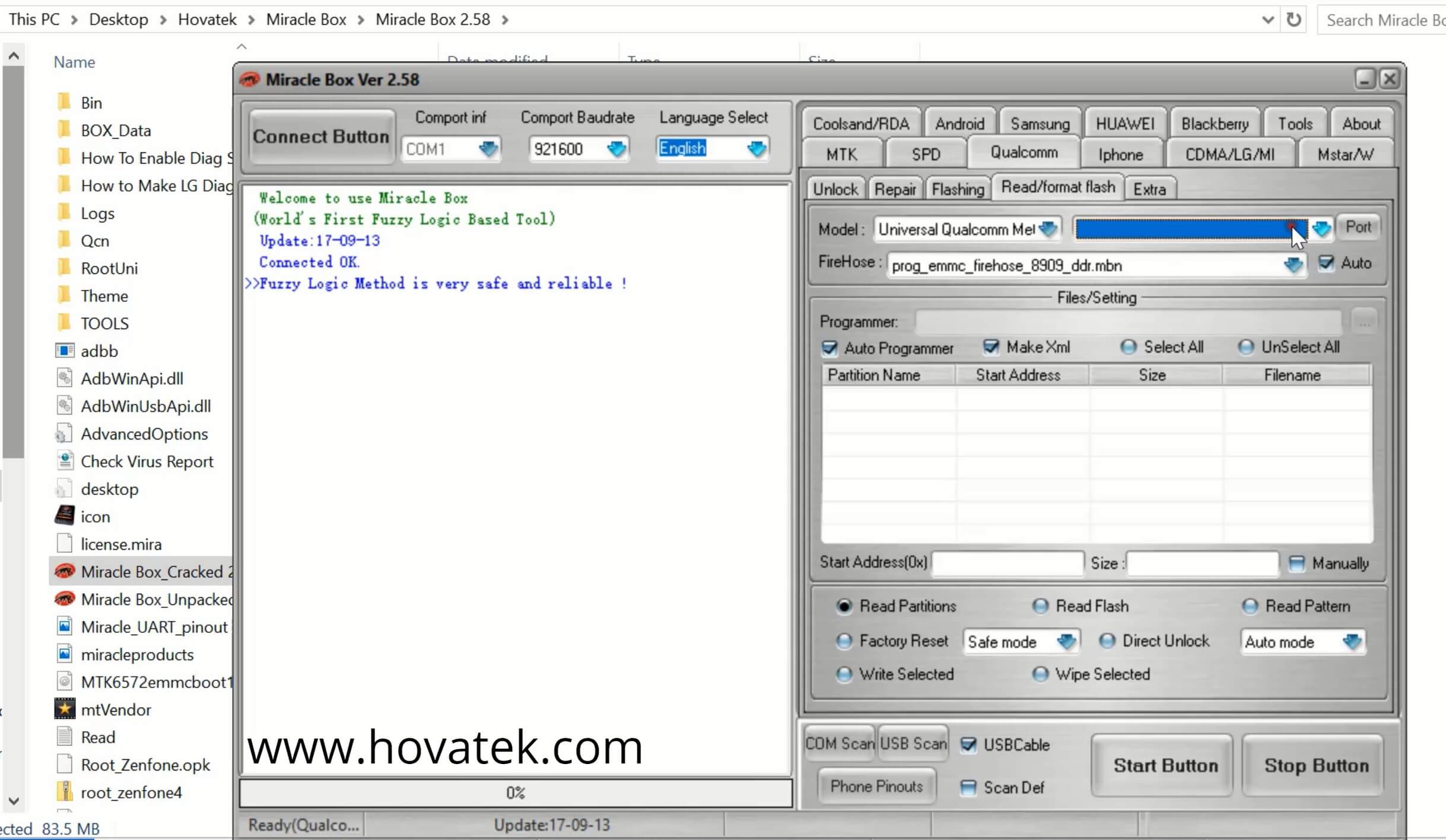

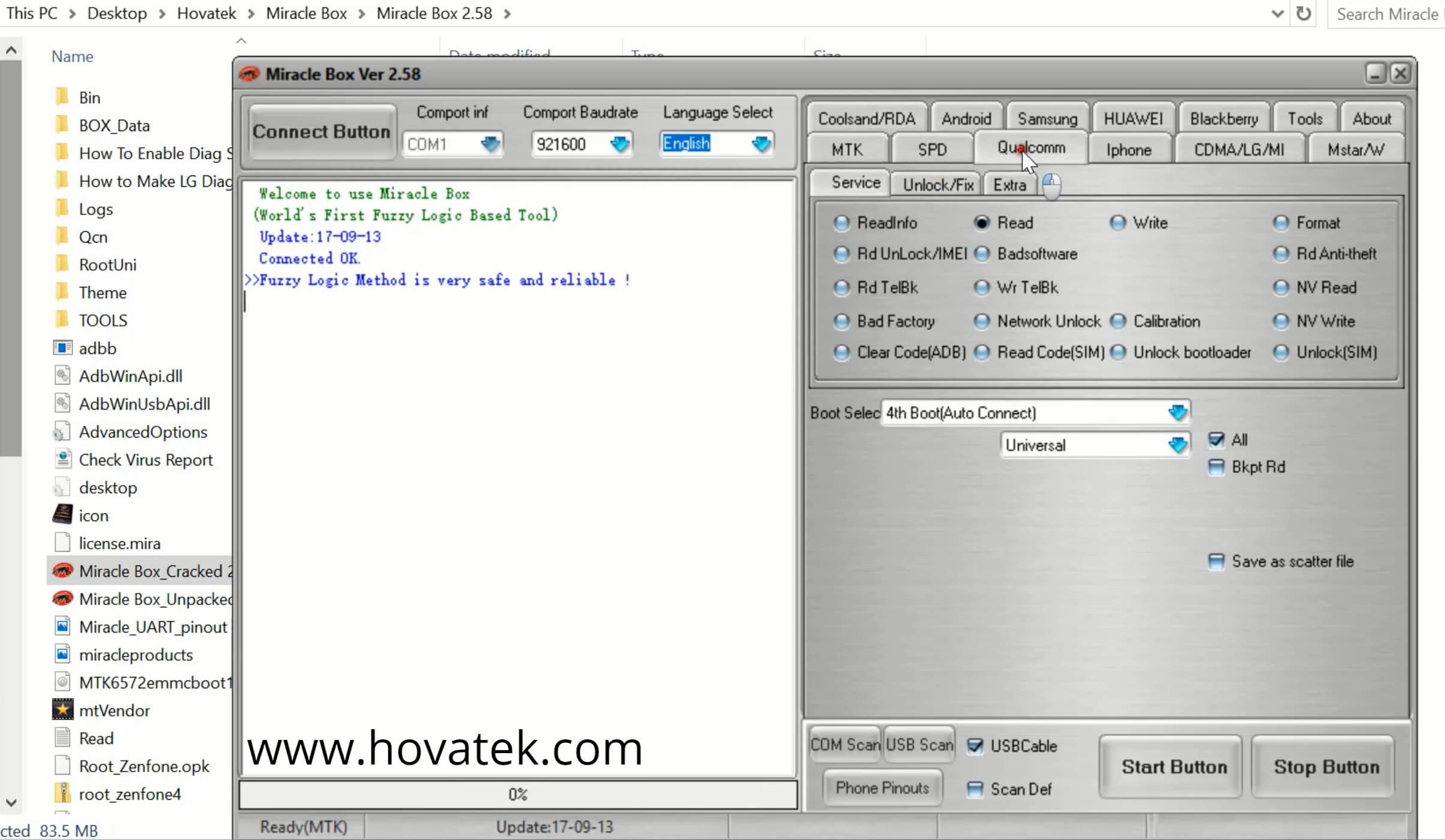

  2. Click the Qualcomm tab
    [Image: How-to-use-Miracle-Box-to-backup-or-read...are-2.webp]
  3. Click the Read/Format Flash tab
    [Image: How-to-use-Miracle-Box-to-backup-or-read...are-3.webp]
  4. You'll notice that the Port is empty
    [Image: How-to-use-Miracle-Box-to-backup-or-read...are-4.webp]

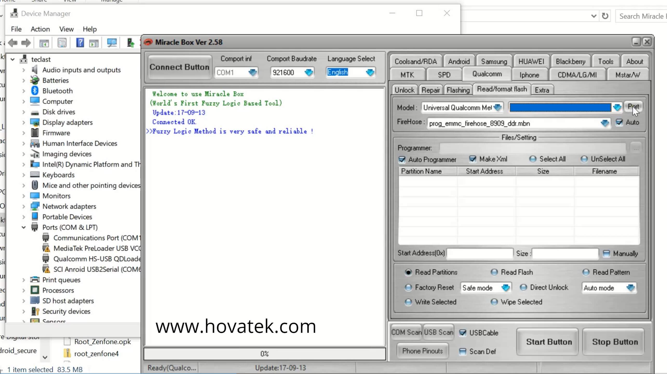

  5. Press the Windows button, search for Device Manager and launch it
    [Image: How-to-use-Miracle-Box-to-backup-or-read...are-5.webp]
  6. Once in device manager, boot the phone into Emergency Download Mode (EDL) then connect to the PC via a USB cord
    [Image: How-to-use-Miracle-Box-to-backup-or-read...are-6.webp]
  7. The phone should be detected as Qualcomm HS-USB QDLoader 9008
    [Image: How-to-use-Miracle-Box-to-backup-or-read...are-7.webp]
  8. Go back to Miracle Box and click Port
    [Image: How-to-use-Miracle-Box-to-backup-or-read...are-8.webp]
  9. The device should be detected under the Port section
    [Image: How-to-use-Miracle-Box-to-backup-or-read...are-9.webp]

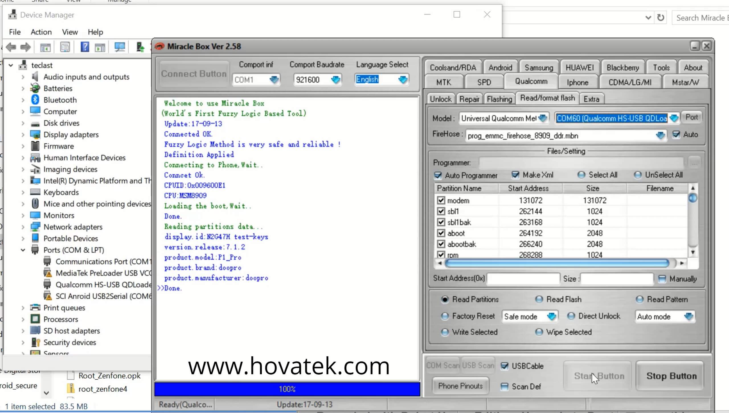

  10. Leave Read Partitions ticked then click the Start Button
    [Image: How-to-use-Miracle-Box-to-backup-or-read...re-10.webp]
  11. The phone's partitions should be displayed.
    [Image: How-to-use-Miracle-Box-to-backup-or-read...re-11.webp]

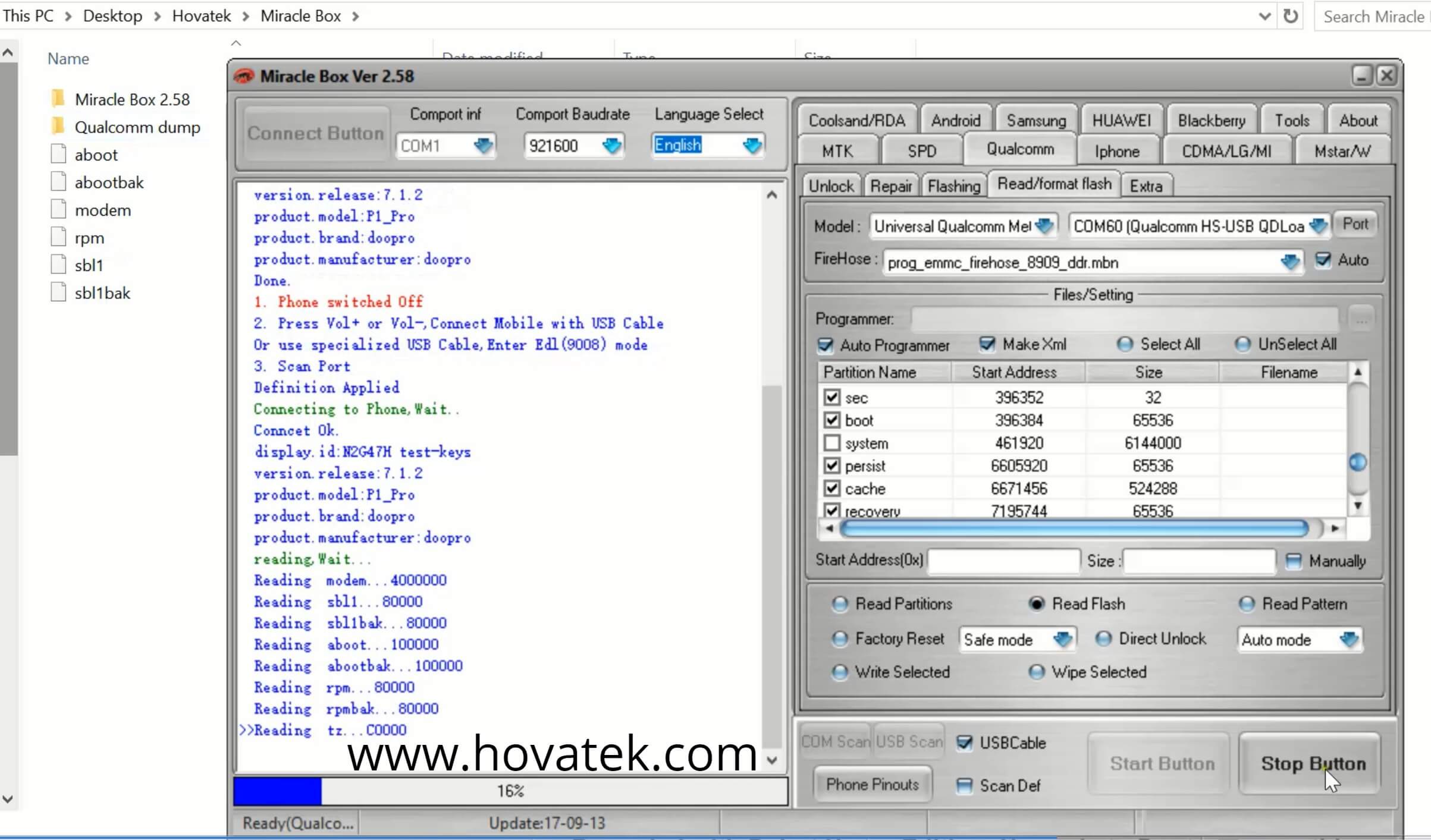

  12. Tick Read Flash
    [Image: How-to-use-Miracle-Box-to-backup-or-read...re-12.webp]
  13. Untick any partition you do not wish to backup (ticked partitions will be backed up)
    [Image: How-to-use-Miracle-Box-to-backup-or-read...re-13.webp]
  14. Click the Start Button (still with the phone connected to the PC)
    [Image: How-to-use-Miracle-Box-to-backup-or-read...re-14.webp]
  15. Miracle Box should display the phone's info
    [Image: How-to-use-Miracle-Box-to-backup-or-read...re-15.webp]
  16. In the Window that pops up, select the location you wish to save the Qualcomm ROM dump to then click OK
    [Image: How-to-use-Miracle-Box-to-backup-or-read...re-16.webp]
  17. Miracle Box should begin dumping the phone's firmware
    [Image: How-to-use-Miracle-Box-to-backup-or-read...re-17.webp]
  18. You'll get a Done message once the backup is complete
    [Image: How-to-use-Miracle-Box-to-backup-or-read...re-18.webp]

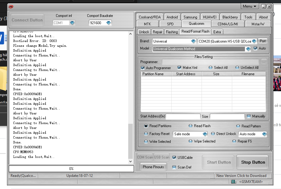

Hi, i tried backing up my device with this method....
i keep getting this error...
bootload error ID: 0003
i have installed the drivers correctly, i don't know else to do.
12-03-2019, 10:48 AM
(12-03-2019, 03:11 AM)Kingfeargod Hi, i tried backing up my device with this method....
create a new thread for your device issue so we'll focus on this
