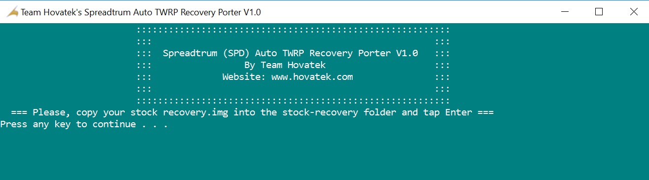

Sequel to the Mediatek auto Philz recovery porter, we're  releasing this version for Spreadtrum Android users to easily port TWRP recovery as well.
[Image: SPD-Auto-TWRP-recovery-porter-by-Team-Hovatek.jpg]

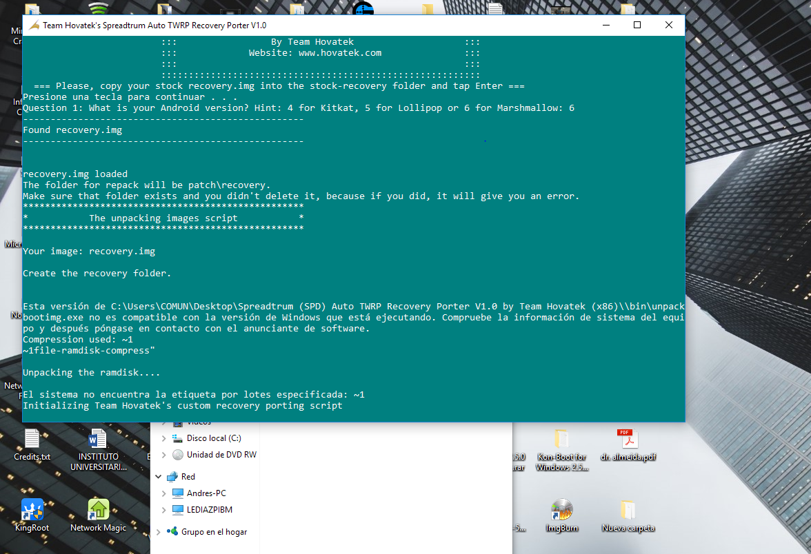

  1. Extract the SPD Auto TWRP recovery porter zip
  2. Copy the stock recovery.img into the stock-recovery folder
  3. Double-click SPD Auto TWRP Recovery Porter.exe
  4. Tap Enter to confirm that you've copied your stock recovery.img into the stock-recovery folder
  5. Enter the option for your Android version (4 for Kitkat, 5 for Lollipop, 6 for Marshmallow & 7 for Nougat) and tap Enter
  6. Wait while our tool ports the TWRP recovery
  7. You'll find your ported TWRP recovery in the output folder.
  8. Flash the recovery image to your device (you can use fastboot or rashr / flashify if rooted)
