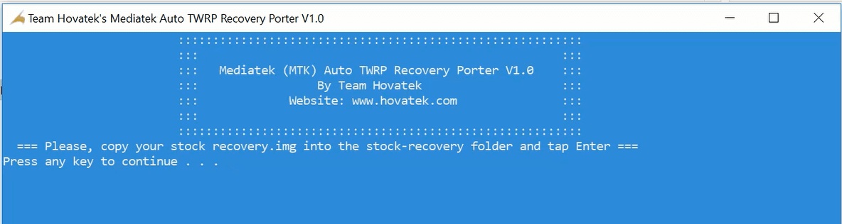

Sequel to our Mediatek auto Philz recovery porter and Spreadtrum auto TWRP recovery porter, we've created this tool to make it very easy to port TWRP recovery for your Mediatek Android device.
[Image: Mediatek-Auto-TWRP-recovery-porter.png]

  1. Extract the MTK Auto TWRP recovery porter compressed file
  2. Copy the stock recovery.img into the stock-recovery folder; if you have recovery-sign.img then ensure to rename it to recovery.img
  3. Double-click Auto TWRP Recovery Porter.exe
  4. Tap Enter to confirm that you've copied your stock recovery.img into the stock-recovery folder
  5. Enter the option for your Android version (5 for Lollipop, 6 for Marshmallow, 7 for Nougat, 8 and 8.1 for Oreo & 8.1g for Oreo-Go) and tap Enter
  6. Wait while our tool ports the TWRP recovery
  7. You'll find your ported TWRP recovery in the output folder.
