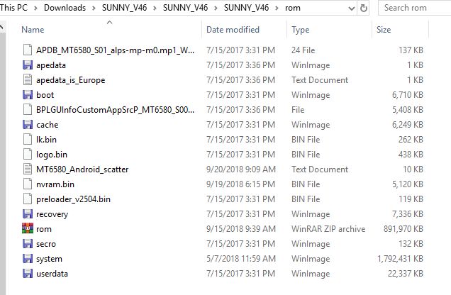

(07-07-2018, 11:28 PM)hovatek If you run into null IMEI on your Mediatek (MTK) Android device then it might not be able to make or receive phone calls. There are several other methods to fix Null IMEI on Mediatek devices but this guide will focus on fixing null IMEI by restoring / flashing nvram.bin & nvdata.img.
I can't find any nvdata.img in my original wiko sunny v46 ROM how can i reset the phone's nvdata.img

20-09-2018, 01:20 PM
(20-09-2018, 08:40 AM)DesCoene I can't find any nvdata.img in my original wiko sunny v46 ROM how can i reset the phone's nvdata.img
thats how you differentiate factory / original firmware from firmware dumps
factory firmware doesn't include nvram / nvdata file but includes DB files for fixing imei
stock rom dumps dont have DB files but might contain nvram file.
if you need nvram / nvdata then you need to dump it from a working device
This post was last modified: 20-09-2018, 01:21 PM by X3non.

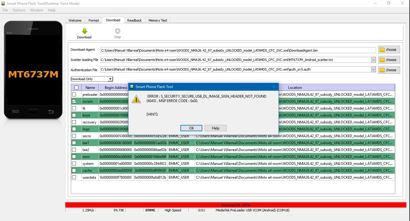

04-01-2019, 11:24 PM
What if i got this error when flashing the nvram? Do someone know how to solve it? please
05-01-2019, 11:15 AM
(04-01-2019, 11:24 PM)manuel11 What if i got this error when flashing the nvram? Do someone know how to solve it? please
check for and try the fixes listed at https://www.hovatek.com/forum/thread-439.html
