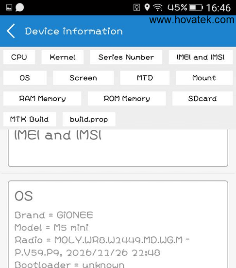

If you are having network issues on your android device and you're certain it isn't hardware related, then the first thing to do would be to check if the IMEI and baseband on your android device are still valid. The tutorial below shows how to check this infomation.
Steps on how to check if an Android phone has a valid baseband and IMEI
Checking IMEI
  • Simply dial *#06#
  • You can verify the IMEI with the IMEI beneath the battery of your phone or the sticker on the carton of your phone
Checking Baseband
  • On your phone, navigate to Settings > About phone > Baseband
  • If the baseband is UNKNOWN, then the baseband isn't valid and would require fixing.
  • If you have an MTK device and dont find baseband under Settings, then download "Tool Hero" @ https://play.google.com/store/apps/detai...lite&hl=en
  • Launch the app
  • Click on "device information"
  • Scroll down the list till you get to the section labelled as "OS"
  • You should find "Radio" on the list. The info from Radio is the same as baseband
    [Image: How-to-check-if-phone-has-a-valid-baseband-and-IMEI.png]
How to fix Invalid Baseband and IMEI
  • Tool Hero apk is known to work only on mediatek devices
