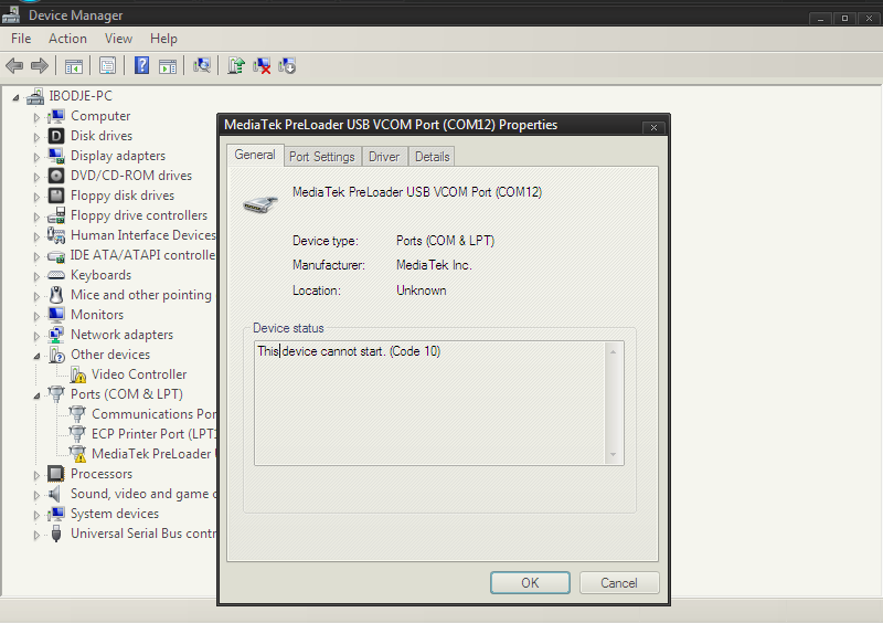

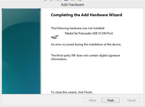

  12. Click Finish. Ignore the Code 10 error. You're getting it because you have installed an unsigned driver

  13. Your drivers should now appear on the list. Ignore the yellow warning triangle. You're getting it because you have installed an unsigned driver

  • If you get the code 10 error or yellow warning triangle in the device manager after the installation, simply ignore it and proceed with flashing. You're only getting that error because the driver is not digitally signed

  • You only need to disable driver signature verification when installing unsigned drivers

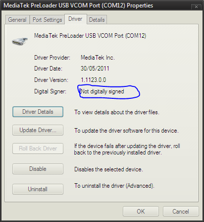

PHONE STILL NOT RECOGNISED AFTER PROCESS. . . .I THINK IT HAS SOMETHING TO DO WITH THE ERROR CODES IN PROPERTIES@attachment. .

(10-09-2014, 09:26 PM)Slimzzy PHONE STILL NOT RECOGNISED AFTER PROCESS. . . .I THINK IT HAS SOMETHING TO DO WITH THE ERROR CODES IN PROPERTIES@attachment. .
if you'd downloaded it from our link then that shouldn't be a problem. it worked fine for others. you still haven't mentioned the error code

LUK AT THE IMAGE IN MA POST. .I TOOK A SCREENSHOT TO EXPLAIN BETTER.
