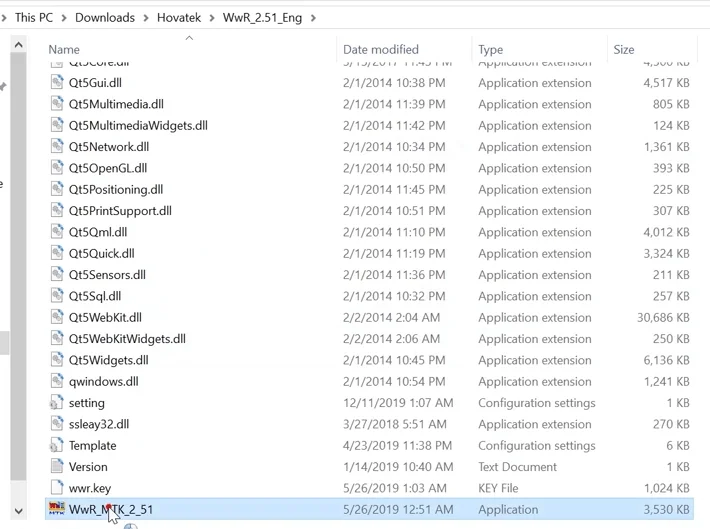

  1. Launch WWR
    [Image: how-to-use-wwr-v2.51-and-sp-flash-tool-t...are-1.webp]

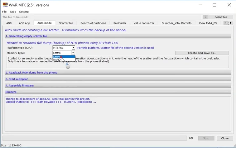

  6. Choose your device's memory type
    [Image: how-to-use-wwr-v2.51-and-sp-flash-tool-t...are-6.webp]

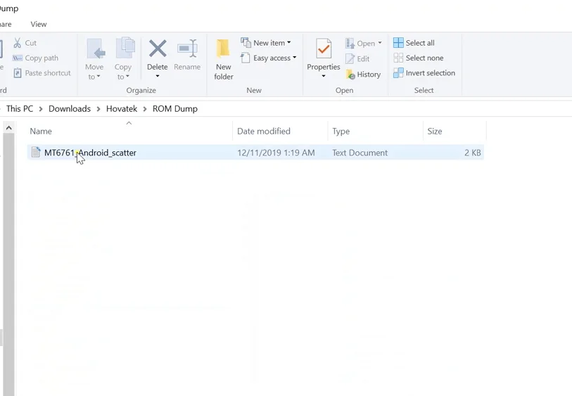

  9. You should see the scatter.txt file
    [Image: how-to-use-wwr-v2.51-and-sp-flash-tool-t...are-9.webp]

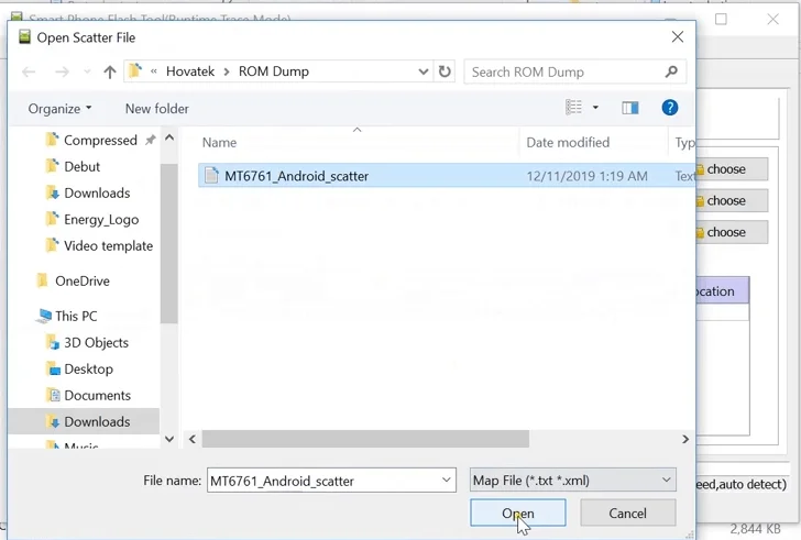

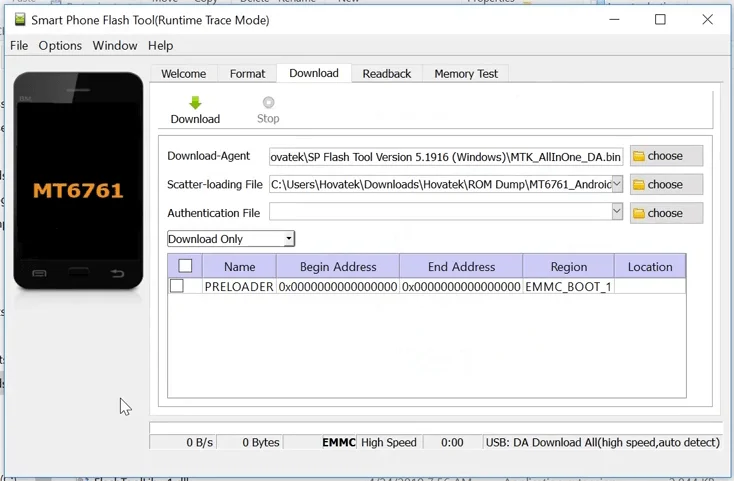

  12. Click Choose in front of Scatter-loading file
    [Image: how-to-use-wwr-v2.51-and-sp-flash-tool-t...re-12.webp]
  13. Select the scatter file from WWR
    [Image: how-to-use-wwr-v2.51-and-sp-flash-tool-t...re-13.webp]

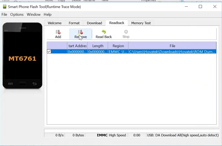

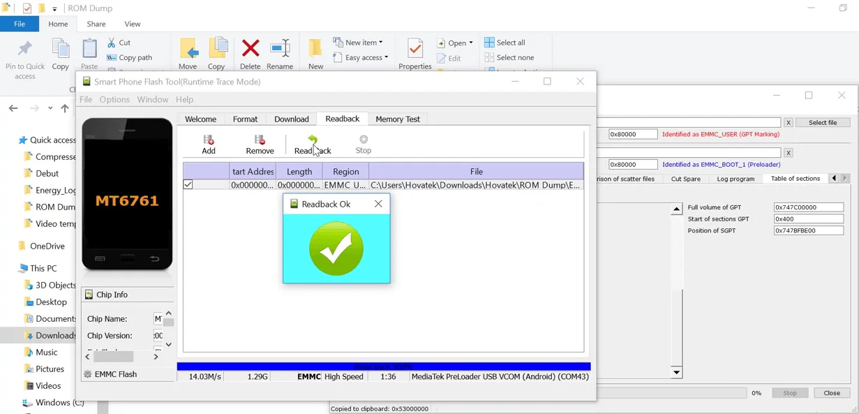

  14. Click Readback
    [Image: how-to-use-wwr-v2.51-and-sp-flash-tool-t...re-14.webp]
  15. Highlight and remove all entries
    [Image: how-to-use-wwr-v2.51-and-sp-flash-tool-t...re-15.webp]

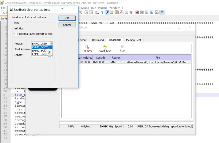

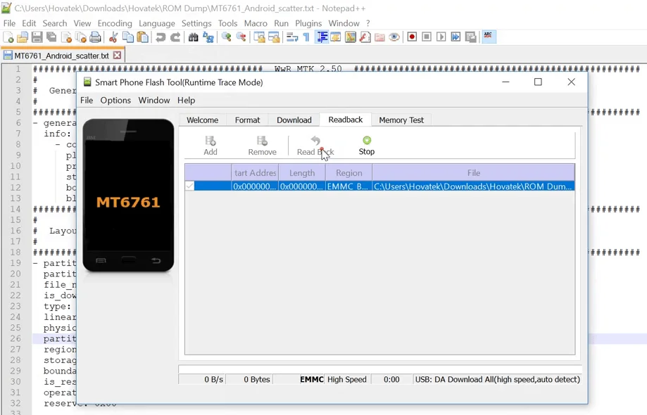

  19. Open the scatter file in Notepad++
    [Image: how-to-use-wwr-v2.51-and-sp-flash-tool-t...re-19.webp]

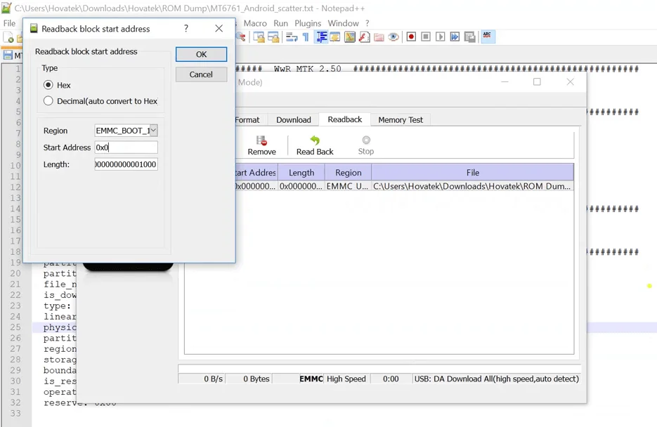

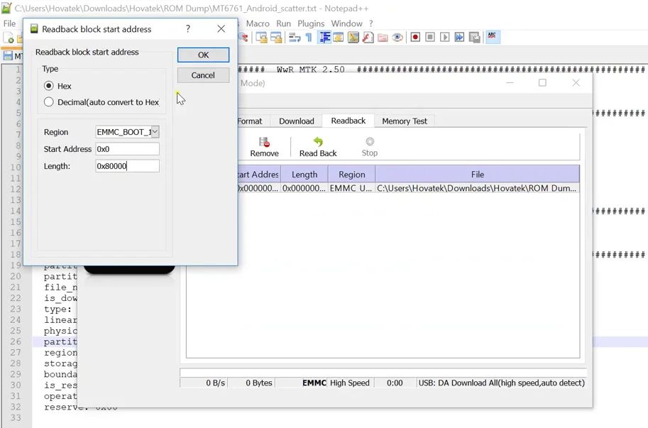

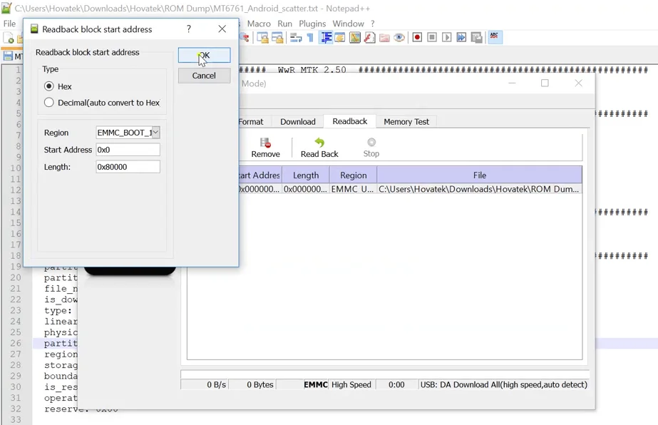

  20. Go back to SP flash tool and change the region to EMMC_BOOT_1
    [Image: how-to-use-wwr-v2.51-and-sp-flash-tool-t...re-20.webp]
  21. Set Start Address to 0x0
    [Image: how-to-use-wwr-v2.51-and-sp-flash-tool-t...re-21.webp]
  22. Copy the partition_size for preloader from the scatter file and paste it under length
    [Image: how-to-use-wwr-v2.51-and-sp-flash-tool-t...re-22.webp]
  23. Click OK
    [Image: how-to-use-wwr-v2.51-and-sp-flash-tool-t...re-23.webp]

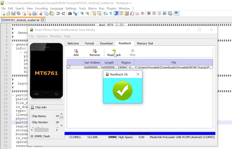

  24. Click readback then connect the device while powered off
    [Image: how-to-use-wwr-v2.51-and-sp-flash-tool-t...re-24.webp]
  25. You should get success once the readback is completed
    [Image: how-to-use-wwr-v2.51-and-sp-flash-tool-t...re-25.webp]

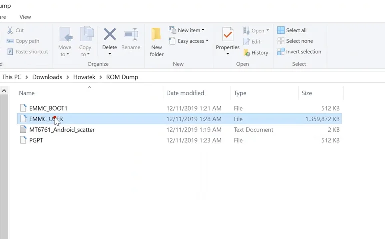

  26. Confirm that you see the file in the destination folder
    [Image: how-to-use-wwr-v2.51-and-sp-flash-tool-t...re-26.webp]

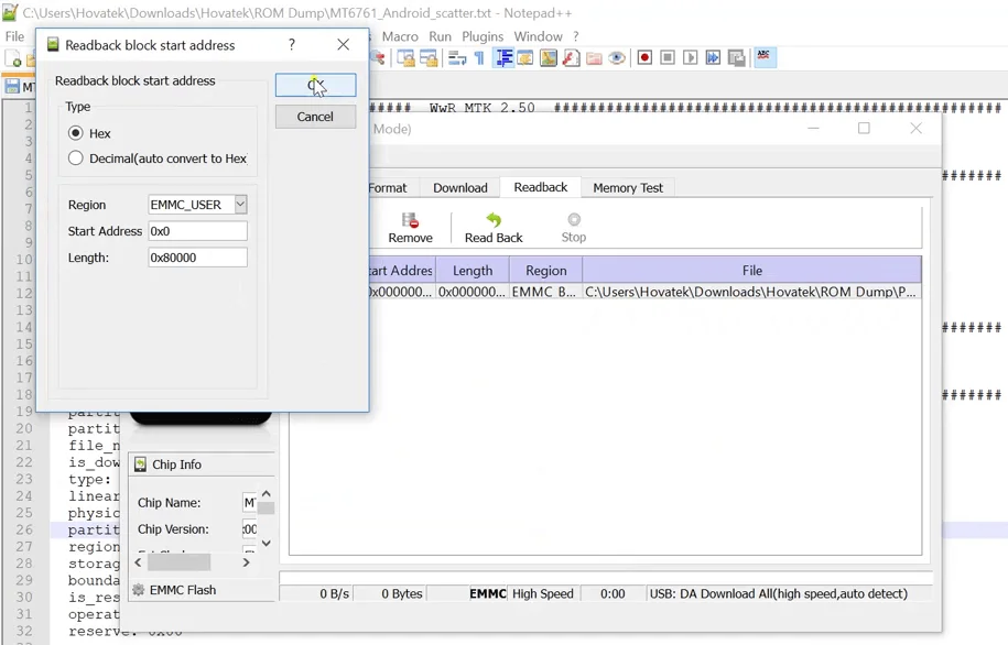

  27. Repeat the process with the same values except region will be EMMC_USER (this will be pgpt)
    [Image: how-to-use-wwr-v2.51-and-sp-flash-tool-t...re-27.webp]
  28. You should get a success message after readback
    [Image: how-to-use-wwr-v2.51-and-sp-flash-tool-t...re-28.webp]

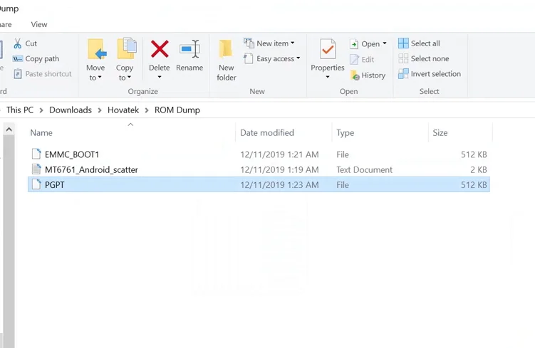

  29. Confirm that both files are in the same folder
    [Image: how-to-use-wwr-v2.51-and-sp-flash-tool-t...re-29.webp]

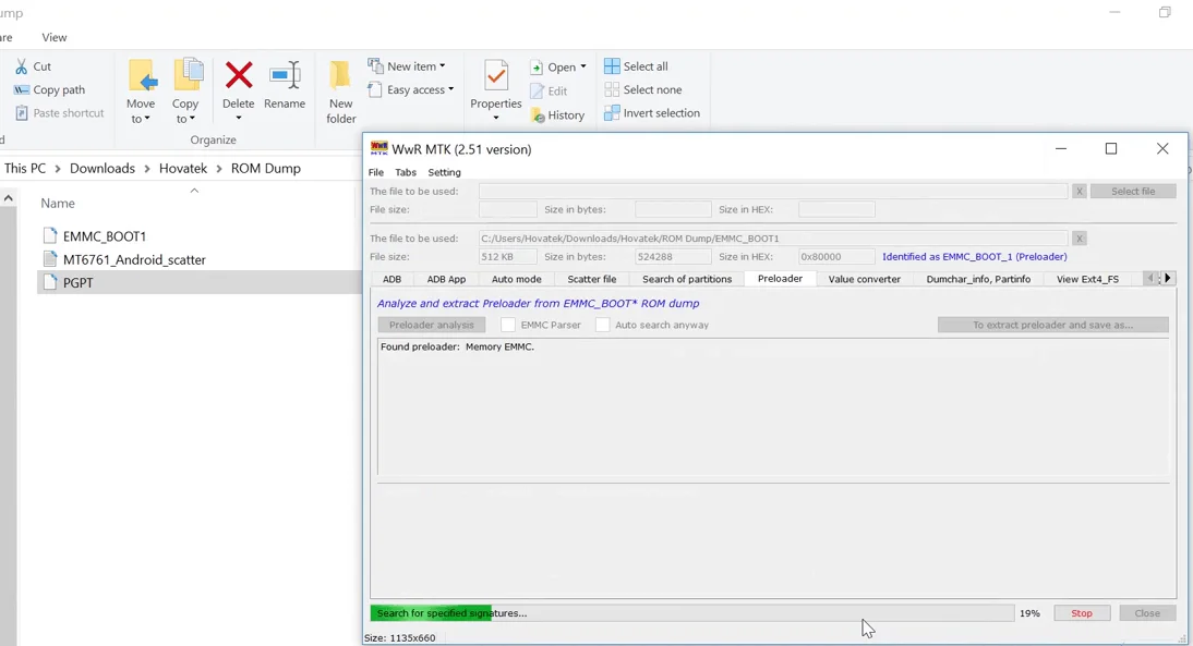

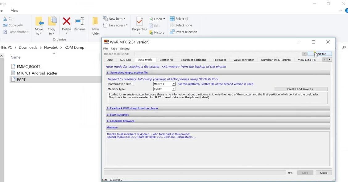

  30. Go back the WWR and click Select file
    [Image: how-to-use-wwr-v2.51-and-sp-flash-tool-t...re-30.webp]
  31. Choose the first dump (raw preloader)
    [Image: how-to-use-wwr-v2.51-and-sp-flash-tool-t...re-31.webp]
  32. Wait while it loads
    [Image: how-to-use-wwr-v2.51-and-sp-flash-tool-t...re-32.webp]

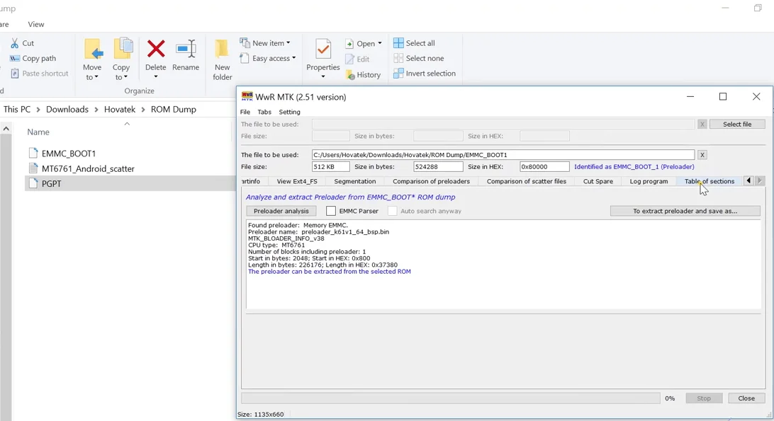

  33. You may click To extract preloader and save as.. if you wish to get the final preloader
    [Image: how-to-use-wwr-v2.51-and-sp-flash-tool-t...re-33.webp]

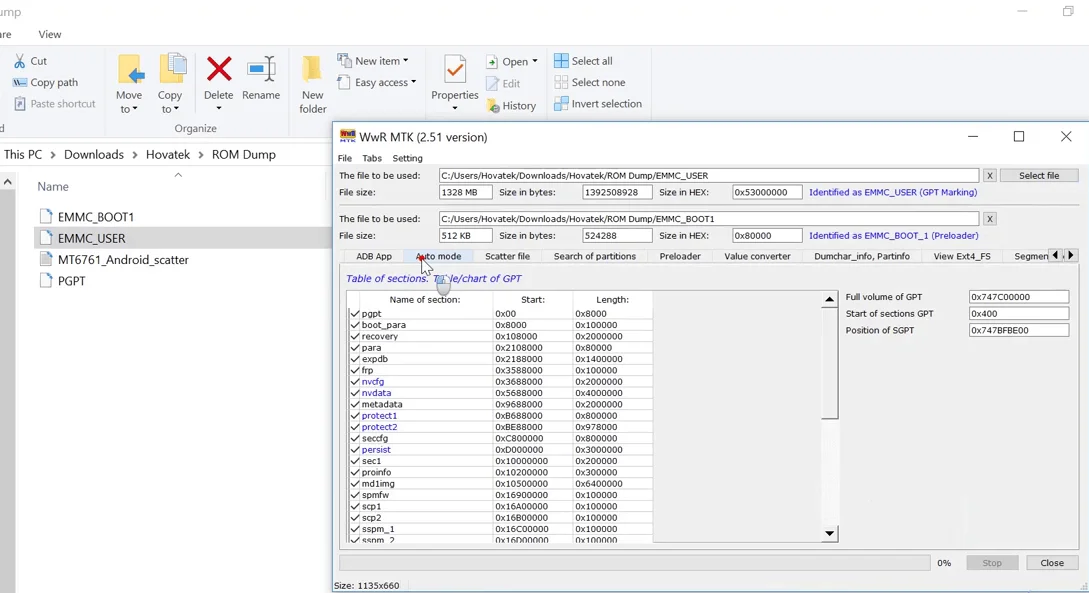

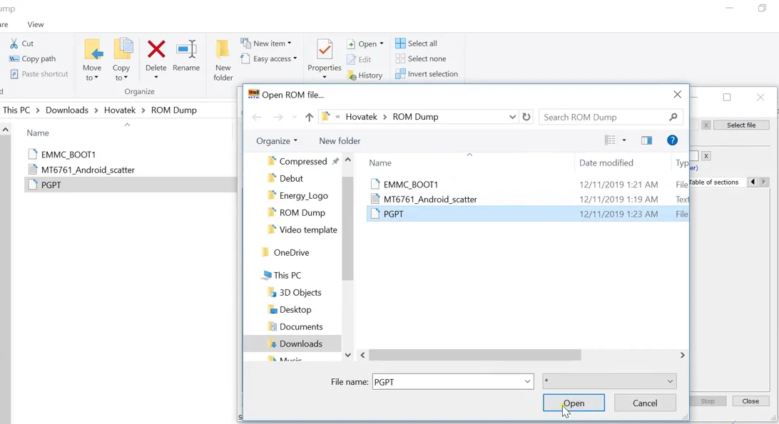

  34. Click Select file and choose the second dump (pgpt)
    [Image: how-to-use-wwr-v2.51-and-sp-flash-tool-t...re-34.webp]
  35. Scroll to the table of sections tab to view all partitions
    [Image: how-to-use-wwr-v2.51-and-sp-flash-tool-t...re-35.webp]

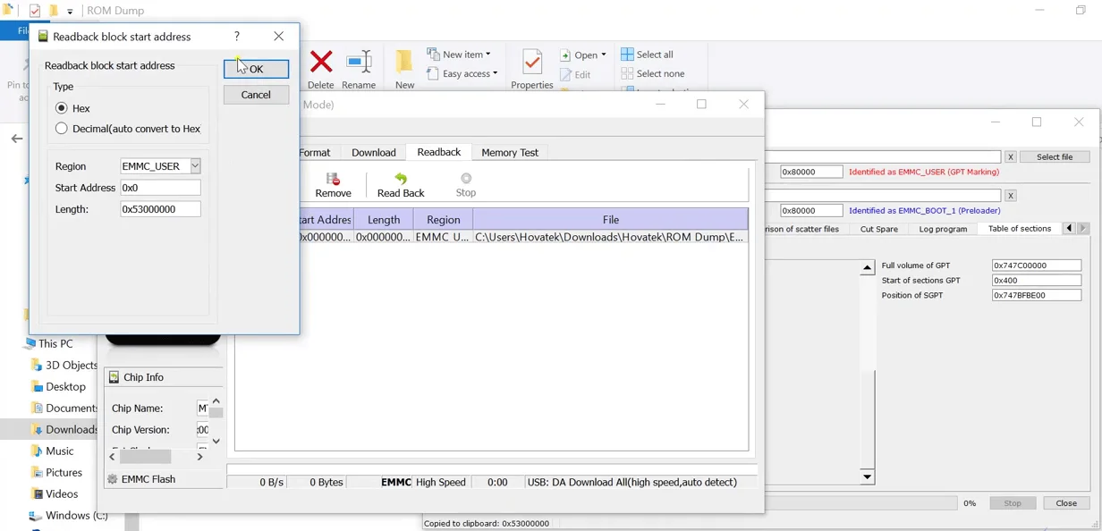

  36. For a full dump, your length value would be the Full volume of gpt on the right
    [Image: how-to-use-wwr-v2.51-and-sp-flash-tool-t...re-36.webp]
  37. To exclude certain partitions, your length value would the the start address of the partition below the last one you wish to dump e.g right-clicking and copying the start address for system will stop the dump at vbmeta and exclude system downwards
    [Image: how-to-use-wwr-v2.51-and-sp-flash-tool-t...re-37.webp]
  38. Do a dump with region and EMMC-USER, start address as 0x0 and your length value then click OK
    [Image: how-to-use-wwr-v2.51-and-sp-flash-tool-t...re-38.webp]
  39. You should get a success message after readback
    [Image: how-to-use-wwr-v2.51-and-sp-flash-tool-t...re-39.webp]

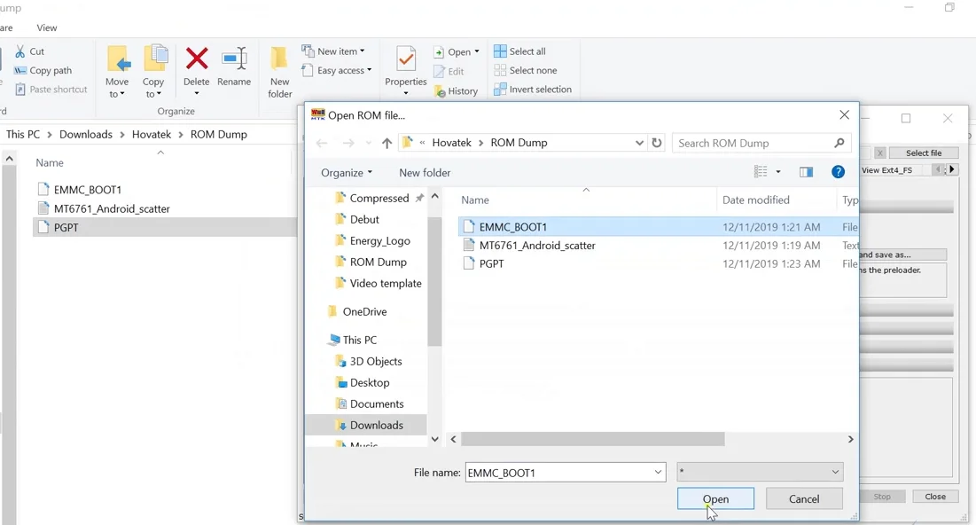

  41. Click Select file in WWR
    [Image: how-to-use-wwr-v2.51-and-sp-flash-tool-t...re-41.webp]
  42. Select the full dump and click Open
    [Image: how-to-use-wwr-v2.51-and-sp-flash-tool-t...re-42.webp]

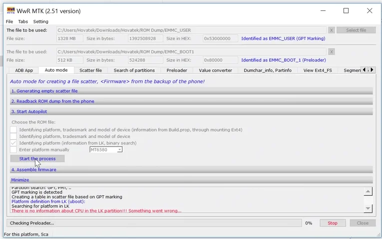

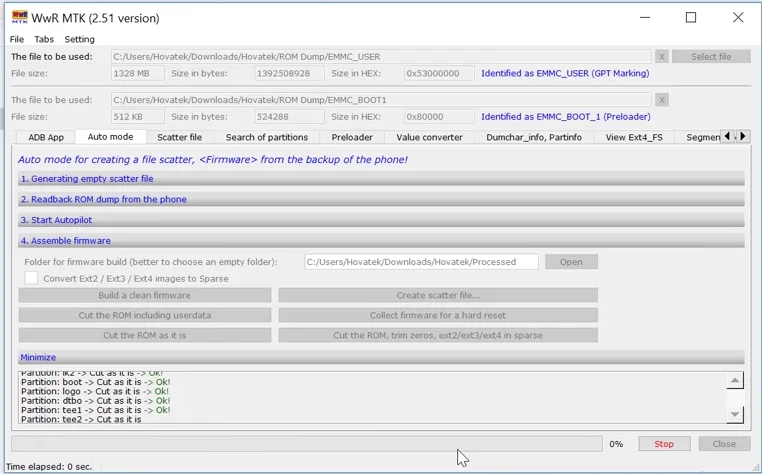

  43. Click Auto mode
    [Image: how-to-use-wwr-v2.51-and-sp-flash-tool-t...re-43.webp]
  44. Click Start autopilot
    [Image: how-to-use-wwr-v2.51-and-sp-flash-tool-t...re-44.webp]

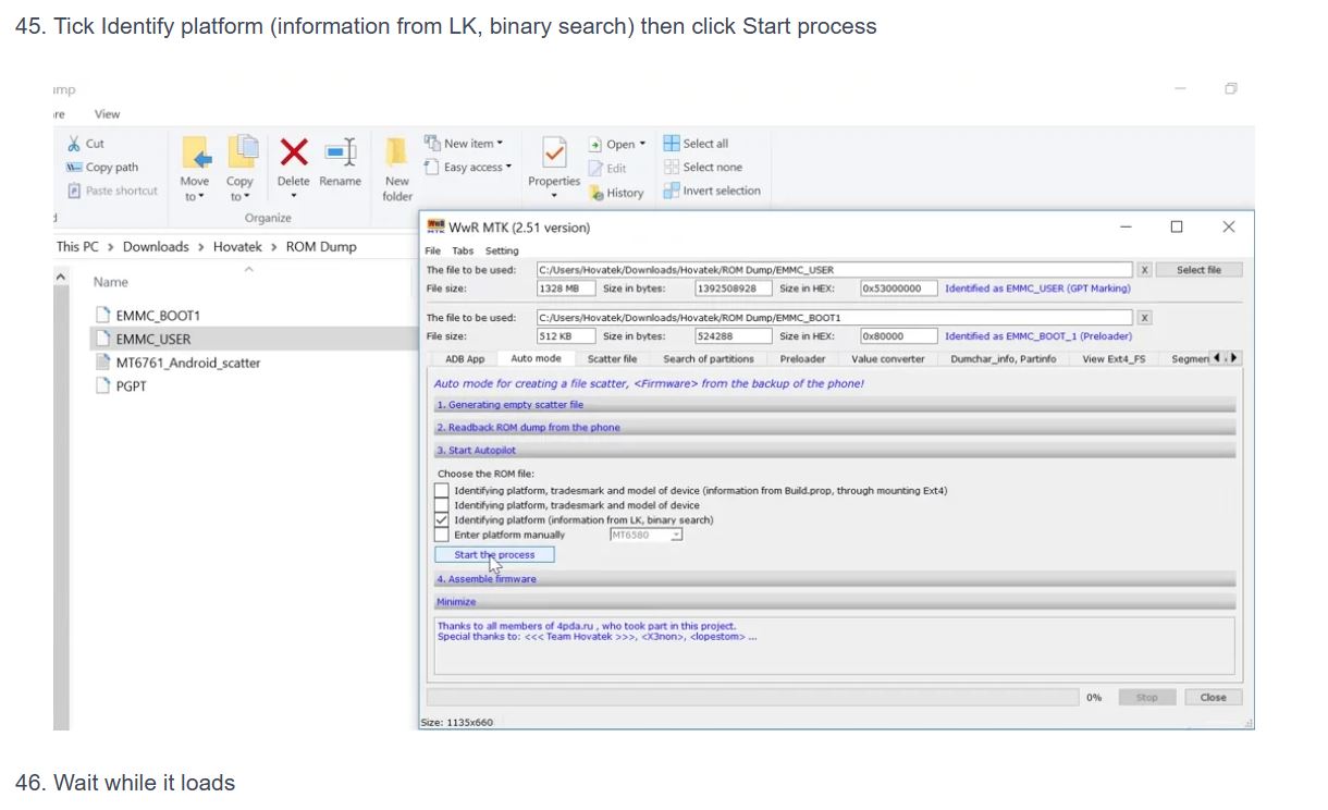

  45. Tick Identify platform (information from LK, binary search) then click Start process
    [Image: how-to-use-wwr-v2.51-and-sp-flash-tool-t...re-45.webp]

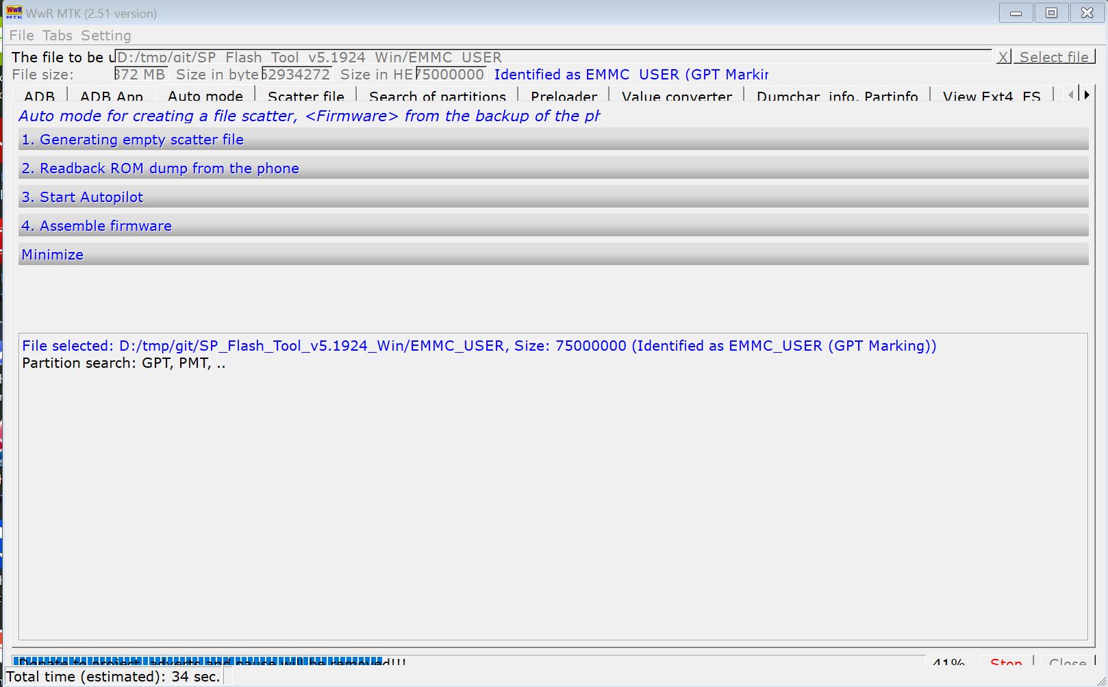

  46. Wait while it loads
    [Image: how-to-use-wwr-v2.51-and-sp-flash-tool-t...re-46.webp]
  47. Ignore the There is no information about CPU in the LK partition error
    [Image: how-to-use-wwr-v2.51-and-sp-flash-tool-t...re-47.webp]

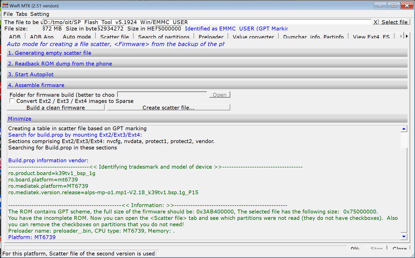

  48. If you're uncertain of what to click then choose Cut the ROM as it is
    [Image: how-to-use-wwr-v2.51-and-sp-flash-tool-t...re-48.webp]

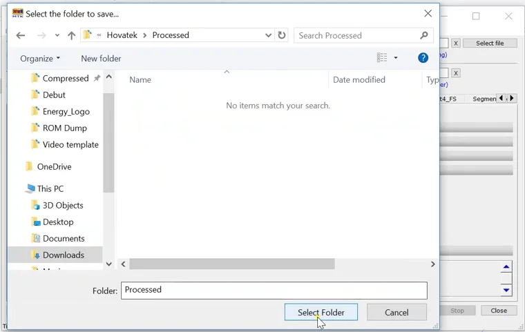

  49. Choose the destination folder for the cut ROM
    [Image: how-to-use-wwr-v2.51-and-sp-flash-tool-t...re-49.webp]
  50. Wait while the ROM gets cut
    [Image: how-to-use-wwr-v2.51-and-sp-flash-tool-t...re-50.webp]
  51. Once done, you should find the dump in the folder you chose
    [Image: how-to-use-wwr-v2.51-and-sp-flash-tool-t...re-51.webp]
