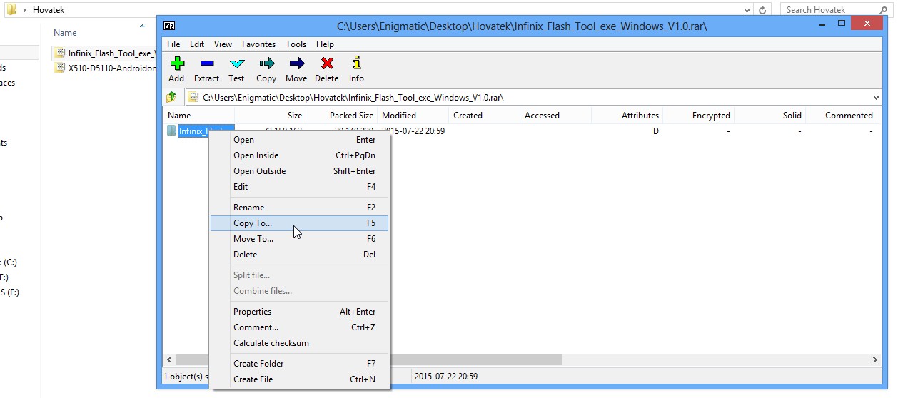

  2. Extract the Infinix Flash tool and the stock ROM you wish to flash
    [Image: how-to-use-infinix-flash-tool-1.webp]

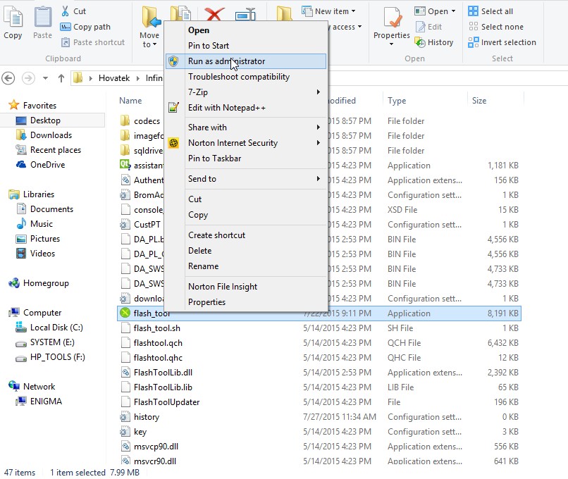

  3. Run Infinix Flash tool as Administrator
    [Image: how-to-use-infinix-flash-tool-2.webp]

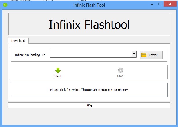

  4. You should now see the tool's Dashboard
    [Image: how-to-use-infinix-flash-tool-3.webp]

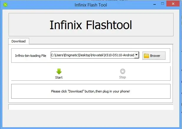

  5. Click Brower (with a folder icon)
    [Image: how-to-use-infinix-flash-tool-4.webp]

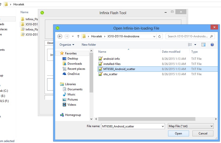

  6. In the window that pops up, navigate to the stock ROM folder, select the scatter file and click Open
    [Image: how-to-use-infinix-flash-tool-5.webp]
  7. The file path should now appear in front of the Infinix-bin-loading File
    [Image: how-to-use-infinix-flash-tool-5b.webp]

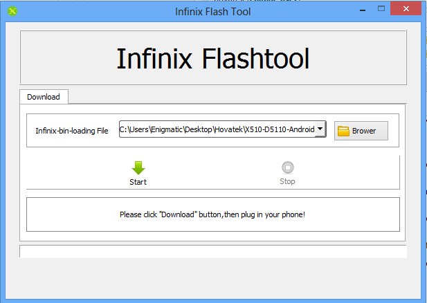

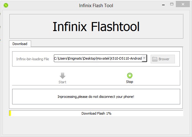

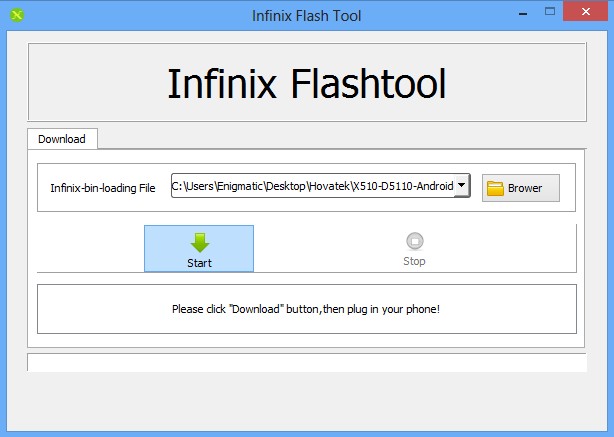

  8. Click Start
    [Image: how-to-use-infinix-flash-tool-6.webp]

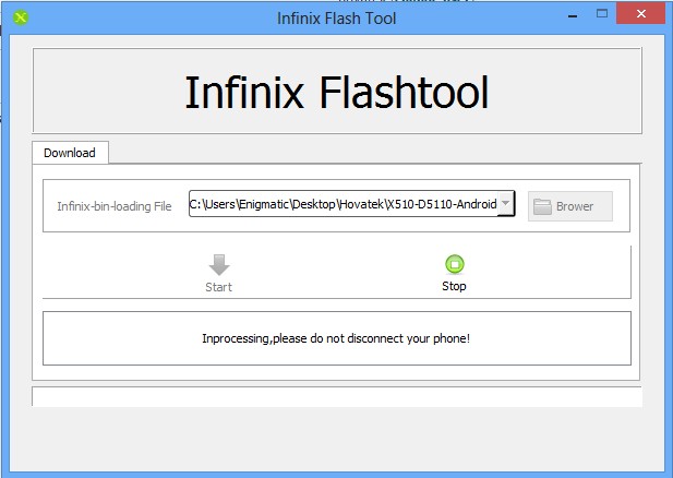

  9. Start should now be greyed out and Stop green in colour
    [Image: how-to-use-infinix-flash-tool-7.webp]
  10. Switch off the phone and connect it to the PC via a USB cord (with battery inside); flashing should begin

    [Image: how-to-use-infinix-flash-tool-8.webp]

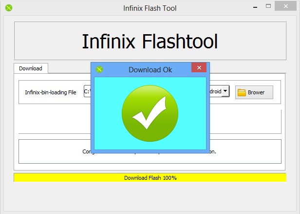

  11. You should get a green OK prompt once flashing is completed
    [Image: how-to-use-infinix-flash-tool-9.webp]
