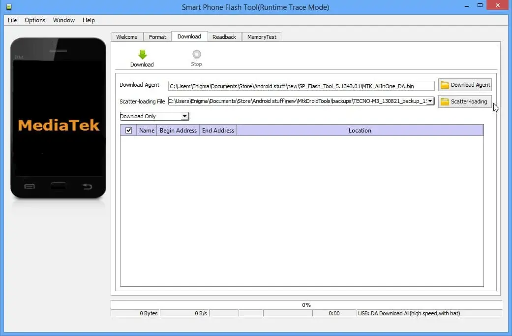

  3. Click on Scatter-loading on the right
    [Image: how-to-use-sp-flash-tool-2.webp]
  4. In the window that pops up, select the scatter file from the firmware then click Open (scatter file is a text file with the word "scatter" in its name )
    [Image: how-to-use-sp-flash-tool-3.webp]
  5. A list with ticked boxes should appear in SP flash tool (preloader, boot, recovery etc)

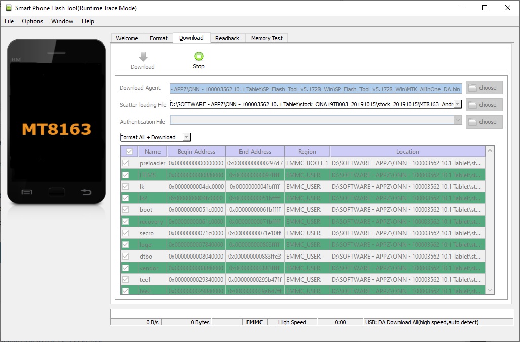

  7. Untick the box in front of any item you do not wish to flash
    [Image: how-to-use-sp-flash-tool-4.webp]
  8. To manually load an item that doesn't automatically get ticked after loading the scatter file, tick the box in front of that item then double-click its Location and select the corresponding file in the window that pops up

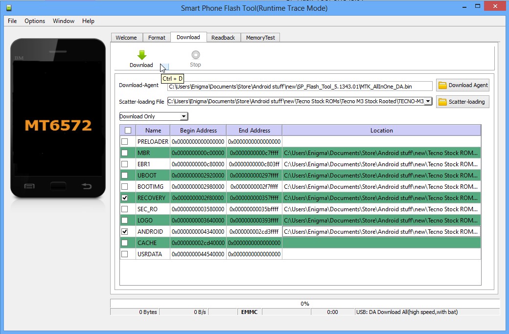

  9. Once the file(s) you wish to flash is (are) ticked, click Download (with an arrow above it). Download Only is the safest flash option. You could use Firmware Upgrade in some instances (different partition layout between firmware and device) but avoid Format as much as you can.
    [Image: how-to-use-sp-flash-tool-5.webp]
  10. Stop should now be prominent while other options should be greyed out
  11. Connect the switched-off device to the PC via a USB cord without holding any button
  12. A progress bar should start running

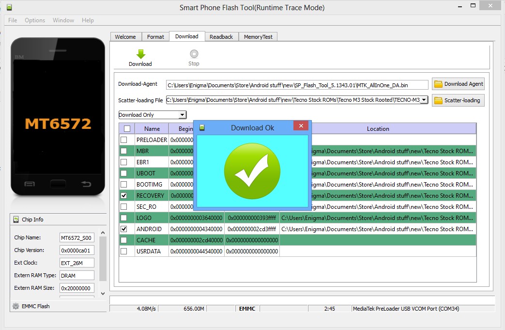

    [Image: how-to-use-sp-flash-tool-6.webp]
  13. Wait till you get a Success message (green circle with OK), do not interrupt before then
    [Image: how-to-use-sp-flash-tool-7.webp]
  14. Disconnect the device and power up

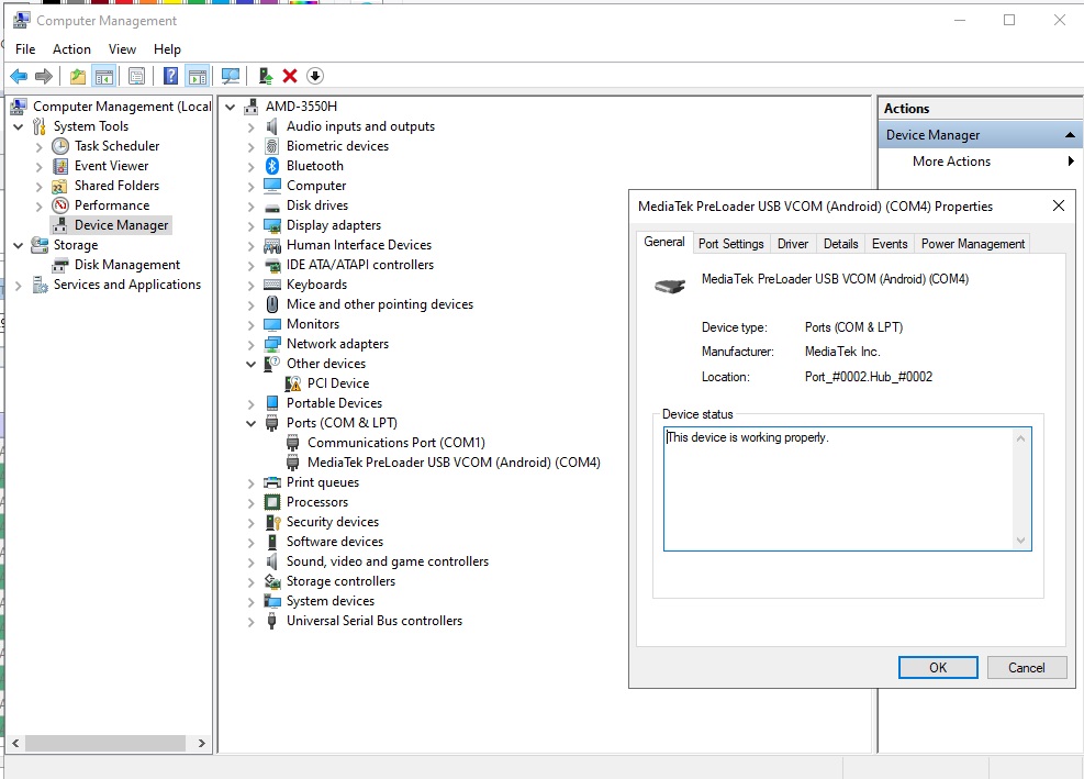

Now, You'll also need the VCOM drivers so just check the description of this tutorial, You should get the download link or You go to our website [Alarm Clock] Search for how to use SP Flash tool. You should find the written version of this video tutorial and You can get the links to all these software You'll be needing. Of course You'll need the files You'll be flashing which is my stock backup In this case I'm using an old OS Tecno M3. Now, I also have my Tecno M3 here with me and I've bricked this phone just for the purpose of this tutorial so I'll be flashing the files to this my Tecno M3 here and I have my USB cord right here so these are the things you'll basically need for this tutorial.

So, we have the drivers ready. Now, the first thing You would want to do before You talk about using SP Flash tool at all is to install the drivers. Now, for SP Flash tool, You don't need an internet connection so don't worry about an internet  connection. Everything can be done offline. Installing the drivers, the first thing You'll want to do is open Device Manager so I'll search for Device Manager here Alright! Here's my Device Manager.
Now, what we're basically going to be doing here is we're going to be manually installing this VCOM driver. There's an automatic method of installing where You use an installer but You're going to be manually installing it just in case You don't have access to the automatic installer. So, the first thing You'll want to do here is to just click anything, just click any item on the list, any item at all on the list. Once You click an item, You go to Action, then Add Legacy Hardware. From here, a Wizard will popup. From here, You click Next. Now, before You proceed at this point (lest I forget), If You're using a Windows 8 (and above) PC. Its very important You disable driver signature verification.
Now, there's a video on that, I created a (YouTube) video on that. You can also check our website for how to disable Windows driver signature verification because If You don't disable that, You will not be able to install an unsigned driver. Now, this driver I'm trying to install is unsigned. It doesn't mean its not going to work It  doesn't mean its dangerous or something, its just not signed. You understand? So basically, Windows 8 (and 10) just believes that any unsigned driver must be unsafe so it doesn't allow You to go ahead to install that. So You need to first disable signature verification If You're using Windows 8 before You proceed with this.
Check my list of previously uploaded video tutorials or You go to our website for how to disable signature verification on Your Windows 8 (and 10). So, from here, You click "Install the hardware that I manually select from a list..." then Next You just click Next here. Now, at this point, You click "Have Disk.." Now, here I'm going to chose the driver I wish to install so I just go straight to my Hovatek folder My VCOM drivers. USB VCOM (don't forget), Windows 7. Since I now have Windows 8, Windows 8 & 7 are close as I earlier mentioned so I can use Windows 7. Now, my PC is a 64 bit PC so I just select 64 bit.
Now, for those who don't know how to check if theirs is 32 or 64 bit, quickly just go to My Computer, right-click on it, click on Properties and You'll see Yours PC. Mine is the system type 64 bit, here it is. So that's how you just check it. Right click on My Computer - Properties and that is it. Alright, lets proceed with the installation of the driver So from here, I've loaded the driver I wish to select (let me do that again just in case You've forgotten) Go straight to where the folder is, You select that for your PC (mine is 64 bit). If Yours is 32 bit, select this instead. Mine is 64 bit, I select and then (click) Open and then (click) OK.
Now, this is the warning I earlier mentioned, "This driver is not digitally signed". This is nothing to worry about. You just [Plane Overhead] have to proceed and then You click Next..and Next so we're installing this. [Plane Overhead] Now, this is finished. Now, If (after the installation), that's assuming You disabled the [Plane Overhead] signature verification and You were able to get to this stage, You'll get this "This device cannot start (code 10)". Most people tend to panic at this point. This is really nothing to panic about. Now, the reason why You're getting this code 10 basically is because You installed an unsigned driver.
Now, when You install an unsigned driver in Windows 8 (and 10), Windows tends to assume it might not work. Now, notice my language [Car Horn]. I said it might not work, doesn't mean it will not work. It might not work because its unsigned. So the only reason why You're getting this error is because the driver You've installed is unsigned. That doesn't mean its not going to work and I can guarantee You that its most likely going to work as far as You installed the correct drivers which it is in this case. So despite the fact that I'm getting my device cannot start code 10 error is nothing to worry about.
Its just because the driver is unsigned so I just click Finish. So my driver is installed. Now, to crosscheck if my driver is installed (still under my Device Manager), I scroll down and I see my Mediatek DA USB VCOM Port and my Mediatek Preloader USB VCOM so Yes,  I have it installed. Now, this yellow triangle is related to the code 10 error I earlier mentioned. Its nothing to worry about. Its just because its unsigned, that is all it is. This is for Spreadtrum here but we're basically focusing on the MTK which are these here. So my VCOM drivers are installed and I am good to go.

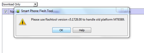

Now, the reason why I'm getting this error is because the version of SP Flash tool I'm using is too low For the kind of backup I have, You understand? So for me to be able to use SP Flash tool, I need to use v5 That's what this is telling me. So basically, I cannot use v3 to flash this phone which I'm using, I have to move to v5. but I still want to show You what version 3 is going to look like so let me just look for another file which v3 should be able to at least list for You even if You're not flashing. I need You to at least see a list.
Tecno D3 should be able to at least have. Alright! this is basically what v3 is going to look like that is if its going to be compatible with Your phone. Its going to be the same thing as us using v5 just take note of where the following things are. Format, Firmware Upgrade, Download Those are just the basic things You need to take note of. I'll explain these things in v5 but its basically the same thing. There's also Read back for you to backup a phone but is beyond the scope of this (guide). There's a (YouTube) video on how to backup a working phone using SP Flash tool
