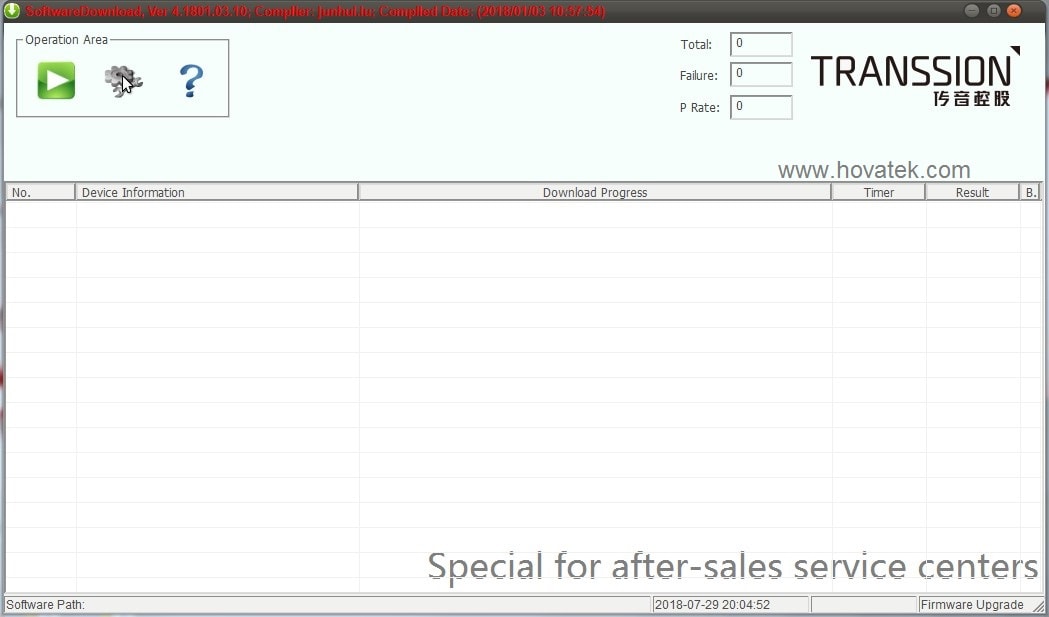

  2. Launch SoftwareDownload tool as Administrator
    [Image: How-to-use-SoftwareDownload-Tool-1.jpg]

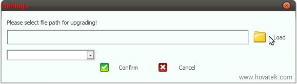

  4. In the window that pops up, click on Load
    [Image: How-to-use-SoftwareDownload-Tool-3.jpg]

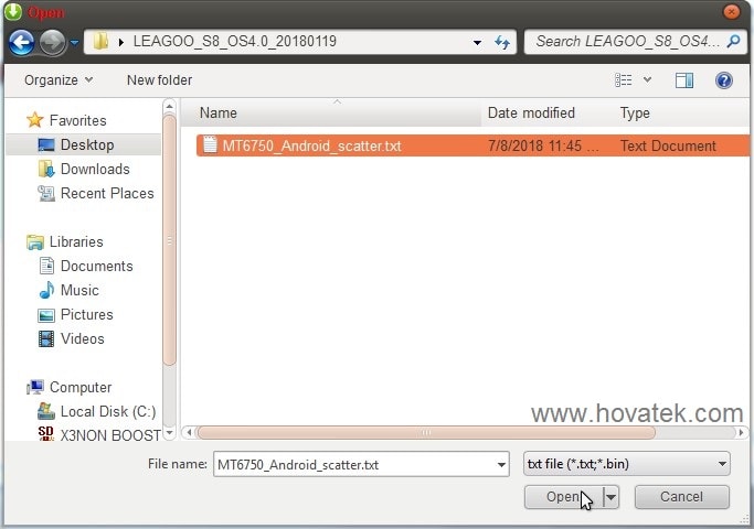

  5. In the next window that pops up, navigate to and select the scatter file for your phone model then click Open (scatter file is a text file with the word "scatter" in its name )
    [Image: How-to-use-SoftwareDownload-Tool-4.jpg]

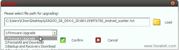

  6. You'll now be returned back to the previous window, click on the dropdown bar and select the flash settings you wish to use
    [Image: How-to-use-SoftwareDownload-Tool-5.jpg]

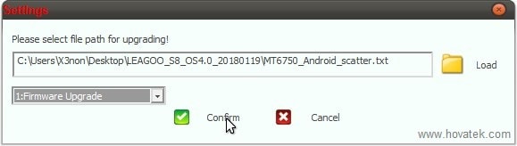

  7. Click on Confirm
    [Image: How-to-use-SoftwareDownload-Tool-6.jpg]

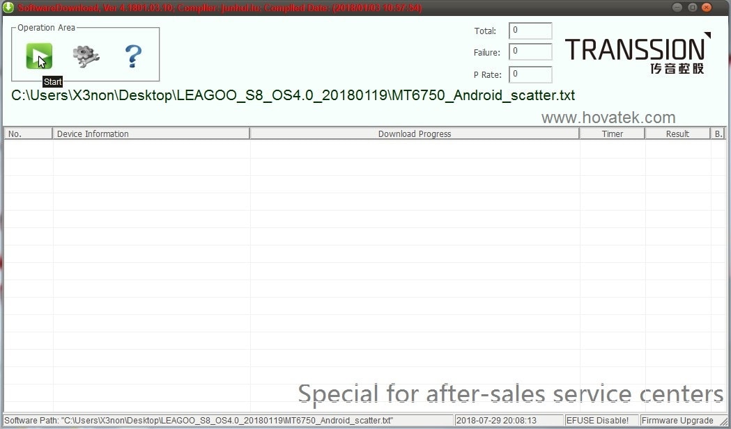

  8. You'll now be returned back to the main window, click on the Start button (indicated with a play icon in green box)
    [Image: How-to-use-SoftwareDownload-Tool-7.jpg]

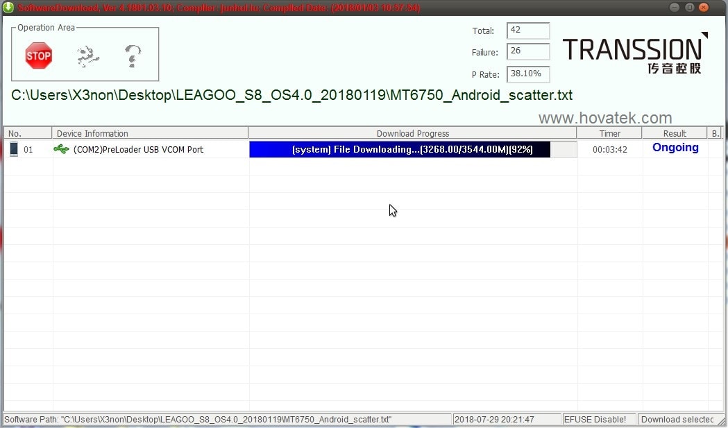

  9. The Start button should now be changed to Stop in red box
  10. Connect the switched off phone (with battery inside) to the PC via USB cord without holding any button
  11. A progress bar should start running
    [Image: How-to-use-SoftwareDownload-Tool-8.jpg]

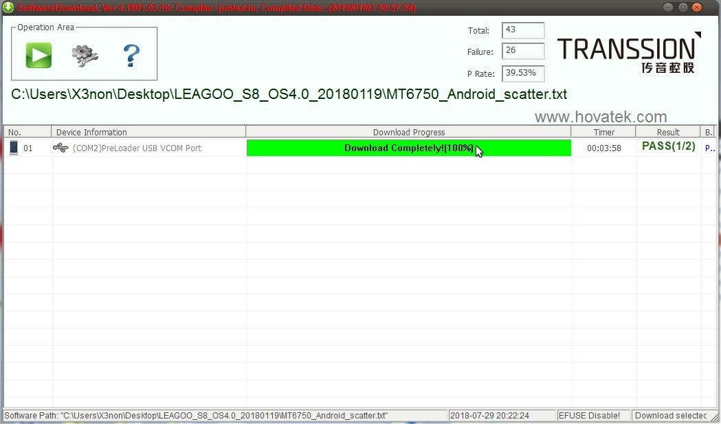

  12. Wait till you get a Success message (green bar with Download completely), do not interrupt before then
    [Image: How-to-use-SoftwareDownload-Tool-9.jpg]
