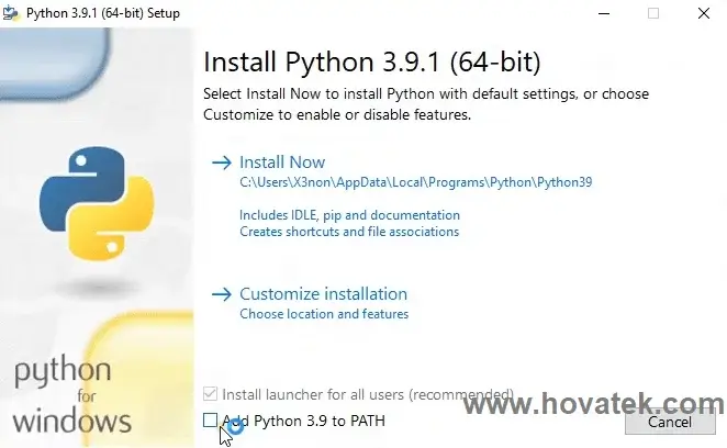

  1. Install Python and ensure to tick the checkbox Add Python x.x to PATH
    [Image: How-to-backup-flash-or-format-a-mediatek...-DA-1.webp]

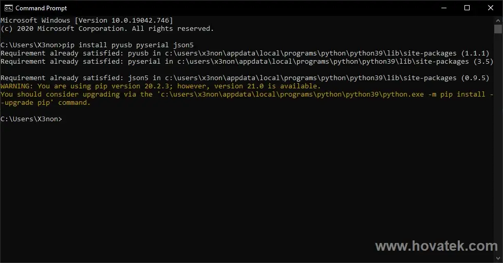

  2. Once successful, open a CMD prompt or powershell window and type the command below then press the Enter key. To confirm installation success, you can run the command a second time and you should get a requirement satisfied message seen below
    pip install pyusb json5
    [Image: How-to-backup-flash-or-format-a-mediatek...-DA-2.webp]

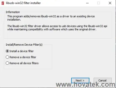

  3. Launch libusb-win32, tick Install a device filter then click Next
    [Image: How-to-backup-flash-or-format-a-mediatek...-DA-3.webp]

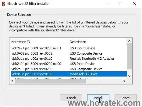

  4. At this point (depending on your model), you need to hold both volume buttons, the volume up or the volume down button then connect the phone to the PC. In the case for Nokia 3, it's volume down
  5. You should see MediaTek USB port, quickly select it and click "Install"
    [Image: How-to-backup-flash-or-format-a-mediatek...-DA-4.webp]

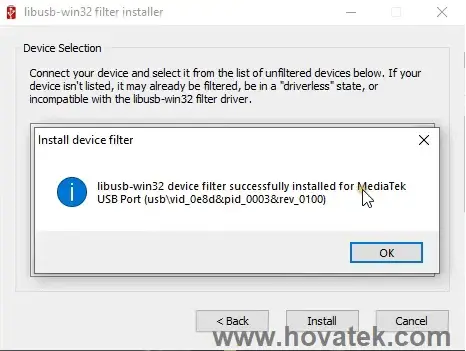

  6. You'll get a message as seen below if successful, click Ok then you can exit the libusb tool. If not successful, then retry the previous step again
    [Image: How-to-backup-flash-or-format-a-mediatek...-DA-5.webp]

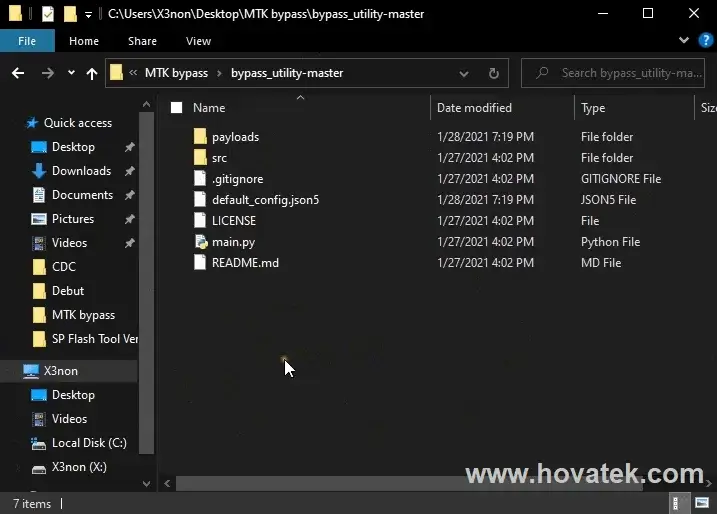

  7. From the exploit collection folder, copy the payloads folder along with default_config.json5 file into the bypass utility folder
    [Image: How-to-backup-flash-or-format-a-mediatek...-DA-6.webp]

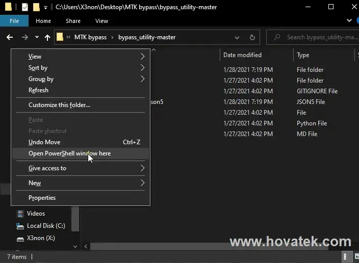

  8. In the bypass utility folder, hold the shift key then right-click and select Open CMD or Powershell window here
    [Image: How-to-backup-flash-or-format-a-mediatek...-DA-7.webp]

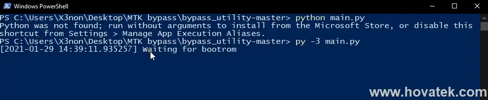

  9. In the powershell / cmd window, type the command below and press Enter. Use the second command if you get an error using the first. You should get a message, "Waiting for bootrom"
    python main.py
    py -3 main.py
    [Image: How-to-backup-flash-or-format-a-mediatek...-DA-8.webp]

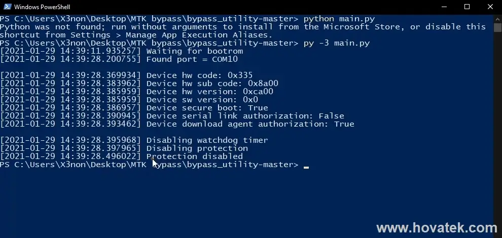

  10. At this point, either hold the volume up or volume down button on the phone then connect to the PC using a USB cable
  11. Your device should be detected and you should see Protection disabled if it's successful. You can minimize the CMD / Powershell window
    [Image: How-to-backup-flash-or-format-a-mediatek...-DA-9.webp]

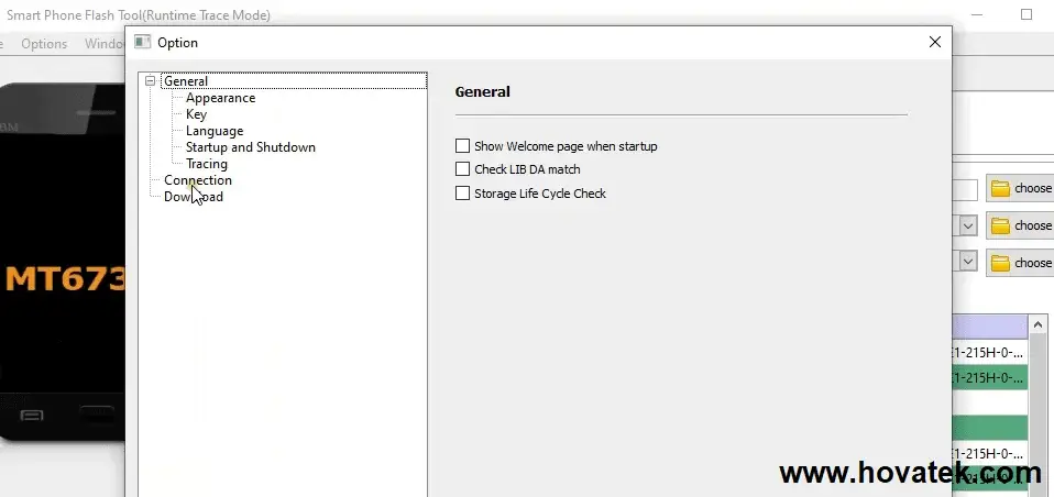

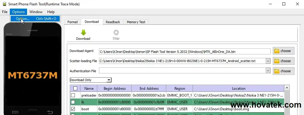

  12. Leave the phone connected, launch SP flash tool, and click Options > Option
    [Image: How-to-backup-flash-or-format-a-mediatek...DA-10.webp]
  13. In the new window, click Connection
    [Image: How-to-backup-flash-or-format-a-mediatek...DA-11.webp]

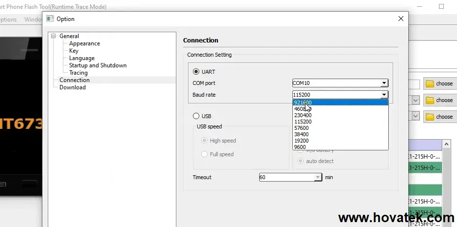

  14. Select UART, select the com port, change baudrate to 921600 then close the window (you could also use USB high-speed connection)
    [Image: How-to-backup-flash-or-format-a-mediatek...DA-12.webp]

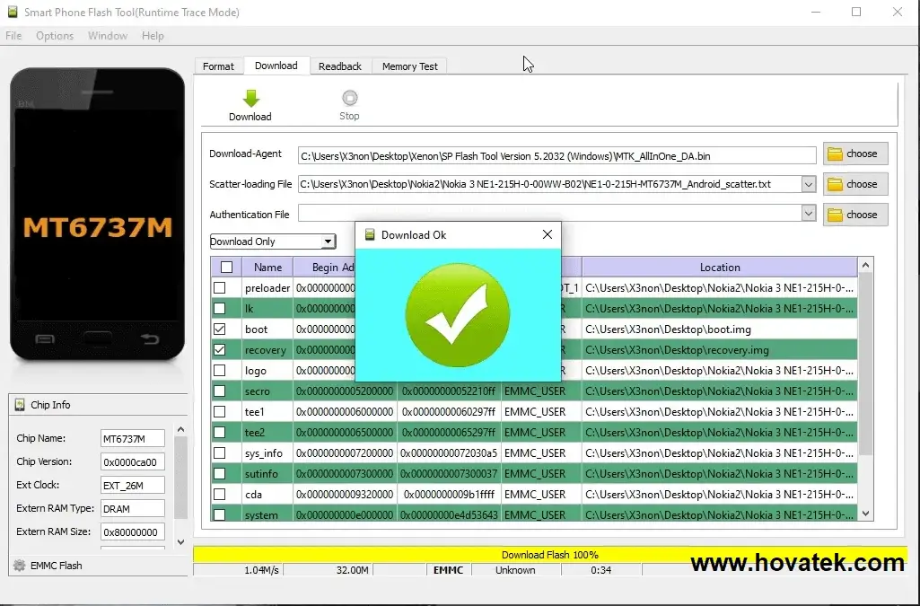

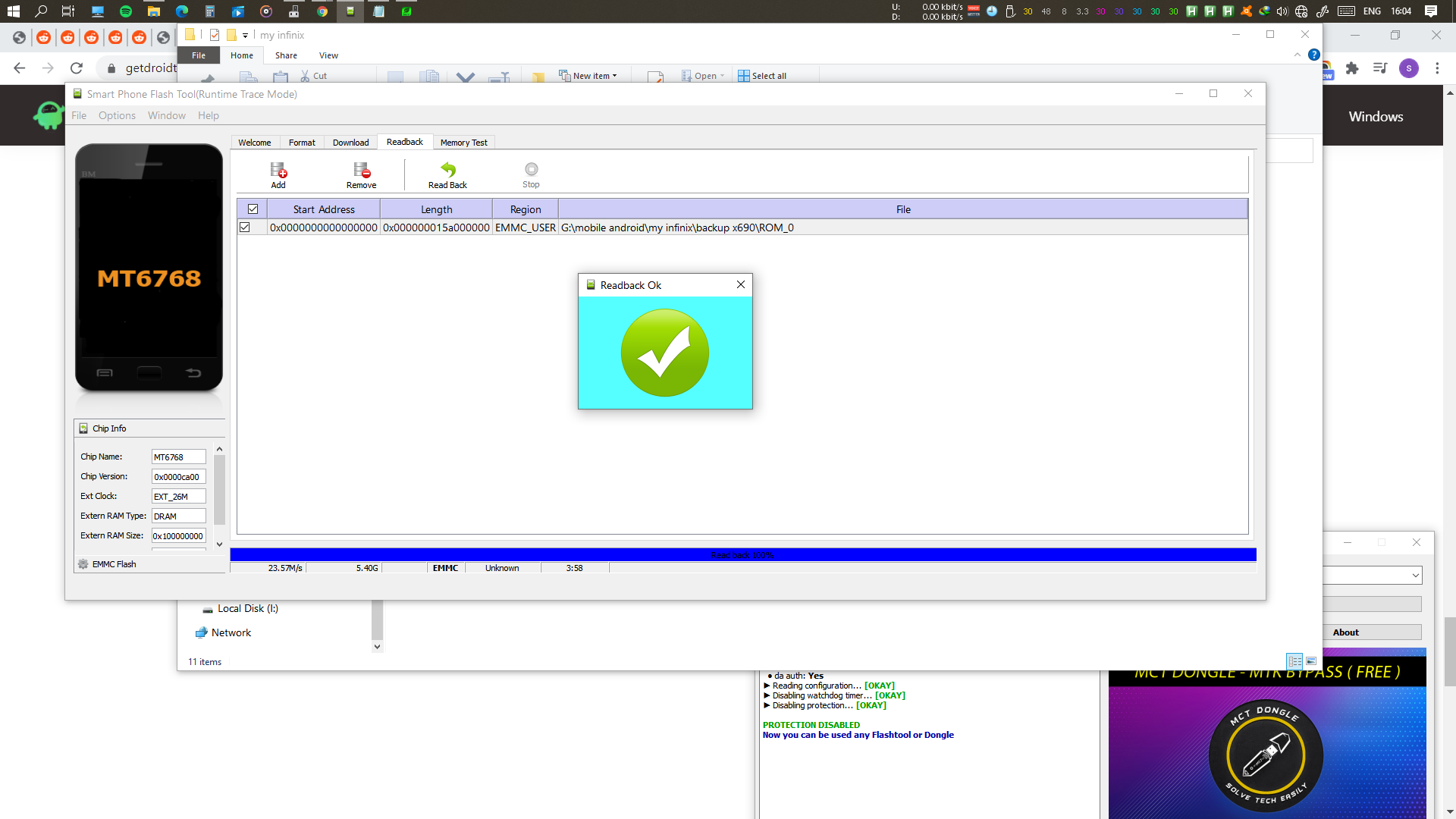

  15. You can now proceed to flash or backup firmware using tools like WWR MTK or SP flash tool and the default download DA
    [Image: How-to-backup-flash-or-format-a-mediatek...DA-13.webp]

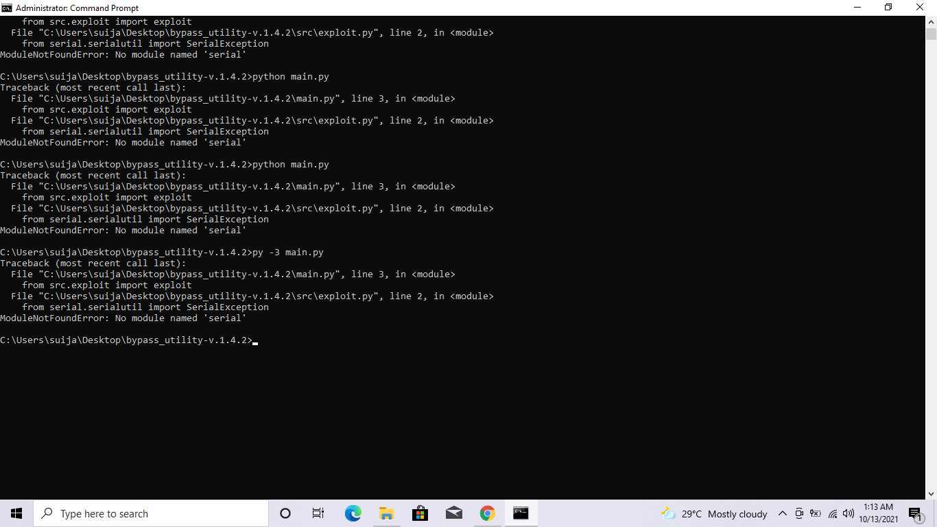

  • If you encounter an error like
    Traceback (most recent call last):   File "main.py", line 3, in <module>     from src.exploit import exploit ImportError: No module named src.exploit
    then ensure you're running the right main.py command for your installed python version (e.g py -3 main.py)

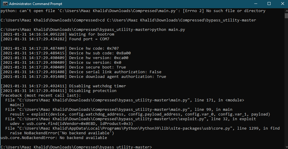

I'm getting this when i try to disable protection (See attachment)

(31-01-2021, 10:23 AM)Maaz Khalid I'm getting this when i try to disable protection (See attachment)
Install libusb-win32 filter to Mediatek USB Port
