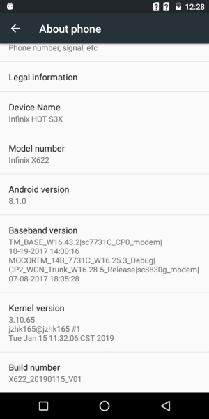

           i have this phone with SPD cpu SP7731C is there any firmware for it?
           it look like this:
           Scanning USB Serial port...
           SU2Serial Port: COM55
           Connecting to Phone,Wait..
           Done.
           Infor: SPRD3
           Initialize boot32...
           Being analyzed DATA...
           id:MRA58K release-keys
           version:6.0
           brand:SPRD
           manufacturer:SPRD
           hardware:SP7731C_V1.0.0
           manufacturer:X622
           brand:SPRD
           model:X622
           Done.
