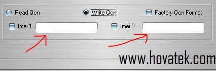

*can i hex edit miracle qcn?
*what this imei boxes is used for? (see attched )
This post was last modified: 01-09-2019, 09:06 AM by alysatip.
51,013
02-09-2019, 11:40 AM
(01-09-2019, 08:20 AM)alysatip *can i hex edit miracle qcn?
No, you can't edit miracle qcn and those boxes are to be used if you plan to manually write imei
select write qcn, tick the imei checkboxes then input the imei then proceed with the rest of the write qcn guide

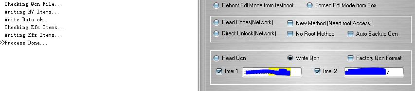

i read qcn & its fine. and write with custom imei with tick checkboxes. and perfectly written. But imei doesnt change
11-09-2019, 01:49 PM
(11-09-2019, 10:51 AM)alysatip
(02-09-2019, 11:40 AM)X3non
Sometimes you'll have to factory reset after writing IMEI.
You can try re-writing IMEI then factory reset in recovery mode/factory mode.
This post was last modified: 11-09-2019, 01:50 PM by xerxes.
