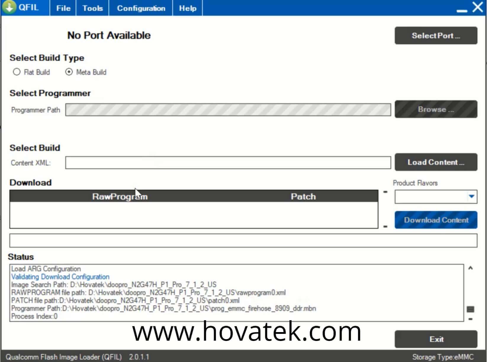

  1. Launch QFIL
    [Image: How-to-flash-a-Qualcomm-Android-phones-f...FIL-1.webp]

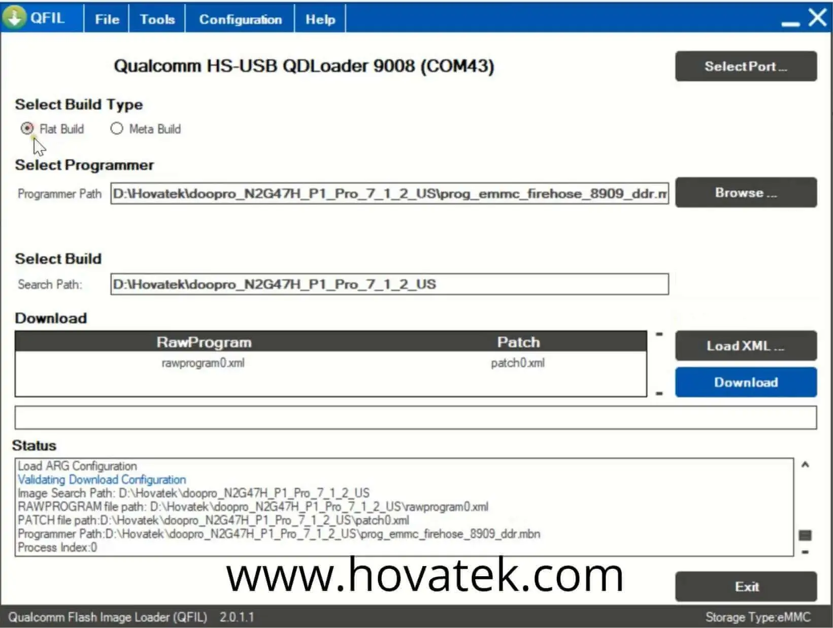

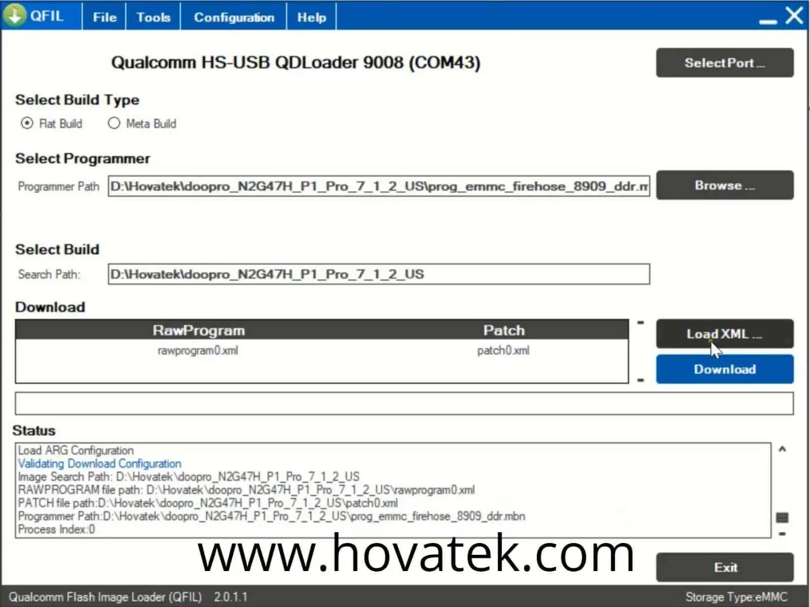

  2. Connect the device to the PC while in EDL Mode (device should be in EDL before connecting to pc). No Port Available should change to Qualcomm HS-USB QDLoader 9008
    [Image: How-to-flash-a-Qualcomm-Android-phones-f...FIL-2.webp]

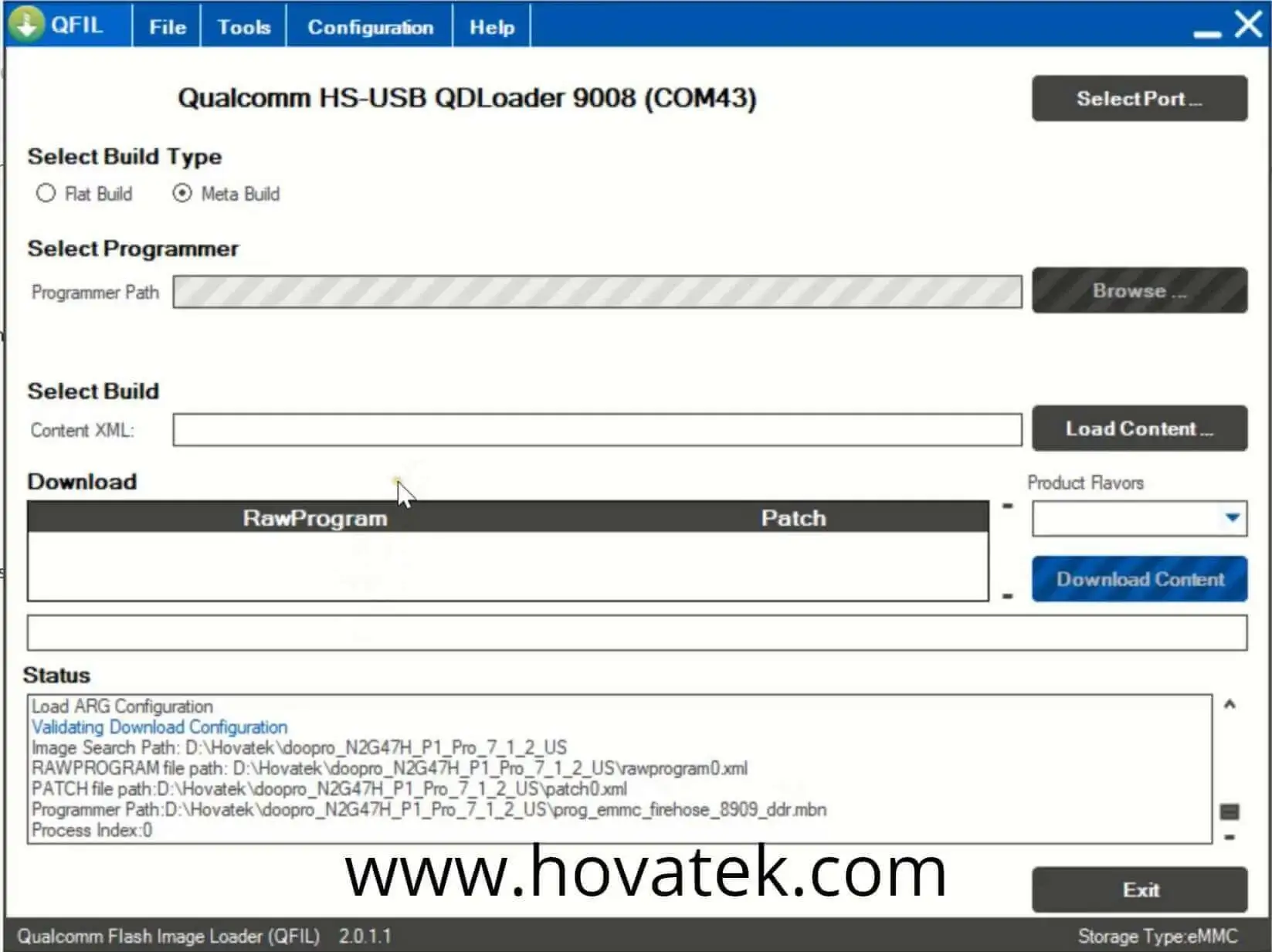

  3. Under Select Build Type, tick Flat Build
    [Image: How-to-flash-a-Qualcomm-Android-phones-f...FIL-3.webp]

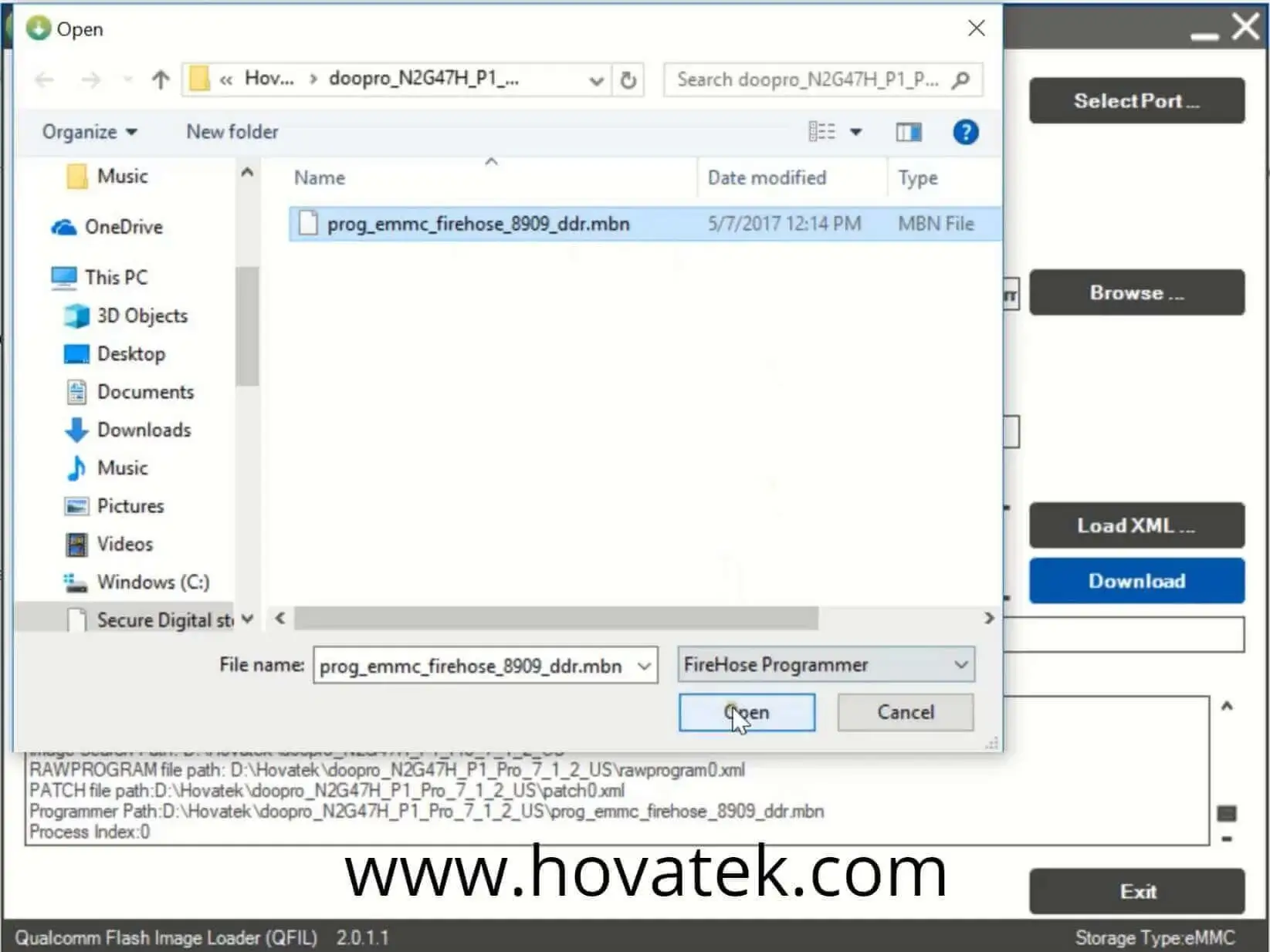

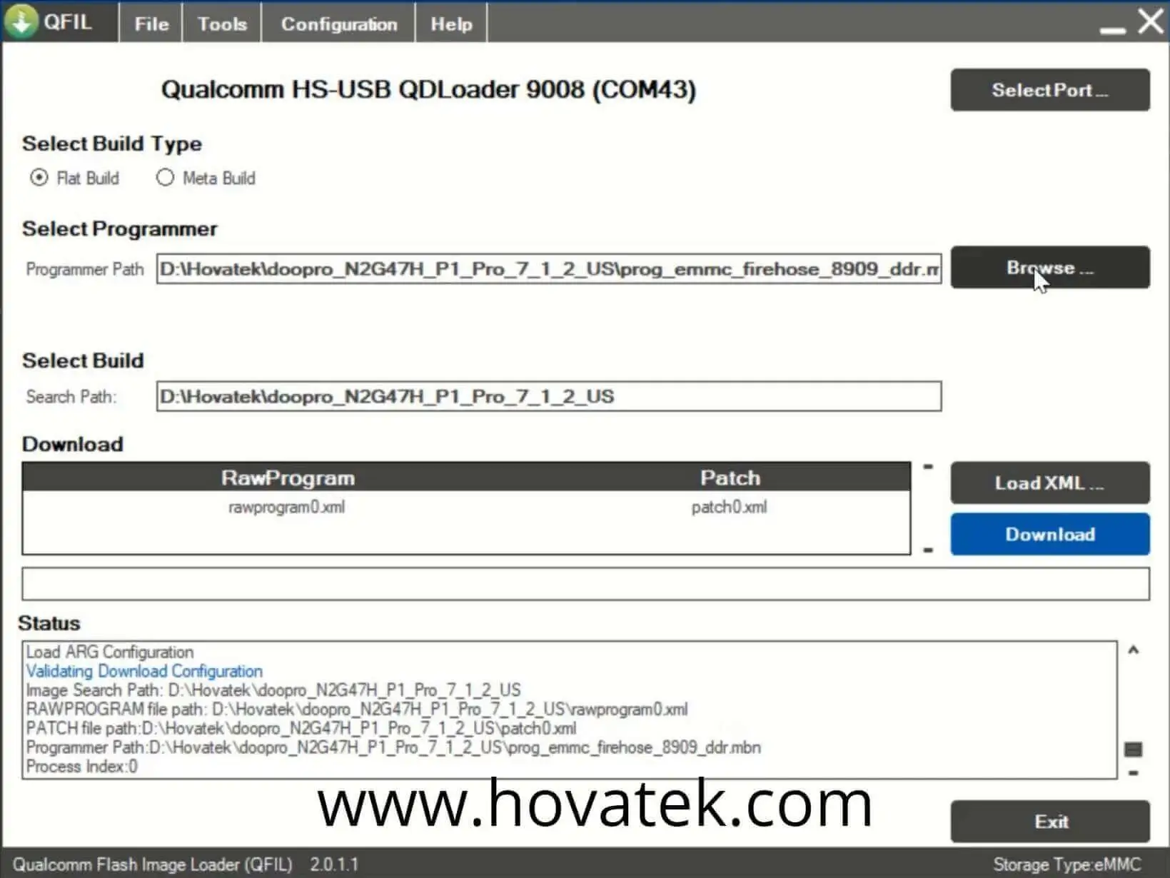

  4. Under Select Programmer, click Browse
    [Image: How-to-flash-a-Qualcomm-Android-phones-f...FIL-4.webp]
  5. In the Window that pops up, highlight the loader file (usually named prog_emmc_firehose_****.mbn) and click Open
    [Image: How-to-flash-a-Qualcomm-Android-phones-f...FIL-5.webp]

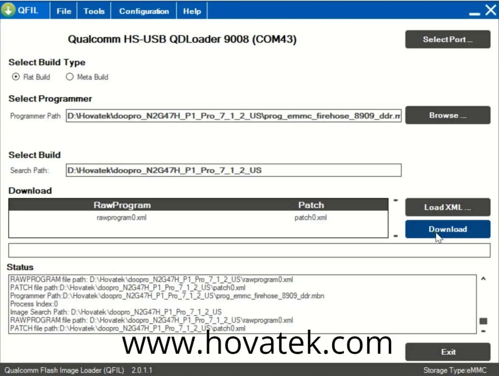

  6. Click Load XML
    [Image: How-to-flash-a-Qualcomm-Android-phones-f...FIL-6.webp]
  7. In the Window that pops up, highlight the rawprogram() file then click Open
    [Image: How-to-flash-a-Qualcomm-Android-phones-f...FIL-7.webp]

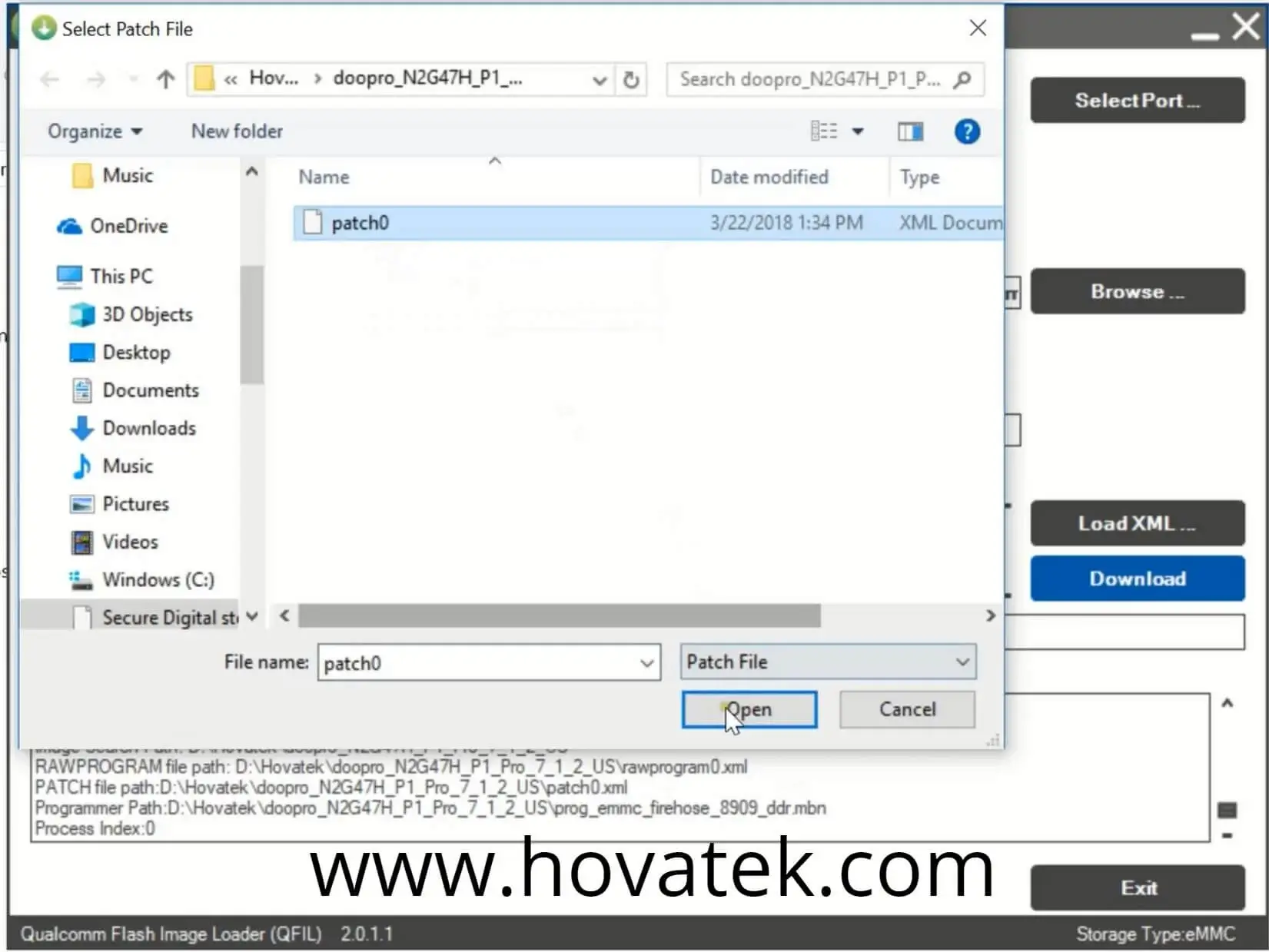

  8. Another Window will automatically pop up, highlight the patch() file then click Open
    [Image: How-to-flash-a-Qualcomm-Android-phones-f...FIL-8.webp]
  9. Click Download
    [Image: How-to-flash-a-Qualcomm-Android-phones-f...FIL-9.webp]

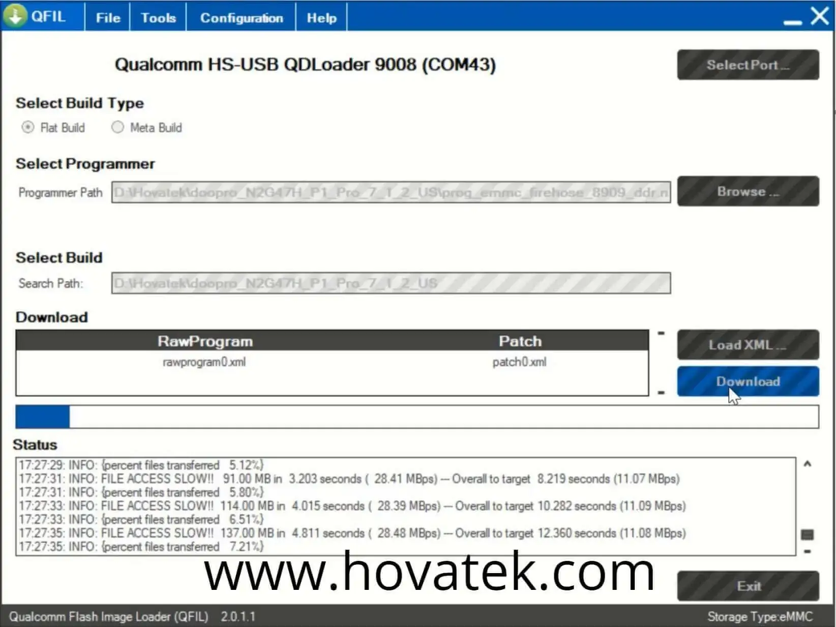

  10. QFIL should start flashing the firmware, Do Not interrupt
    [Image: How-to-flash-a-Qualcomm-Android-phones-f...IL-10.webp]

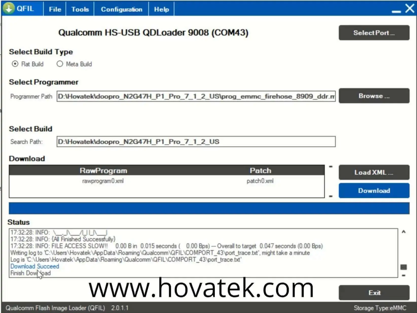

  11. You should get Download Succeed Finish Download once QFIL has successfully flashed the firmware. Disconnect the device and boot up
    [Image: How-to-flash-a-Qualcomm-Android-phones-f...IL-11.webp]

For Flat build, you select Programmer (*emmc_firehose*) file. For Meta build, you select the contents.xml and you might find multiple cache, userdata & system images.

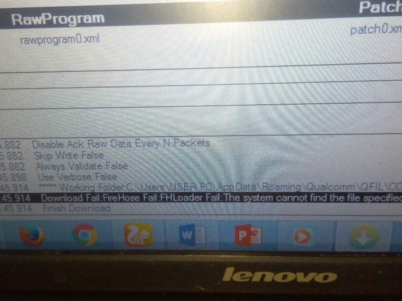

29-04-2019, 04:11 PM
(02-04-2018, 06:45 PM)hovatek ...
I followed all the step stated, but am getting the error message

29-04-2019, 04:22 PM
The screenshot contains the error
