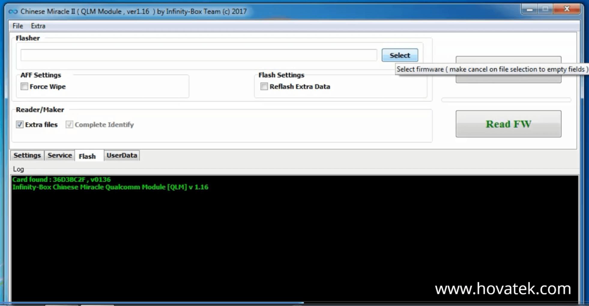

  1. Launch Infinity CM2 QLM
    [Image: How-to-flash-a-Qualcomm-Android-phones-f...-QLM-1.jpg]
  2. Click the Flash tab
    [Image: How-to-flash-a-Qualcomm-Android-phones-f...-QLM-2.jpg]

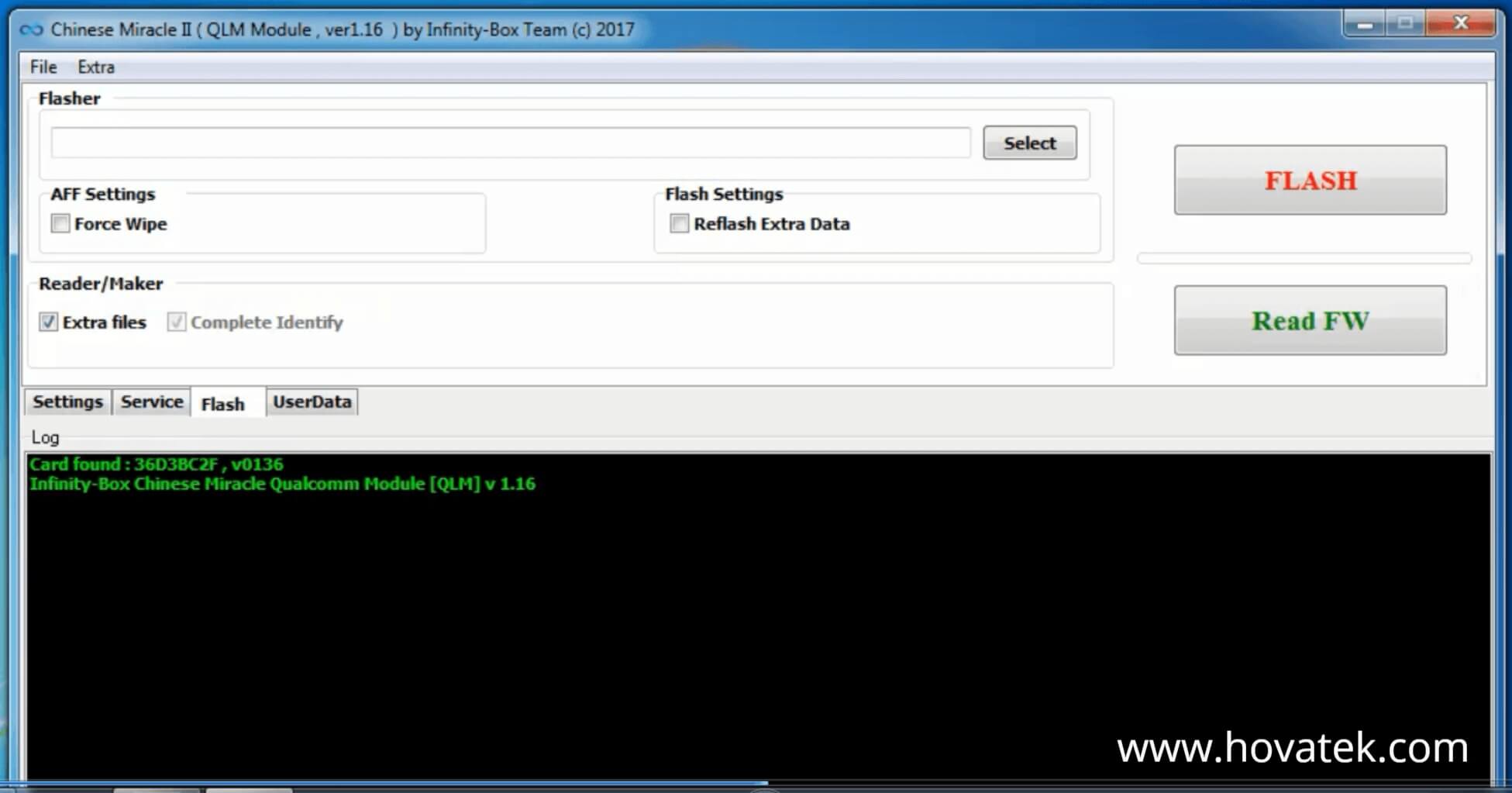

  3. Click the Select button
    [Image: How-to-flash-a-Qualcomm-Android-phones-f...-QLM-3.jpg]

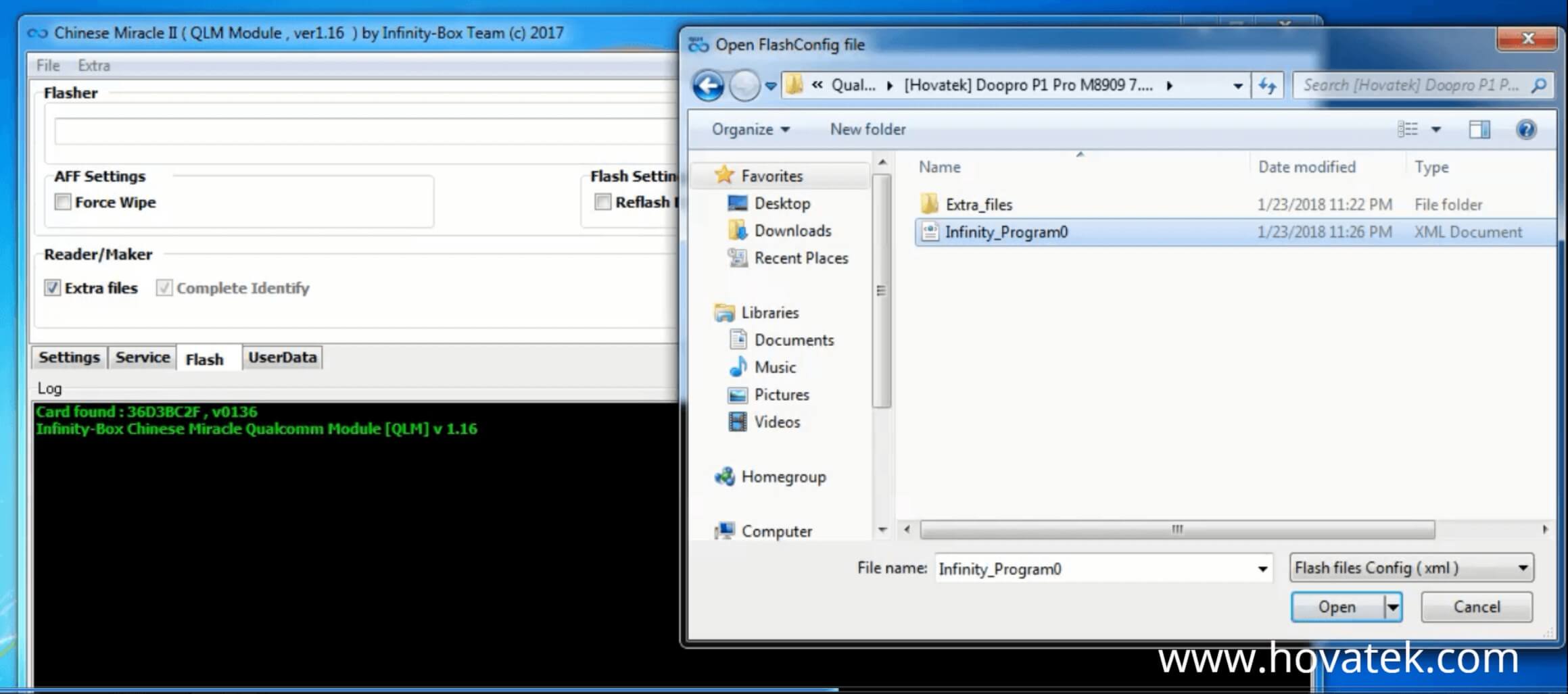

  4. In the Window that pops up, navigate to the location of the firmware, select the XML file and click Open
    [Image: How-to-flash-a-Qualcomm-Android-phones-f...-QLM-4.jpg]

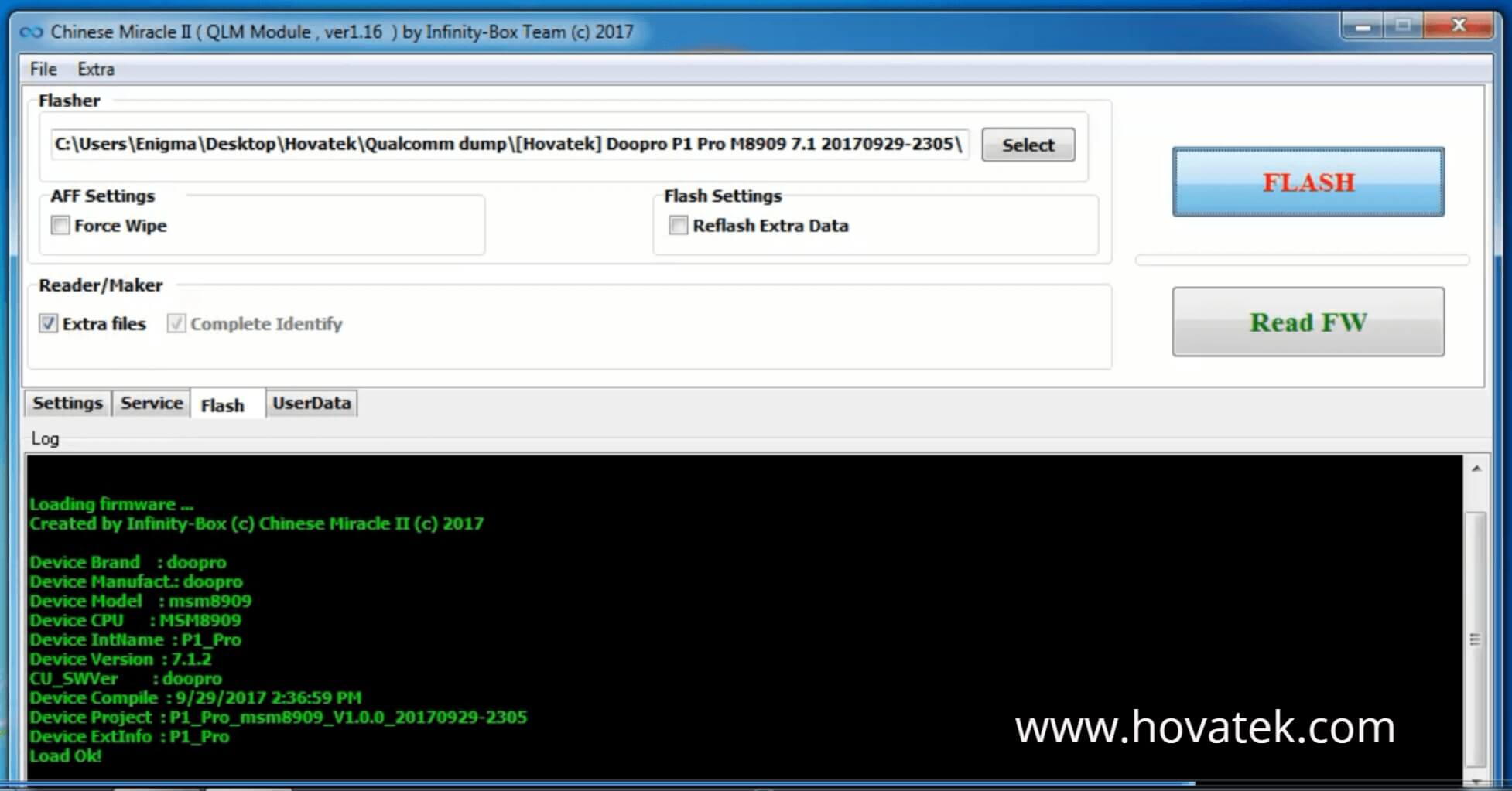

  5. The firmware should get loaded, you may tick or untick Force Wipe and Reflash Extra Data depending on what you wish to do
    [Image: How-to-flash-a-Qualcomm-Android-phones-f...-QLM-5.jpg]

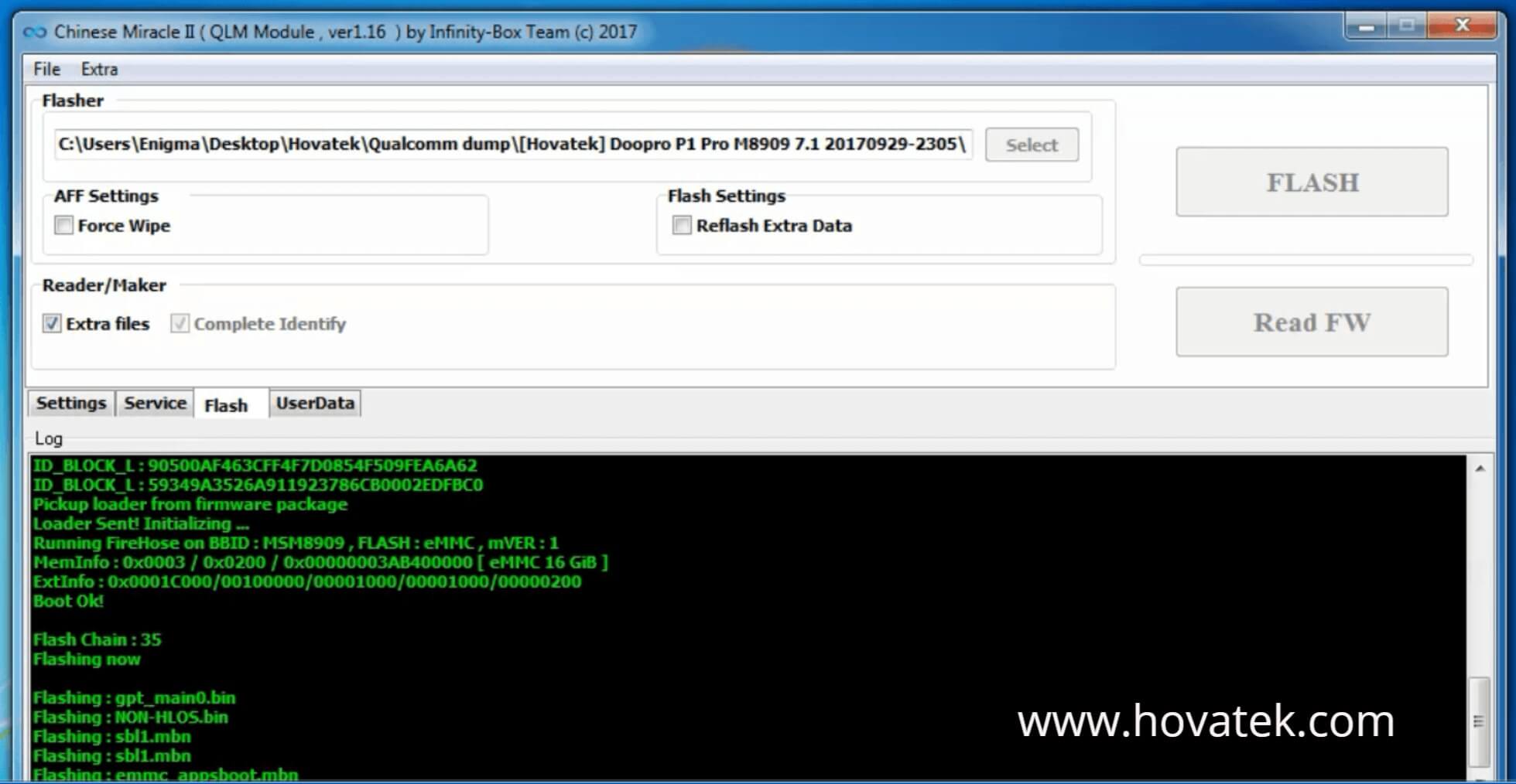

  9. Infinity CM2 QLM should start flashing the partitions, do not interrupt
    [Image: How-to-flash-a-Qualcomm-Android-phones-f...-QLM-9.jpg]

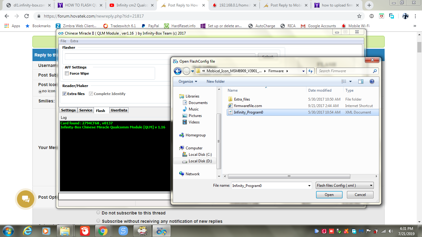

Hi please help me load Mobicel Icon Firmware to CM2 QLM Tool. When i try to open Firmware i get three files and cant upload to tool...check attachment for clarity

48

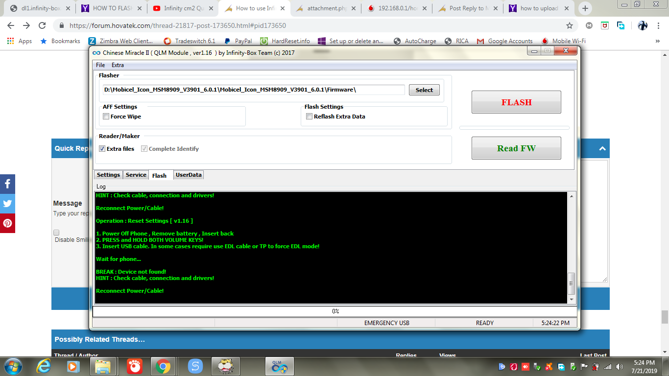

21-07-2019, 04:34 PM
I have managed to figure it out...i chose XML Document and loaded firmware.
Now phone cant get detected...please help
21-07-2019, 10:44 PM
(21-07-2019, 04:34 PM)JIJO I have managed to figure it out...i chose XML Document and loaded firmware.
you're to boot the phone to edl mode then connect to the PC, see step 7 in the guide OR visit https://www.hovatek.com/forum/thread-21791.html
