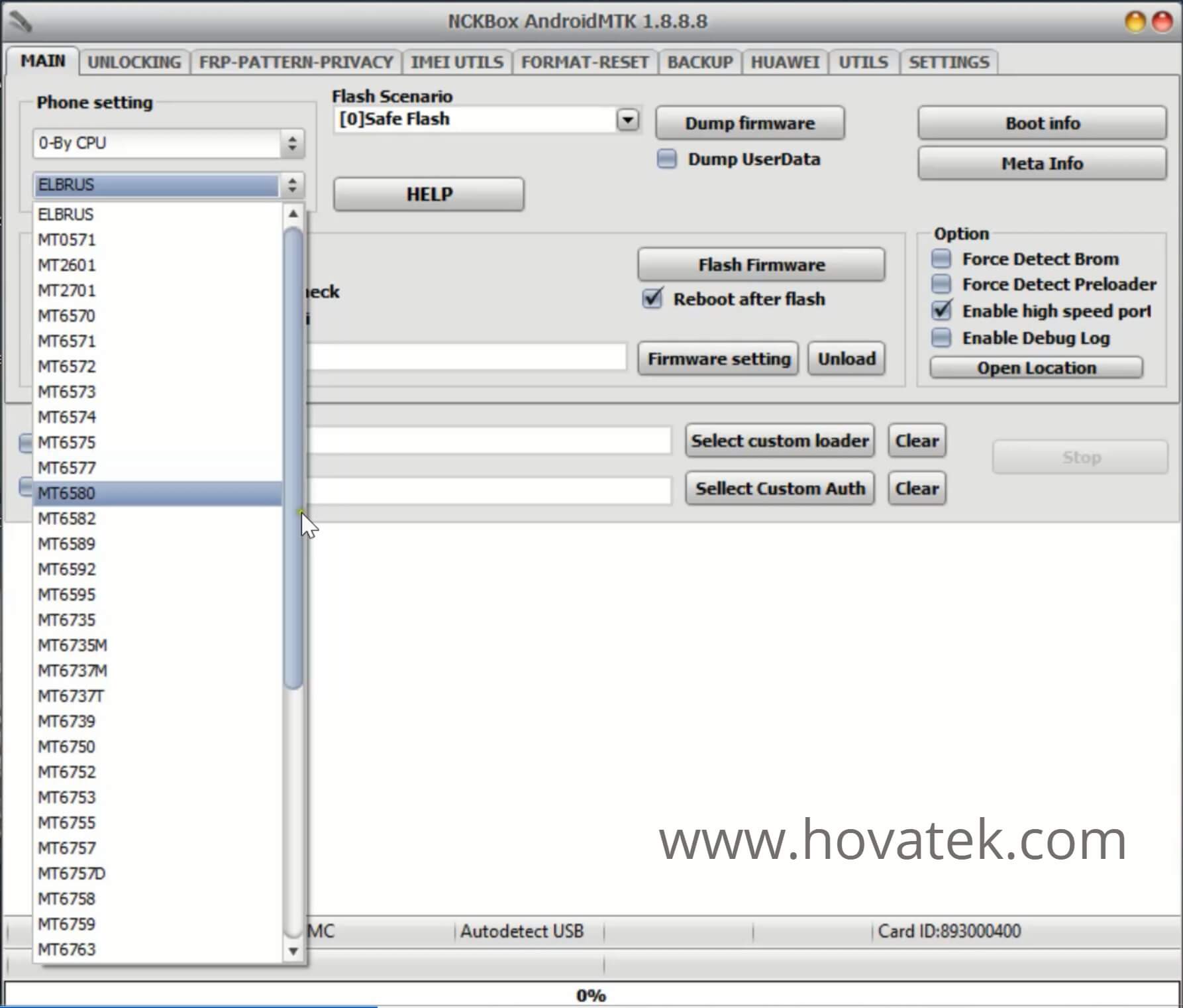

  2. Under Main > Phone settings, leave the first dropdown as 0-by-CPU and select your phone's chipset (MTxxxx) from the second dropdown
    [Image: How-to-backup-or-dump-a-Mediatek-Android...-Box-2.jpg]

Now, what You'll want to do under Phone Setting is to leave the first option as 0 by CPU. Now, under this second drop-down, what You'll want to do is select Your phone's chipset. Now, my phone is an MT6580 phone so I'l just select the MT6580 from that drop-down and then head over to this part. Now, if You want to backup the phone's userdata what You need to do is just tick Dump Userdata but I don't want to backup userdata because that'll make the backup take a little longer but it's very important to do that if You intend to backup your data.
