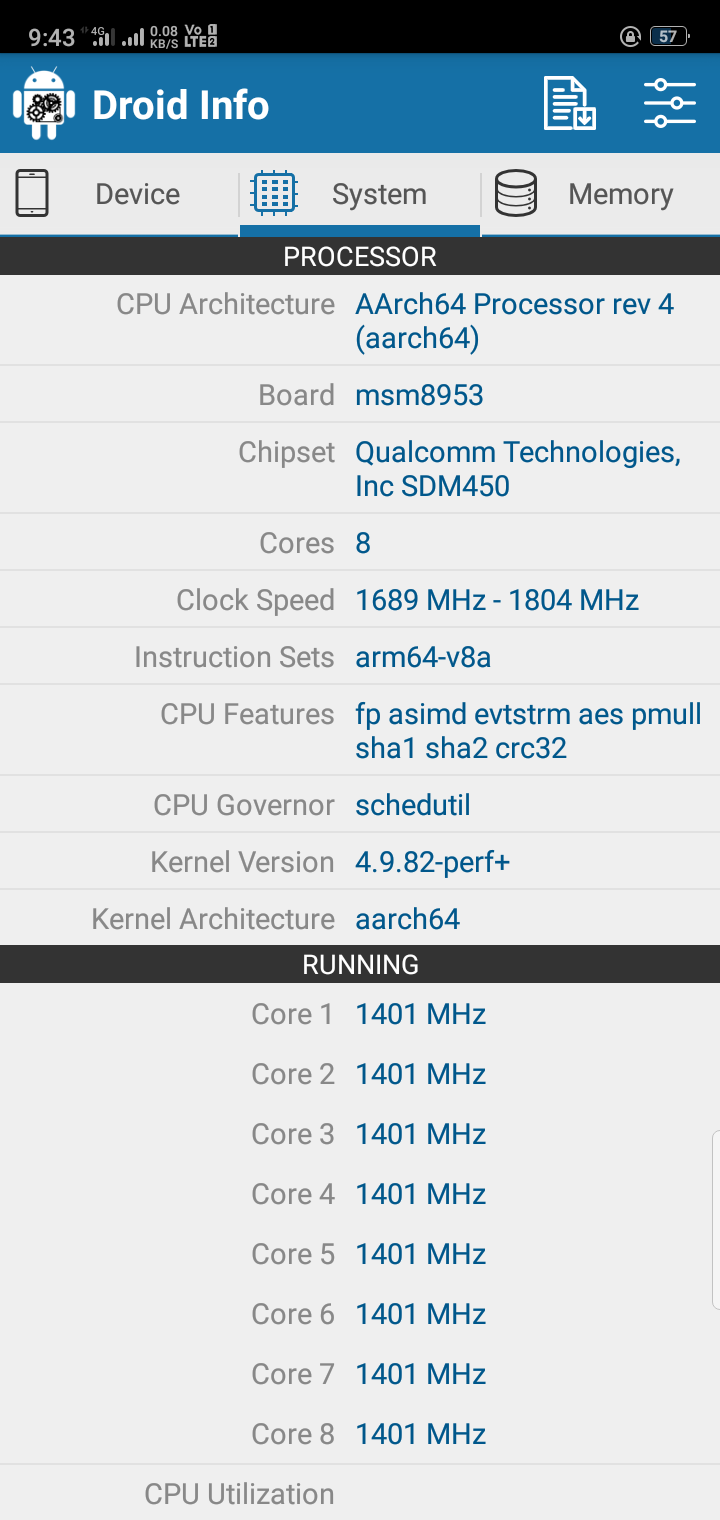

  1. Download and install Droid Hardware Info
    [Image: How-to-know-your-Phones-Processor-Type-A...-x86-1.png]
  2. Launch the app and select the "SYSTEM" tab. Here you can find all details about your processor your
    [Image: How-to-know-your-Phones-Processor-Type-A...-x86-2.png]
  3. Crosscheck your CPU architecture with their common names below

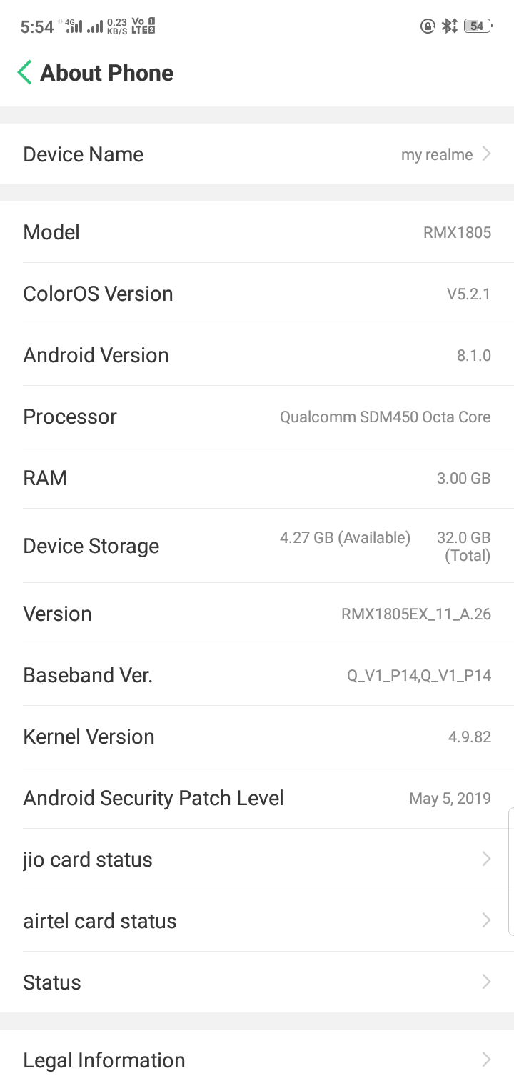

Actually i have added that one but didn't sure that has been uploaded
Here is the full details screenshots
