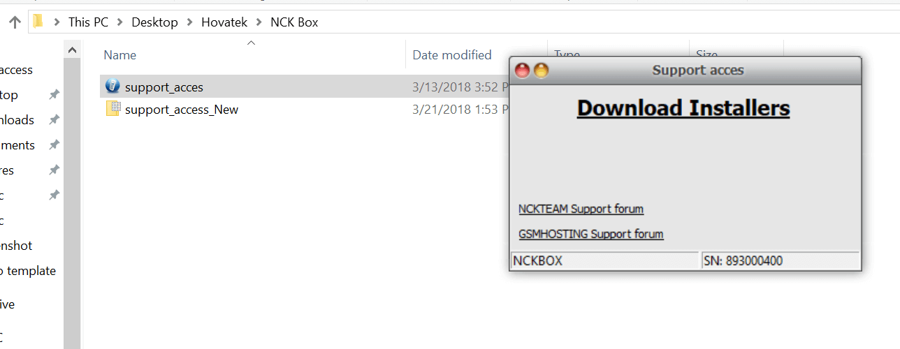

  4. The Support Access dashboard should pop up, click Download Installers
    [Image: How-to-setup-NCK-Pro-Box-2.png]
