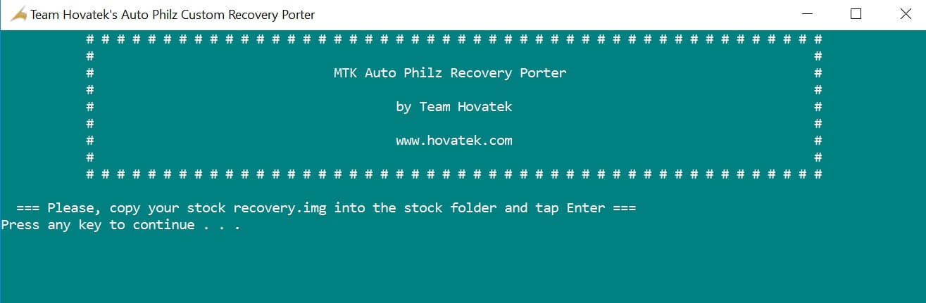

We do realize that some users would still need a custom recovery to backup or flash custom roms so we've created this MTK Auto Philz recovery porter to make it really easy to get a working custom recovery for your Mediatek Android phone
[Image: MTK-Auto-Philz-recovery-porter-by-Team-Hovatek.jpg]

  1. Extract the MTK Auto Philz recovery porter zip
  2. Copy the stock recovery.img into the stock folder
  3. Double-click Auto Philz Recovery Porter.exe
  4. Tap Enter to confirm that you've copied your stock recovery.img into the stock folder
  5. Enter the option for your Android version (5 for Lollipop, 6 for Marshmallow & 7 for Nougat) and tap Enter
  6. Type Y or N (depending on whether or not you have an external SD card in your phone) then tap Enter
  7. Wait while our tool ports the Philz recovery
  8. You'll find your ported Philz recovery in the output folder.
  9. Flash the recovery image to your device
