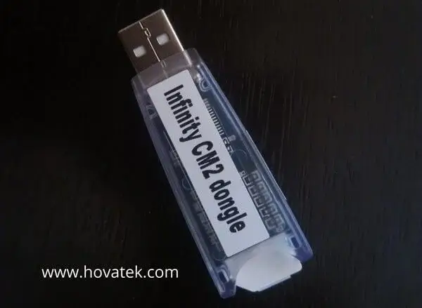

In order to run Chinese Miracle II (CM2) software like CM2MTK, CM2SPD, CM2QLM etc, you'll need an Infinity CM2 dongle. If you're looking to buy an Infinity CM2 dongle then Order Now .
[Image: Infinity-box-CM2-Dongle.webp]
