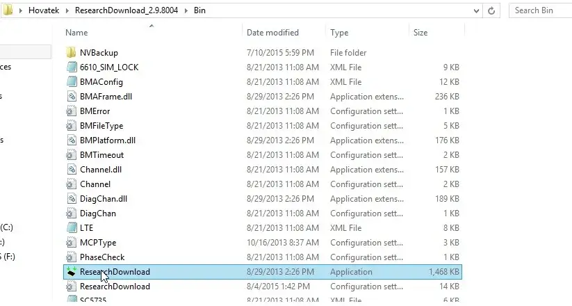

  1. Launch Research Download tool
    [Image: how-to-unpack-a-pac-file-1.webp]

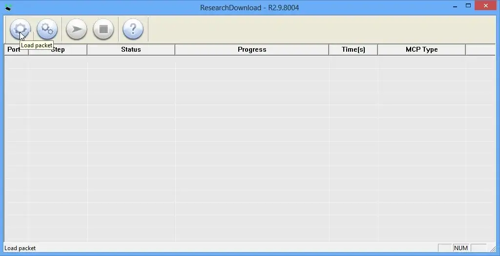

  2. Click on the Load Packet icon
    [Image: how-to-unpack-a-pac-file-2.webp]

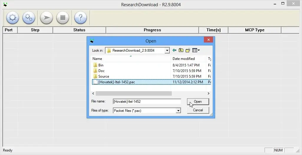

  3. In the window that pops up, select the pac file you wish to unpack then click Open
    [Image: how-to-unpack-a-pac-file-3.webp]

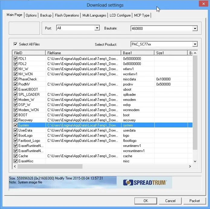

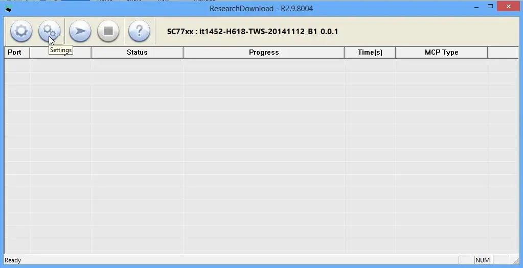

  4. Once the pac file has been loaded, click the Settings icon
    [Image: how-to-unpack-a-pac-file-4.webp]
  5. Highlight any item on the list
    [Image: how-to-unpack-a-pac-file-5.webp]

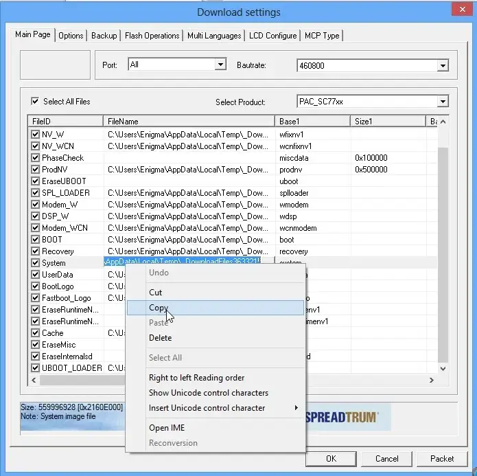

  6. Double-click the highlighted item then right-click and copy the path
    [Image: how-to-unpack-a-pac-file-6.webp]
  7. Paste the copied path to a note pad
    [Image: how-to-unpack-a-pac-file-7.webp]

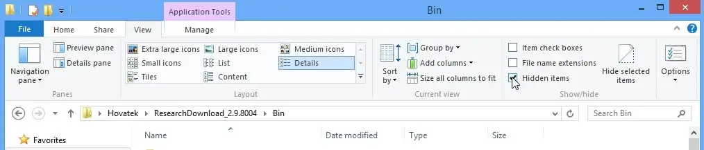

  8. Open any folder then unhide all hidden items (the exact steps might vary with OS)
    [Image: how-to-unpack-a-pac-file-8.webp]
  9. Navigate to the path above and you'll find all the files thereĀ

Now what we need to do is to go back to the folder
Image files >> under the research download tool folder
You'll find a folder randomly named
Open it
This is your extracted firmware
So you can copy this out or do whatever you want with it
