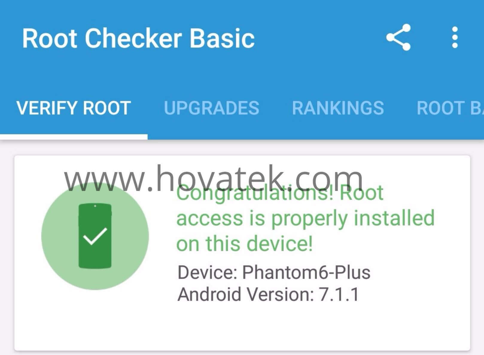

[Image: Hovatek-How-to-root-Tecno-Phantom-6-Plus-Nougat.jpg]
The Tecno Phantom 6 Plus (A9) is powered by the MT6797 (Mediatek Helio P20) SoC and ships with Android 6 (Marshmallow) upgradable to Android 7 (Nougat). For those who have not yet upgraded their Tecno Phantom 6 Plus from Marshmallow to Nougat (A9-H971A-N1-170725V72),  simply follow the guide @ https://www.hovatek.com/blog/how-to-upda...pdate-zip/ .
For those who have successfully upgraded to Nougat and are looking to root, this guide will explain how.
How can I root my Tecno Phantom 6 Plus (Nougat) ?

  • Launch Magisk Manager and Root checker to verify root
