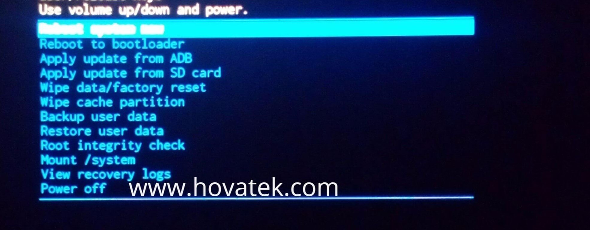

Team Hovatek has been able to obtain the Tecno A9-H971A-N1-170725V72 update.zip, which was extracted from a working Tecno Phantom 6 Plus after successfully downloading the Nougat OTA update.zip file. This is the Tcard format which you can easily install offline (without needing an internet connection) from your SD card.

Here lies the obvious advantage of having the Tecno Phantom 6 Plus (A9) Tcard update.zip offline; you can install it anytime you want without having to expend data.

  1. Good afternoon. I have been trying the update and followed your steps. But it keeps giving installation aborted and telling me to continue the installation. Then I select the file and it keeps showing installation aborted. Please I need further assistance.
    1. Hope you unzipped the .7z file you downloaded from here first. You’re supposed to place update.zip in your SD card (which is obtained after unzipping the file you download here), not the .7z file
  2. Am Really Thank You For Ur Helping Guide to Upgrade Android 6 to Nougat /Android 7.1.1/ It Takes Me Only 13 Minutes To Complete the Process, I Update My Tecno Phantom 6+ Using SD card and Ur Step by Step Guide. God Bless You Guys.
