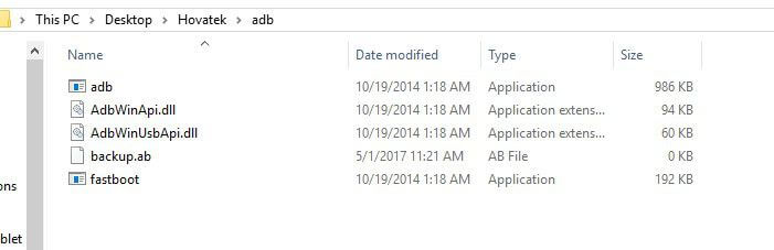

  1. Open the adb folder
    [Image: Hovatek-How-to-unlock-the-Bootloader-of-...one-1.webp]

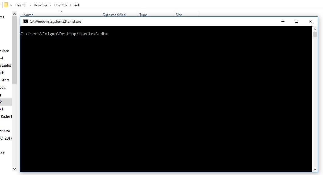

  3. Command prompt screen (ADB) should now be open
    [Image: Hovatek-How-to-unlock-the-Bootloader-of-...one-3.webp]

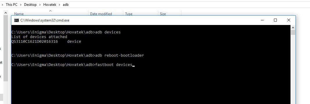

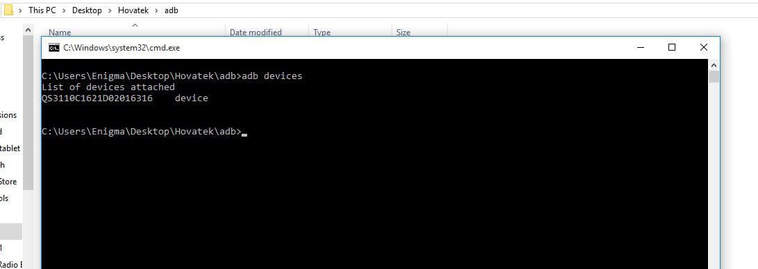

  4. Connect the device to the PC (via USB cord) while ON then run the command below (by "run", I mean type then press Enter
    adb devices
    [Image: Hovatek-How-to-unlock-the-Bootloader-of-...one-4.webp]
  5. If you've set up everything right, the device should get detected under the List of devices attached
    [Image: Hovatek-How-to-unlock-the-Bootloader-of-...one-5.webp]

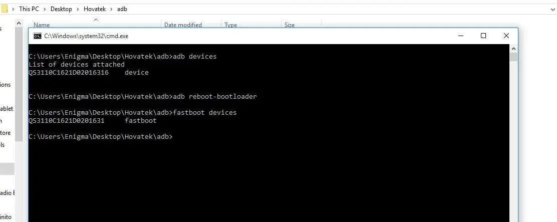

  6. Run the command below to get the device into Bootloader (fastboot)
    adb reboot-bootloader
    if that fails
    adb shell reboot fastboot
    [Image: Hovatek-How-to-unlock-the-Bootloader-of-...one-6.webp]
  7. The device should now boot into fastboot (a black or coloured screen with the text fastboot)
  8. In fastboot, test detection/connection to the device using the command:
    fastboot devices
    [Image: Hovatek-How-to-unlock-the-Bootloader-of-...one-7.webp]
  9. If fastboot is set up right, you should see its ID printed out
    [Image: Hovatek-How-to-unlock-the-Bootloader-of-...one-8.webp]

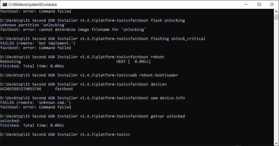

  10. Now, check the device's Bootloader lock status using either of the two commands below (if it's locked or unlocked)
    fastboot oem device-info fastboot getvar unlocked
    [Image: Hovatek-How-to-unlock-the-Bootloader-of-...one-9.webp]
    1. If you use the fastboot oem device-info command and the result is false then your bootloader is locked but if the result is true then the bootloader is unlocked
      [Image: Hovatek-How-to-unlock-the-Bootloader-of-...ne-14.webp]
    2. If you use the fastboot getvar unlocked command and the result is no then your bootloader is locked but if the result is yes then the bootloader is unlocked
      [Image: Hovatek-How-to-unlock-the-Bootloader-of-...ne-12.webp]

  12. If that doesn't work then try the commands below:
    fastboot oem unlock-go fastboot flashing unlock fastboot flash unlocking fastboot bbk unlock_vivo
    Note: Vivo phones require a custom fastboot binary (attached at the end of this post)
    [Image: Hovatek-How-to-unlock-the-Bootloader-of-...ne-13.webp]
  13. Some devices require you to also run:
    fastboot flashing unlock_critical
  14. You should get a prompt (on the device) asking you to press Volume up to confirm or Volume down to cancel. Press Volume up on the device (for some phones it is actually the opposite; Volume down would confirm while up would cancel or do nothing)

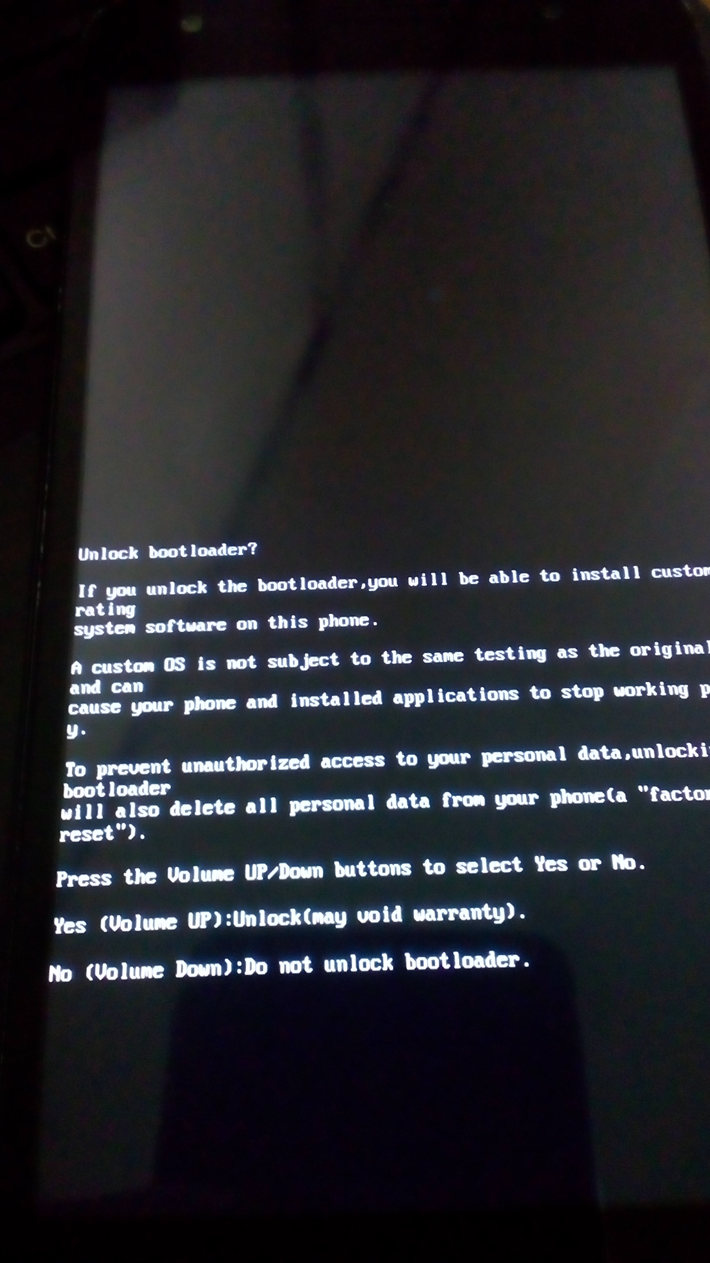

(06-04-2018, 03:58 PM)sparleta Hi guys,I have been using the step by step guide to unlock my Infinix Hot5 Model X559C. Unfortunately, once i send the code to unlock bootloader the screen pops out on my phone but does not respond to either Volume Up/Down or Power button. What could be the case? Attached is the image where it hangs
did you enable oem unlocking in settings before trying to unlock?
and why are you trying to unlock bootloader?
This post was last modified: 06-04-2018, 10:34 PM by freshtyt.
