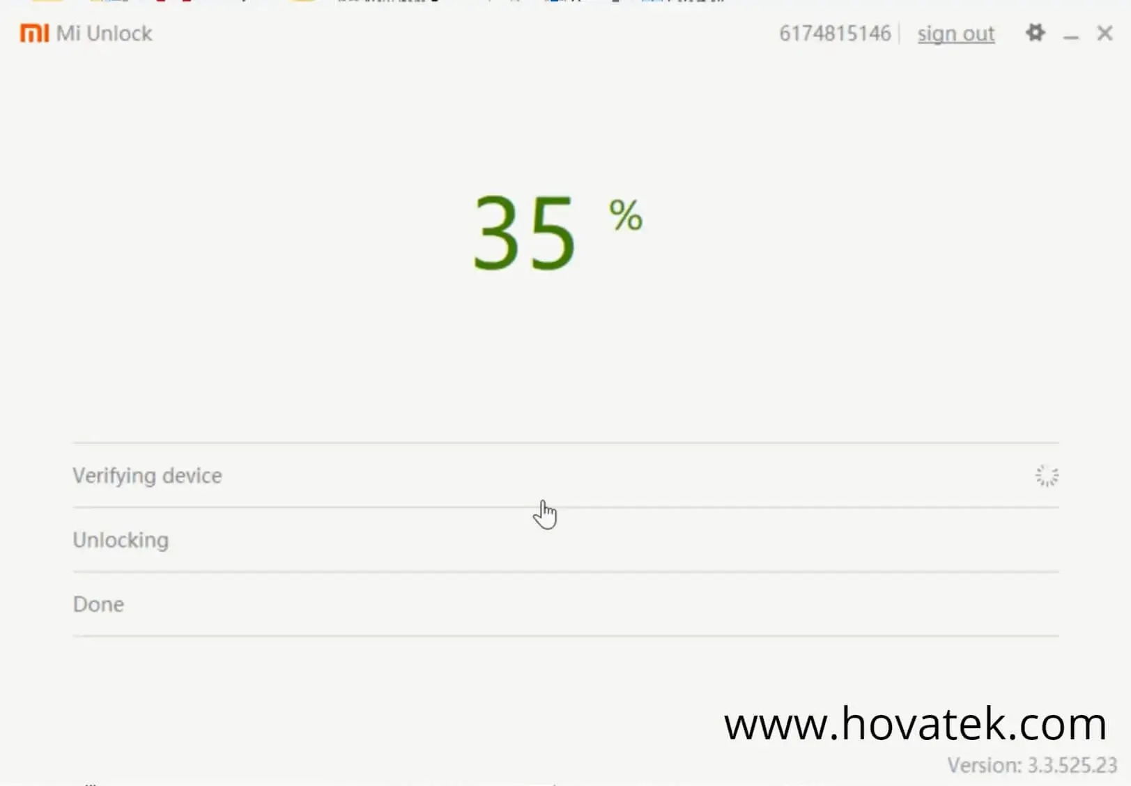

  15. Wait while the bootloader gets unlocked
    [Image: How-to-use-Mi-Unlock-tool-to-unlock-Xiao...er-11.webp]
  16. If successful, you should see Unlocked successfully, else check the important notices section below for possible errors and solutions
    [Image: How-to-use-Mi-Unlock-tool-to-unlock-Xiao...er-12.webp]

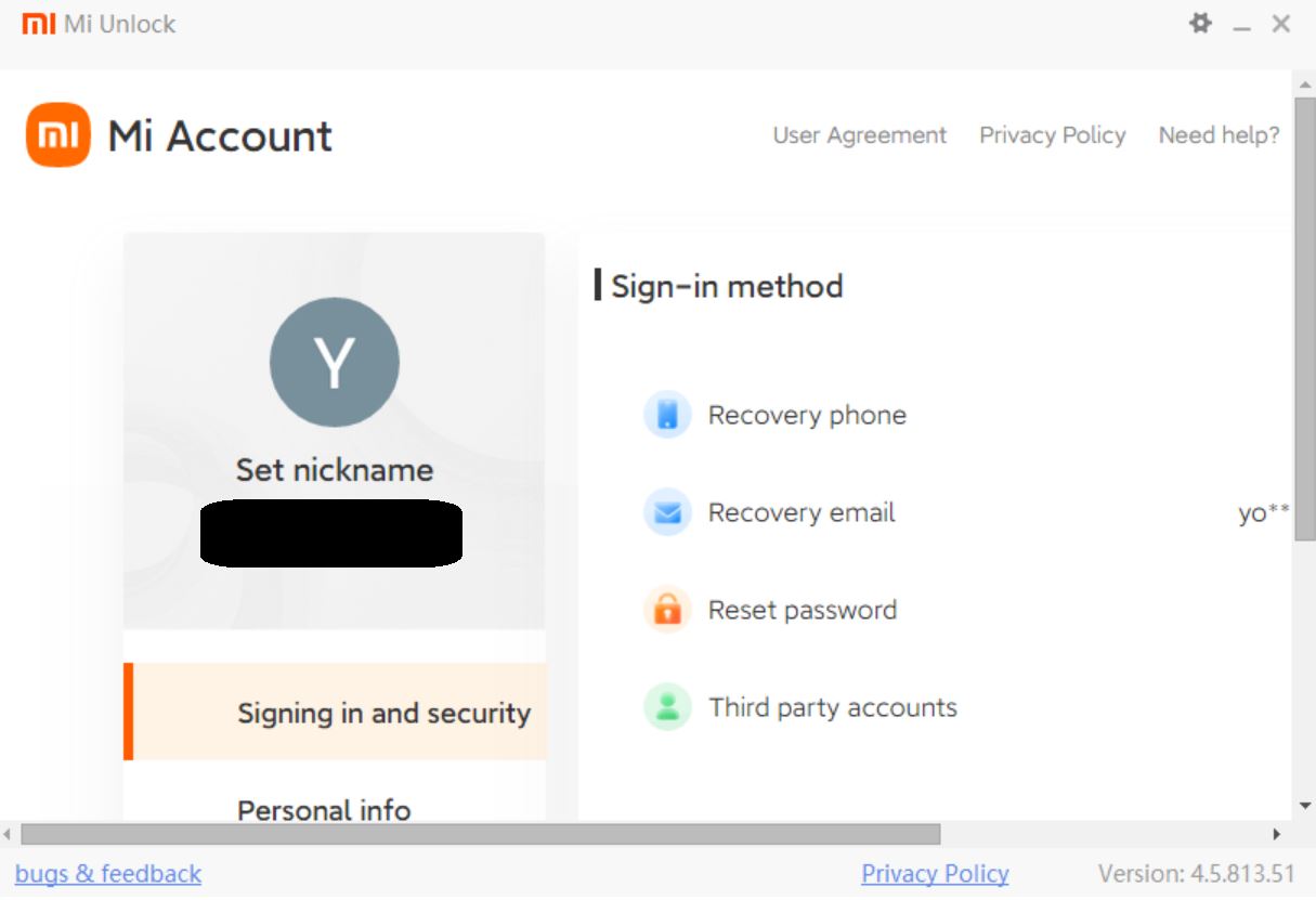

24-04-2021, 07:58 PM
Hi after i sign in it's not showing "unlock screen" just my mi account start screen, any way to fix that?
51,093
26-04-2021, 09:02 AM
(24-04-2021, 07:58 PM)yossiwise Hi after i sign in it's not showing "unlock screen" just my mi account start screen, any way to fix that?
is this the same mi account you have on the phone itself?
