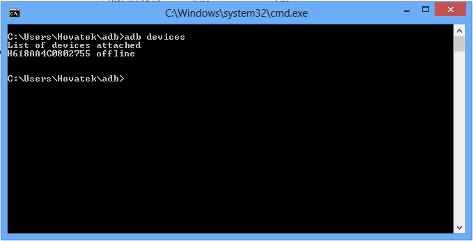

  8. You'll likely get a response as shown in the image below
    [Image: make-adb-detect-a-spreadtrum-phone-1.jpg]
  9. If ADB doesn't detect the device then untick Media device (MTP) on the phone (under USB computer connection when you slide down the notification bar) when you connect
  10. The above response is because you've not granted the PC permission to communicate with the phone via ADB
  11. On the phone, tick Always allow from this computer then click OK

  14. If you dont get the prompt on the phone then type the command below and press Enter before you try the above command again
    adb kill-server
