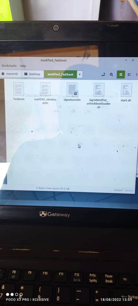

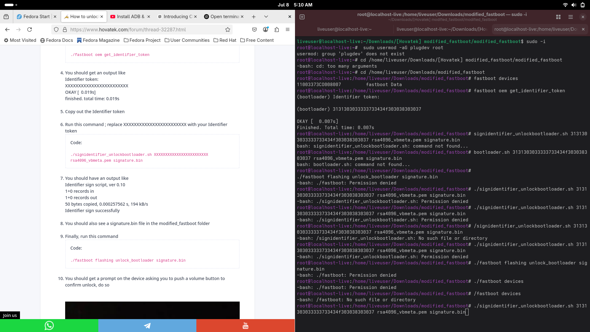

  1. Open the modified_fastboot folder, right-click then select Open in Terminal

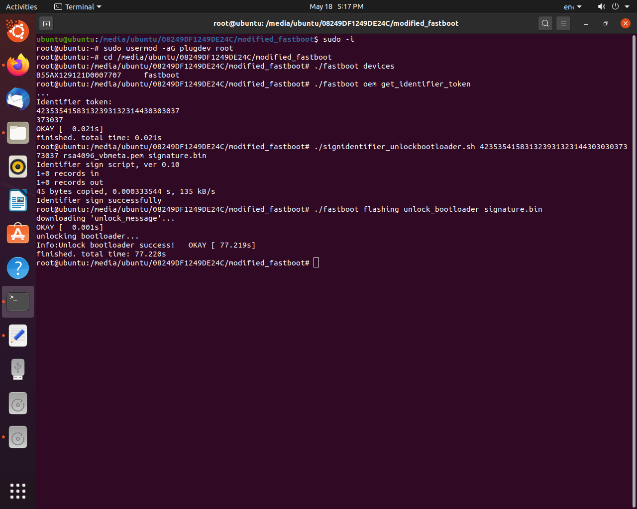

  2. Test detection using
    ./fastboot devices

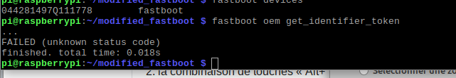

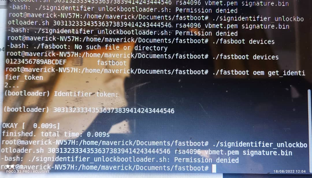

  3. Get Identifier Token using
    ./fastboot oem get_identifier_token
  4. You should get an output like
    Identifier token:
    XXXXXXXXXXXXXXXXXXXXXXXX
    OKAY [Ā  0.019s]
    finished. total time: 0.019s
  5. Copy out the Identifier token
  6. Run this command ; replace XXXXXXXXXXXXXXXXXXXXXXXX with your Identifier token
    ./signidentifier_unlockbootloader.sh XXXXXXXXXXXXXXXXXXXXXXXX rsa4096_vbmeta.pem signature.bin
  7. You should have an output like
    Identifier sign script, ver 0.10
    1+0 records in
    1+0 records out
    50 bytes copied, 0.000257562 s, 194 kB/s
    Identifier sign successfully
  8. You should also see a signature.bin file in the modified_fastboot folder

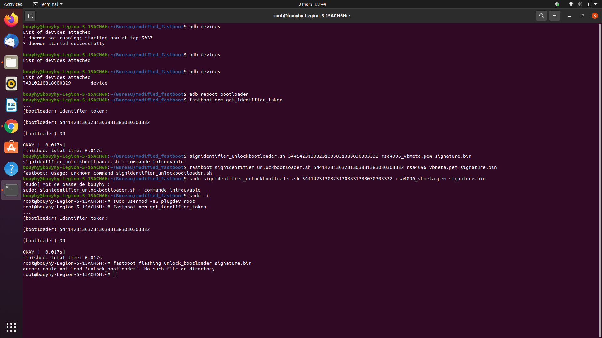

  9. Finally, run this command
    ./fastboot flashing unlock_bootloader signature.bin

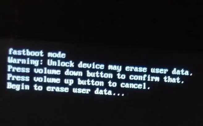

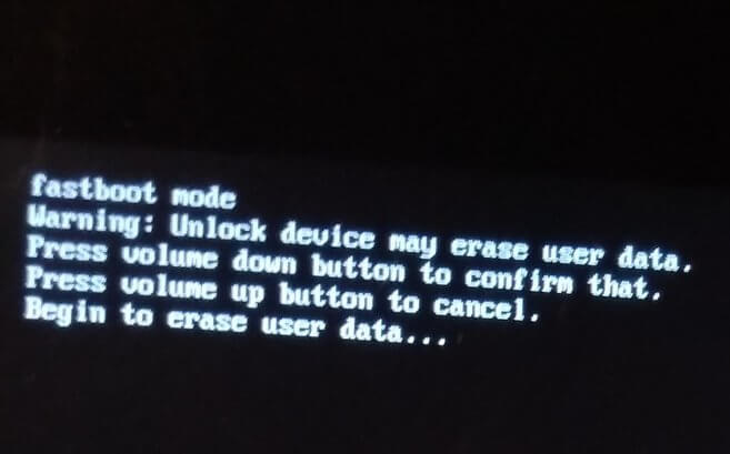

  10. You should get a prompt on the device asking you to push a volume button to confirm unlock, do so
    [Image: bootloader-unlock-confirmation.webp]
  11. You should now have an output like
    downloading 'unlock_message'...
    OKAY [Ā  0.001s]
    unlocking bootloader...
    Info:Unlock bootloader success!Ā  OKAY [ 85.787s]
    finished. total time: 85.788s
  12. Reboot the device using
    ./fastboot reboot
  13. Your bootloader should now be unlocked

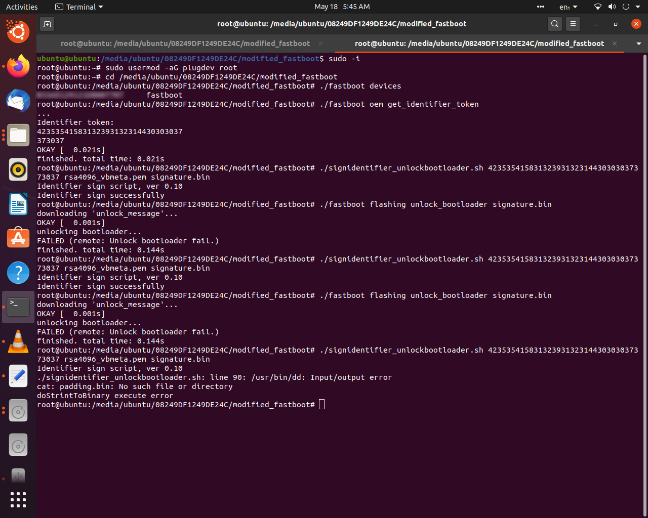

  • This guide isn't guaranteed to work on all Unisoc devices especially if they require a different private key
  • If you're still getting
    FAILED (remote: 'unknown cmd.') fastboot: error: Command failed
    Then your model must be using custom private keys, not the default one. You'll need that key to unlock the bootloader.

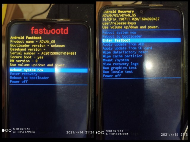

  • You can enter bootloader by first booting the device into recovery mode then selecting Reboot to Bootloader

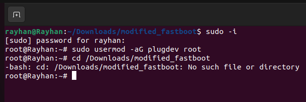

  • If you run into permission issues while running fastboot then run
    sudo -i sudo usermod -aG plugdev root
    and cd back into the fastboot folder
  • If you still encounter permission denied error then right-click the fastboot file > permissions > tick the checkbox for allow executing as a program then save and retry running a fastboot command
  • If you encounter /usr/bin/dd : input/output error, then the current folder dd has no write access to the current folder. Change the permissions of the current folder

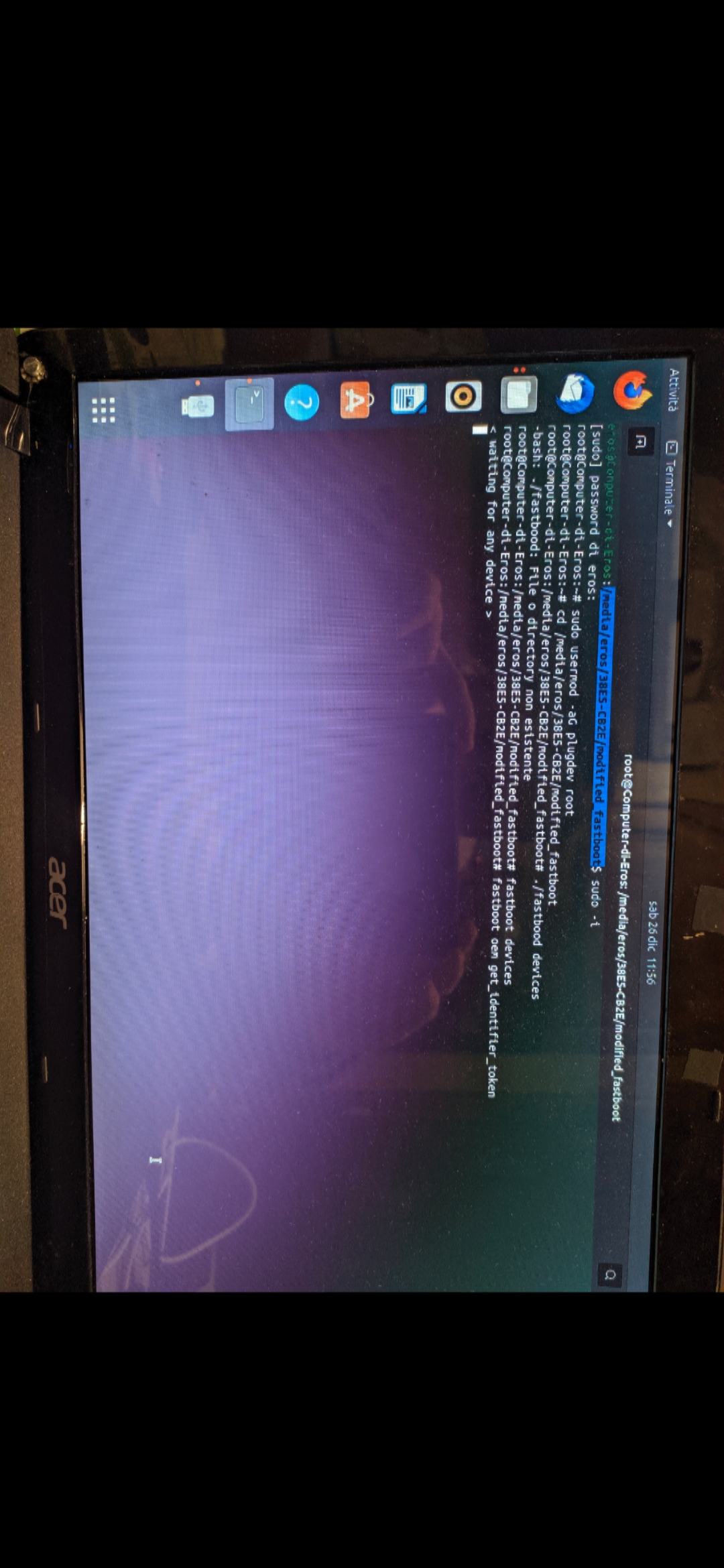

06-05-2020, 06:37 PM

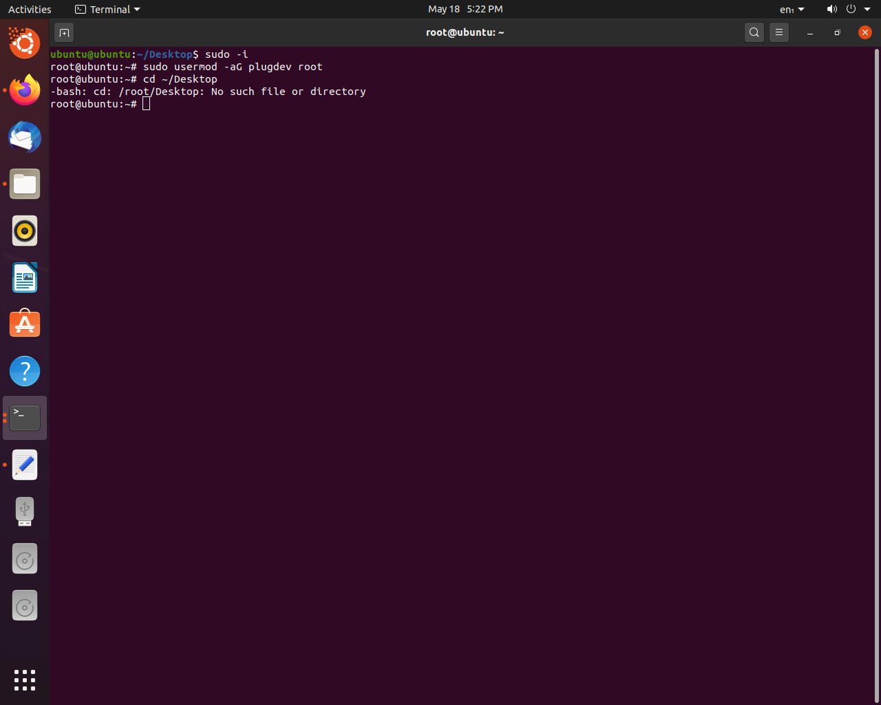

Hi, im using this guide to root teclast p80x, in my win 10 i create a usb live with ubuntu inside, it works. Now when i try t o follow the command in fastboot ( cd path) it gave an error, bash no such a file or directory.... Since im not familiar with ubuntu and since it is live version maybe do i need to install some command or libs? i repeat that im not familiar with it so plaese if you can point me some hint would be great. Thanks in advange and compliment for this site .
51,093
07-05-2020, 09:50 AM
(06-05-2020, 06:37 PM)simone Hi, im using this guide to root teclast p80x, in my win 10 i create a usb live with ubuntu inside, it works. Now when i try t o follow the command in fastboot ( cd path) it gave an error, bash no such a file or directory.... Since im not familiar with ubuntu and since it is live version maybe do i need to install some command or libs? i repeat that im not familiar with it so plaese if you can point me some hint would be great. Thanks in advange and compliment for this site .
create a new thread for your device issue by clicking "ask question" at the topĀ and also attach a full screenshot of the error
you can upload your screenshot to imgur.com then post the link in your new thread
This post was last modified: 07-05-2020, 09:51 AM by X3non.
