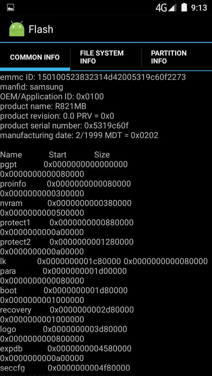

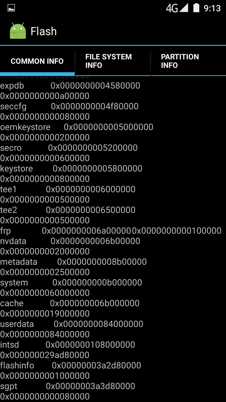

Dear all,
So when I was working on my phone I made a scatter file myself based upon an existing scatter file from another MTK 6735 phone and the EMMC information I got from the phone itself.
The only differences were at 'the end' of the file; I suppose because of the different partition sizes.
Most importantly, the recovery.img size and postion on EMMC memory corresponded with that from the other phone.
So I used my own created scatter file to download the recovery.img from my phone and I posted that on this thread above - together with the scatter file.
Then, based on that recovery.img file, Hovatek was so nice to create a TWRP recovery file and posted that in this thread as well, together with the scatter file and the root.zip file.
So, I fired up SPflashtools, and loaded the scatter file that Hovatek posted and ... error message... what the H@77?? How was that possible? I then used my own scatter file again... again error message.... now I was really frustrated.
Basically I went back to the drawing board. I loaded the scatter file from the other phone (I thought it was a Mlais).
That worked, but of course the end of the file (from partition index: SYS21) was different. So I did not want to run the risk to ruin anything, so I took notepad++ and carefully only changed the address items from my original T200 scatter file and copied these over the address items in the other phones scatter file.
Essentially I did everything again by creating another scatter file.
Then saved as MT6735_Android_scatter_T200_2.txt and loaded into SPflashtools and ... success, no errors.
I immediately used that opportunity to flash the TWRP recovery.img from Hovatek and the rest is history.
That is my story how things went.
Now, while writing this post, I just loaded SPflashtool on a different computer. I loaded the MT6735_Android_scatter_T200_2.txt file (the latest one I created and used to flash TWRP) and no problem for me at the moment. I would use that again to flash.
So I have attached some files.
1) the MT6735_Android_scatter_T200_2.txt file I used to flash the TWRP recovery
2) The Mlais scatter file I used as imput
3) the EMMC memory positions information I used to create my own scatter file - note that only from partition index: SYS21 these scatter files are different.
Any remaining questions - let me know!
