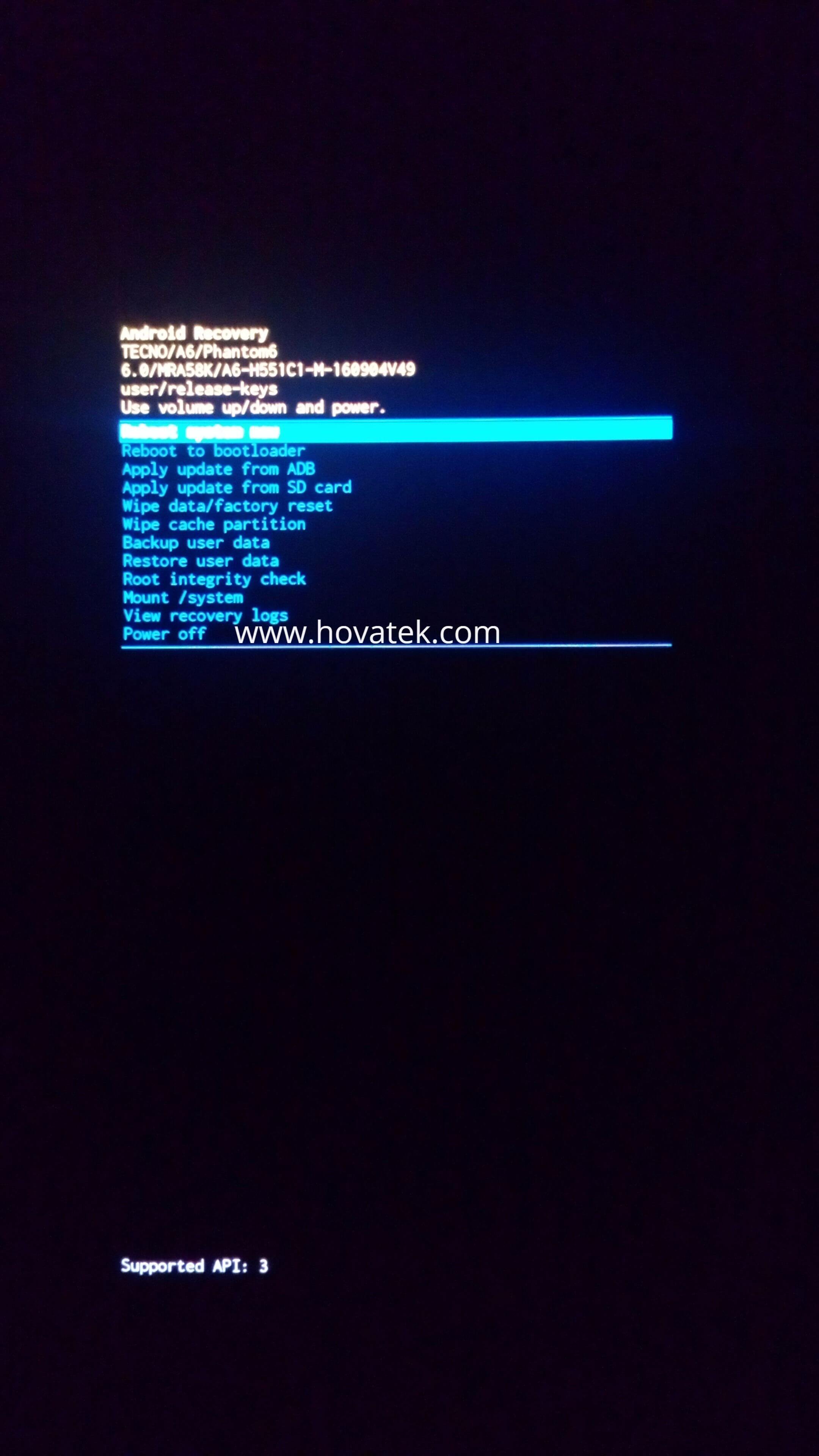

To boot into stock recovery mode on the Tecno Phantom 6 (A6) :
Power off the phone
Hold the Volume increase button and do not release
Hold the Power button and keep holding both buttons
Release both buttons at the same time immediately a white "TECNO" appears
You should now see the HIOS icon with a red warning sign and No Command written at the bottom
While in No Command mode, Hold the Power button first then the Volume increase button and then release both (at the same time) immediately
The Tecno Phantom 6 should now be in stock recovery
In stock recovery, you navigate using the Volume buttons and select using the Power button
