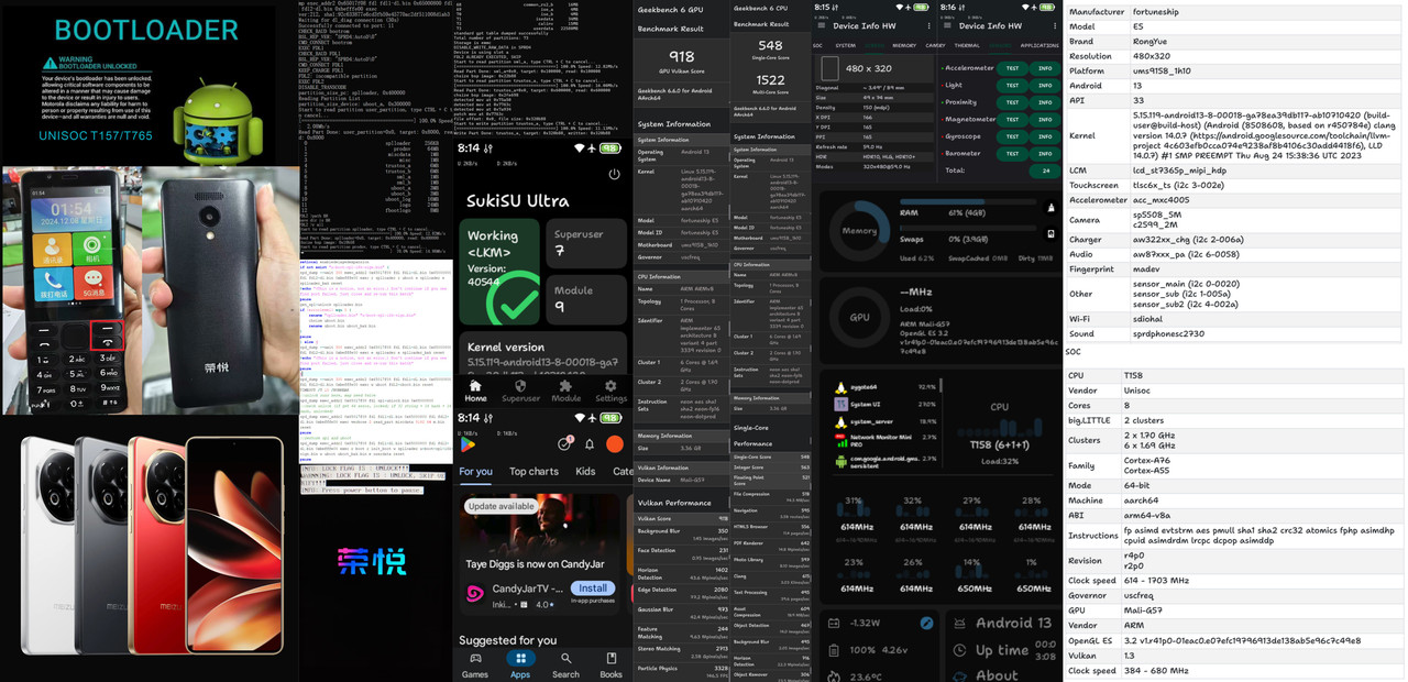

[Image: 001.jpg]
Introduction
Hello Hovatek community. I am sharing a complete guide and toolset for the Unisoc T158 (ums9158_1h10) platform. This research was conducted on the RongYue E5 (T9 industrial device), but the files and logic are confirmed to work on the Meizu Note 16 and other devices sharing this 6nm chipset architecture.
Platform Specs:
  • SoC: Unisoc T158 (6nm, A76+A55 cores)
  • OS: Android 13 + Kernel 5.15 (GKI)
  • Root Method: KernelSU (recommended)
⚠️ WARNING & DISCLAIMER
  • Exploiting BROM carries a High Risk of Hard Bricking.
  • NEVER skip Step 1 (Backup).
  • I am sharing this for educational purposes. Use your brain and proceed at your own risk.
Pre-requisites
  1. Drivers: Unisoc Drivers | mirror link
  2. Unlock Toolset: Unisoc T158 Unlock Tool | mirror link
  3. ADB/Fastboot Tools:  ADB Fastboot and USB driver installer tool
‼️ How to Enter BROM Mode for Meizu Note 16
  1. Power Off: Completely shut down the device.
  2. Button Combination: Press and hold Volume Down + Power buttons simultaneously for about 3 seconds.
  3. Connect USB: While holding the buttons, connect the phone to your PC via a high-quality USB cable.
  4. Verification: You should hear the Windows USB connection sound. The screen must remain BLACK.
    • Note: This is the Unisoc Deep Flash Mode (BROM), similar to Qualcomm's EDL/9008 mode. It is NOT Fastboot mode.
‼️ SPECIAL NOTE ON BOOT MODES (RongYue E5)
On the RongYue E5, hardware button combinations ONLY work for BROM mode.
  • BROM Mode: Power + Back button.
  • Fastboot/Recovery: There are NO hardware button combos to enter these modes. You must use ADB commands while the device is powered on:
    • Enter Fastboot: adb reboot bootloader
    • Enter Recovery: adb reboot recovery
      Plan accordingly and ensure USB Debugging is enabled before you start!
Step 1: Full BROM Backup (Mandatory)
Dump all partitions first to avoid losing NV/IMEI data.
  • Entry: Power + Back (catch the port within 5-10s).
codeBash
spd_dump exec_addr2 0x65017f08 fdl fdl1-dl.bin 0x65000800 fdl fdl2-dl.bin 0xbefffe00 exec path BR r all reset
Step 2: Automated Bootloader Unlock
Extract the Unlock Toolset and run unlock_autopatch_9621.bat as Administrator.
Interaction Guide:
The script will pause for manual confirmation. Watch the console:
  1. Prompt y: Type y and press Enter.
  2. Prompt yes: Type yes and press Enter.
  3. Instruction to reconnect: Disconnect, force power off, and reconnect in BROM mode, then press Enter.
Verification: Successful exploit will show this on the device screen:
codeText
INFO: LOCK FLAG IS : UNLOCK!!!
WARNING: LOCK FLAG IS : UNLOCK, SKIP VERIFY!!!
Step 3: Disable AVB (Verified Boot)
Run this in FDL2 mode via spd_dump:
codeBash
spd_dump exec_addr2 0x65017f08 fdl fdl1-dl.bin 0x65000800 fdl fdl2-dl.bin 0xbefffe00 exec verity 0 reset
Step 4: Rooting via KernelSU
  1. Since you can't use buttons, use adb reboot bootloader to enter Fastboot.
  2. Patch your init_boot.img (from Step 1 backup) using the KernelSU App.
  3. Flash via Fastboot:
codeBash
fastboot flash init_boot <patched_image>.img
  1. Reboot. Done!
