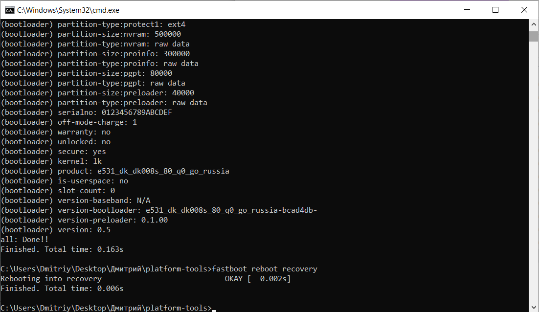

One day I wanted to flash TWRP Recovery, unlocked the bootloader, flashed the twrp.img file (supported by the phone) into the RECOVERY section, rebooted - and the phone couldn't even turn on...
I tried flashing through the SP Flash Tool, MTK Droid Tools, MTKClient, Miracle Box - the same super-sign.img doesn't work in any way (2.3GB) of suitable firmware (BV5500_S2_210611), suitable preloader (e531_dk_dk008s...)
What do I need to do to at least sign and flash twrp.img?

SP Flash Tool: error 3154 "S_DA_SDMMC"
MTKClient: error unknown
"Disable dm-verity before flashing the TWRP?" Yes(maybe, I haven`t a root...)
"Disable dm-verity before flashing the TWRP?" Yes(maybe, I haven`t a root, custom signed vbmeta.img didn`t work)
ASSAYYED KITCHEN killed my Win10 Pro on VM
Try SP flash tool alone and the fixes for Error 3154 @ https://www.hovatek.com/forum/thread-439.html
I tried - flashed all, but super-sign.img - "S_DA_SDMMC_WRITE_FAILED"
Maybe, may i try to flash zip from stock recovery, but... How to sign zip file? I have a PEM key from "otacerts.zip" and CER file, generated from OpenSSL

Yeah, booted up
"boot - logo - bootloader"
