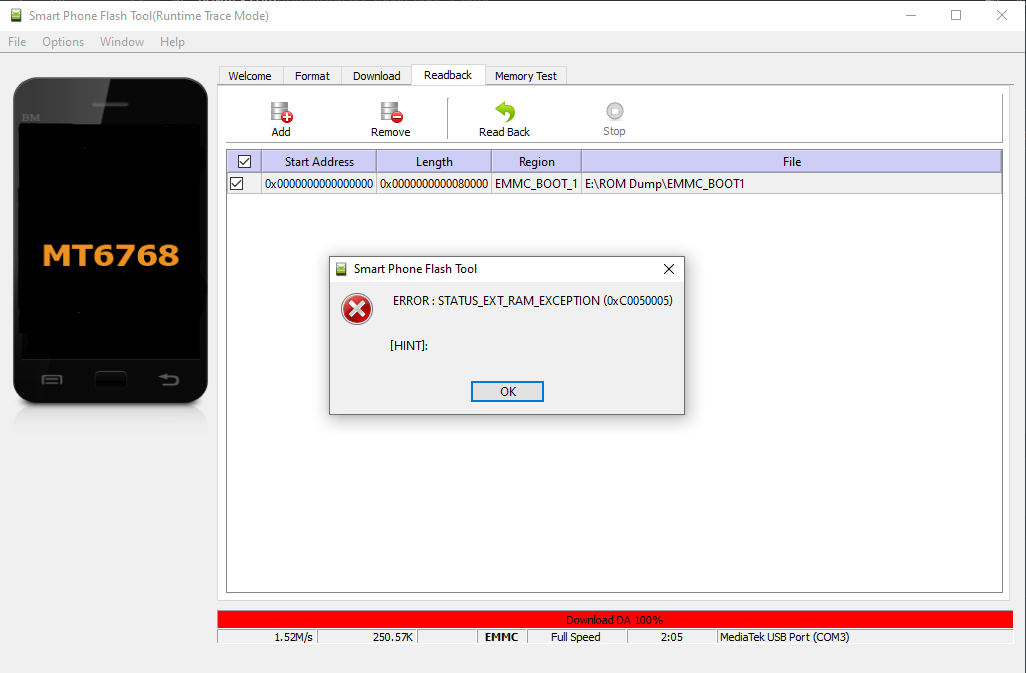

Followed the guide but got stuck at Download DA 100% and after 2minutes it shows ERROR STATUS_EXT_RAM_EXCEPTION . Tried searching for solutions and found that I should try different Fastboot ROM or DA or scatter file. Downloaded and tried with 4 different ROMs, both Global and EU and both MIUI 11 and 12 (if its needed I will write exact version but right now I wont as it will be long for thread). No success still showed  ERROR STATUS_EXT_RAM_EXCEPTION.

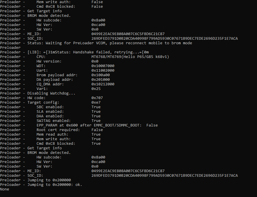

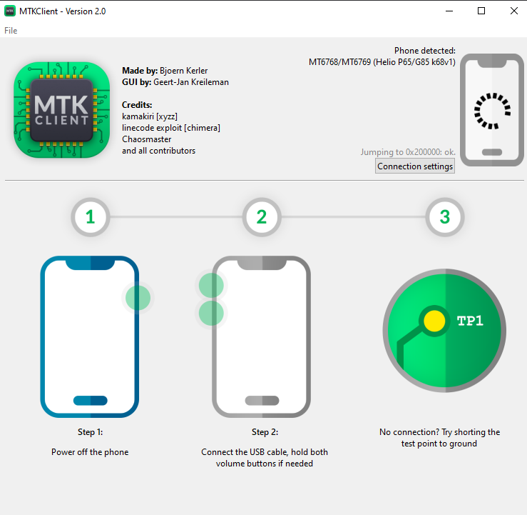

After setting up mtkclient gui got this
and
At the end it showed None. I waited for like 5-10 minutes but nothing happened so I closed mtkclient. Should I waited longer?

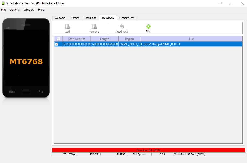

Tried that but got this error in Capture2.
Checked also that scatter is in txt format and it was.

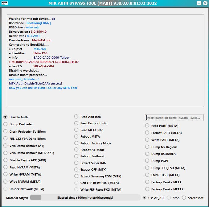

Before clicking Readback I used MTK Auth bypass, also tried without using bypass but nothing happened in SP Flash tool after clicking readback, just phone connecting/disconnecting.

Don't see attachment so I will write error here: ERROR: STATUS_PRELOADER_INVALID 0xC0030004.
Tried every solution from here https://www.hovatek.com/forum/thread-439.html and still got same error.
Also copied text from scatter file in official fastboot ROM to scatter from WWR to match same text for preloader but still got same error.
Tried using scatter from official rom but then its stuck at Download DA 100%.

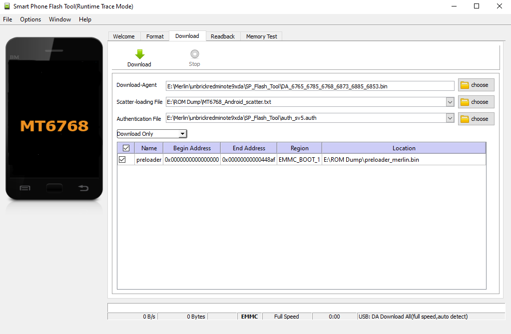

In the Download section, you also need to load the preloader.bin from firmware even to do a read back or dump. Did you do that?

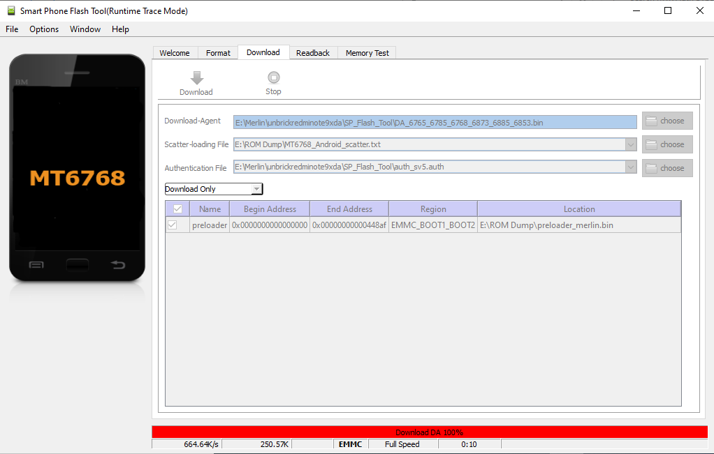

Copied preloader_merlin.bin file from V12.5.4.0.RJOMIXM fastboot rom image but got stuck at Download DA 100%. Used UART connection setting with baud rate 921600.
Then also tried with connection setting USB with Full speed and auto detect. Also got stuck.
One thing I noticed in tutorial is that it shows MediaTek PreLoader USB VCOM (Android) (COM43), while
here it just shows MediaTek USB Port (COM6).
Installed VCOM drivers using  auto installer form this post https://www.hovatek.com/forum/thread-16640.html
After downloading installer it shows 2016 as date, could drivers be outdated as Redmi Note 9 is phone from 2020.
Maybe that is the reason it doesn't show MediaTek PreLoader USB VCOM and it's stuck at Download DA 100%. Just a guess.
Thank you for using your time to help.
