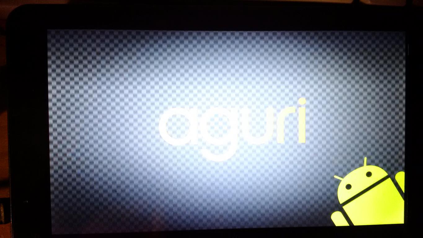

The tablet from Aguri (see aguriworld.com) won´t start any more, but stays in a kind of preboot either with Android screen (prior to recovery) or back light illuminated dark screen. When plugged into PC-USB the device is recognized instantly by Mediatek VCOM Drivers, but is only ever shown as "not connected".
I had no intention of changing ROM or Recovery, the bootloader is still locked. I did root it though with KingoRoot, then disabled several apps. As far as I remember I have not deleted anything but disabled only and I guess that I might have disable a system app. That is why I am rather sure that if I got it into a mode of ADB recognition, things would change immediately when those Apps that I thought were dispensable are reenabled.
I have done a lot of reading and trying, and now and then I do have a second device that I think is identical (navigational fleet equipment). But until now everything has been either a dead end or for me way out of my comfort zone, fearing to do more harm than good. I am asking for ideas and guidance ...
The tablet has ONE button for powering on/off manually. Volume is changed software sided only. On second device I have not found any way of booting into bootloader, not even by ADB. I have not found any other means of booting into recovery then by ADB, but then to stay on screen with green Adroid and red triangle Warning.
Both tablets cannot stay off when charging. And I have no idea how to open it, but I will cross that bridge when I come to it...

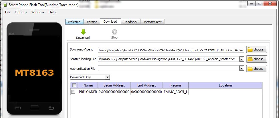

I followed your tutorial for Wwr_MTK (second Device):
#########################################__WwR_MTK_2.50__###################################################
#  General Setting
- general: MTK_PLATFORM_CFG
  info:
    - config_version: V1.1.2
      platform: MT8163
      project: WwR_Testing
      storage: EMMC
      boot_channel: MSDC_0
      block_size: 0x20000
#  Layout Setting
- partition_index: SYS0
  partition_name: PRELOADER
  file_name: preloader.bin
  is_download: true
  type: SV5_BL_BIN
  linear_start_addr: 0x0
  physical_start_addr: 0x0
  partition_size: 0x80000
  region: EMMC_BOOT_1
  storage: HW_STORAGE_EMMC
  boundary_check: true
  is_reserved: false
  operation_type: BOOTLOADERS
  reserve: 0x00
If there IS a preloader, then why is it not listed in above scatter information? Huh
Using that file in SP_Flash_Tool_v5.2112:
is first fine:
...and then doesn´t fit anymore:

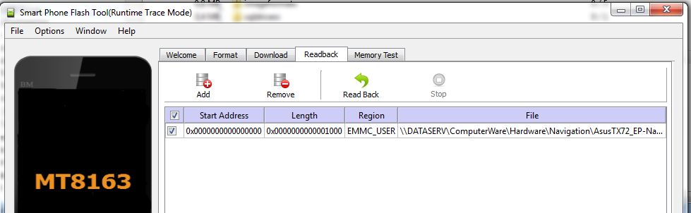

Your first step should be to backup the bricked phone, this should come before anything else
1. Install VCOM drivers https://www.hovatek.com/forum/thread-440.html
2. You said your device shows up as Mediatek VCOM Drivers. Update this (by selecting the same driver as step 1) following https://www.hovatek.com/forum/thread-16839.html
3. Do a full dump of the bricked device https://youtu.be/pj4iFakq33M
4. Once you have the dump, the ONLY partition you will be tinkering with is system but do the backup first
Note: readback / backup only copies the firmware to your PC, it doesn't write to the device
follow that video

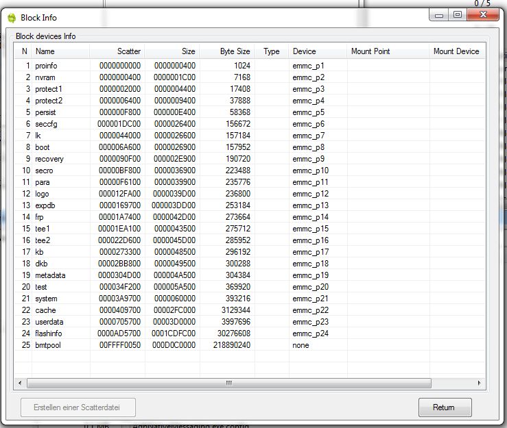

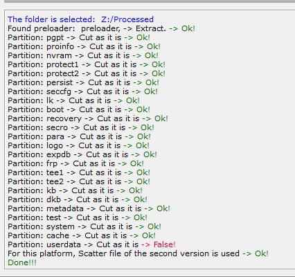

Nevertheless, I proceeded with taking the dumps and followed the video to the letter, except taking a full dump and instead leaving out partitions.
Last, I used "Create scatter file" and "Cut Rom as it is".
There wasn´t enough disk space for userdata but I take it, that it will not be needed?
How to proceed now, please?

I followed directions in driver installation tutorials and my System (Windows 7x64 Pro workstation) does not behave as wanted. Device Manager is not willing to show device or Driver.
Format ONLY userdata and cache with https://www.hovatek.com/forum/thread-21638.html and try boot up.
If it still doesn't boot, use this tool and boot.img+system.img to unpack system.img. Don't repack yet

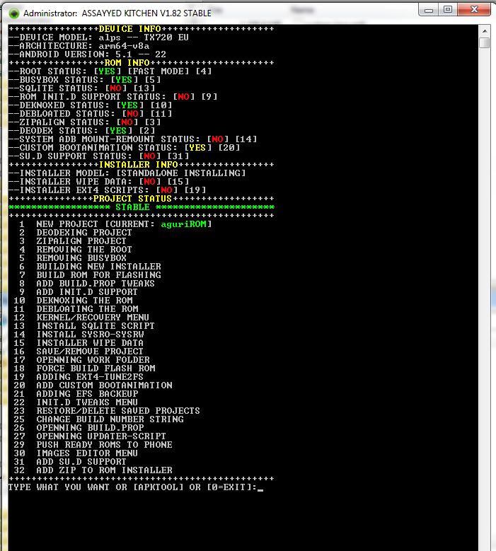

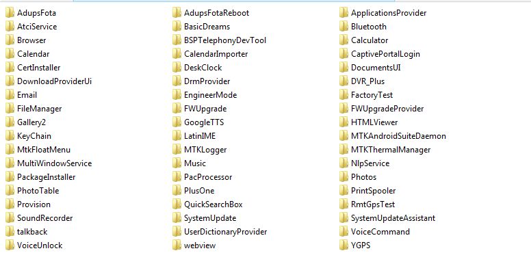

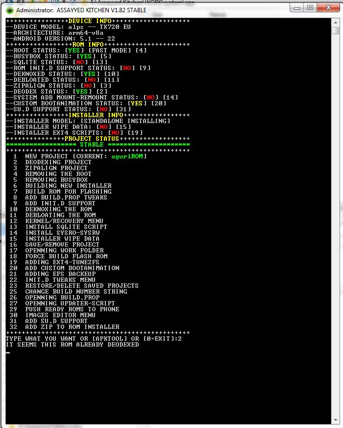

Quote:If it still doesn't boot, use this tool and boot.img+system.img to unpack system.img. Don't repack yet
https://www.hovatek.com/forum/thread-20497.html
These instructions gave the following output. Hopefully they are as they should be:
Note: there is no custom recovery installed as the tutorial says it necessary to be, bootloader is locked.

(01-09-2023, 09:26 PM)lijubu These instructions gave the following output. Hopefully they are as they should be:
( * ^ *) ノシ
Try to unlock bootloader with this https://www.hovatek.com/forum/thread-40300.html
let me know how it goes before we continue with assayyed

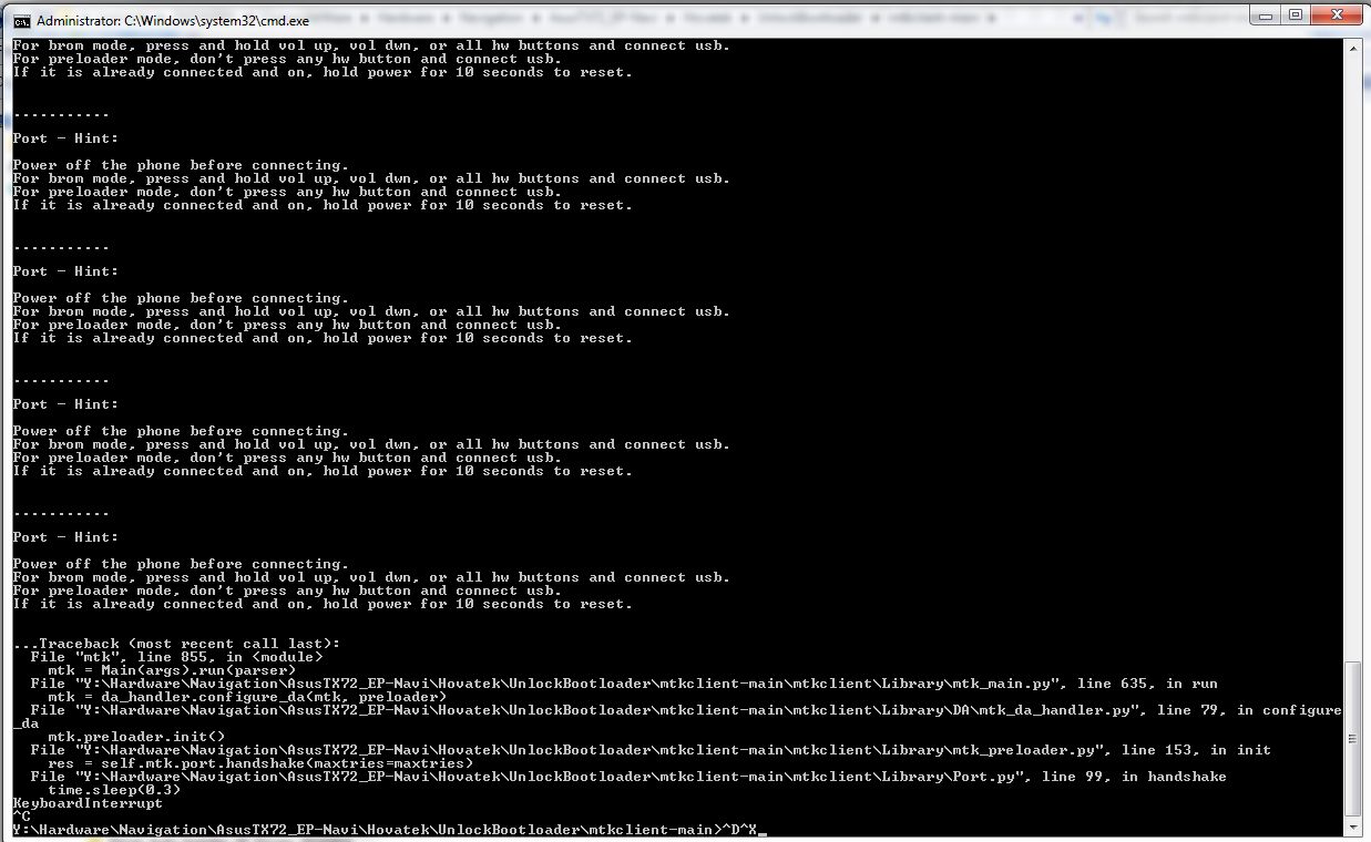

I will try MTKClient on weekend.
But I already am wondering about entering BRom mode. I have one button only, Power on/off....
So how enter that mode without buttons?
Huh
lijubu
lijubu
lijubu
9
11-09-2023, 06:58 PM
Hello,
I have not been able to make it work.   Sad
No matter what I do and how:
Connection in power off or on while pressing Power button or not for whatever length of time...
MTKClient keeps repeating the Port Hint Cycle until Keyboard interruption.
