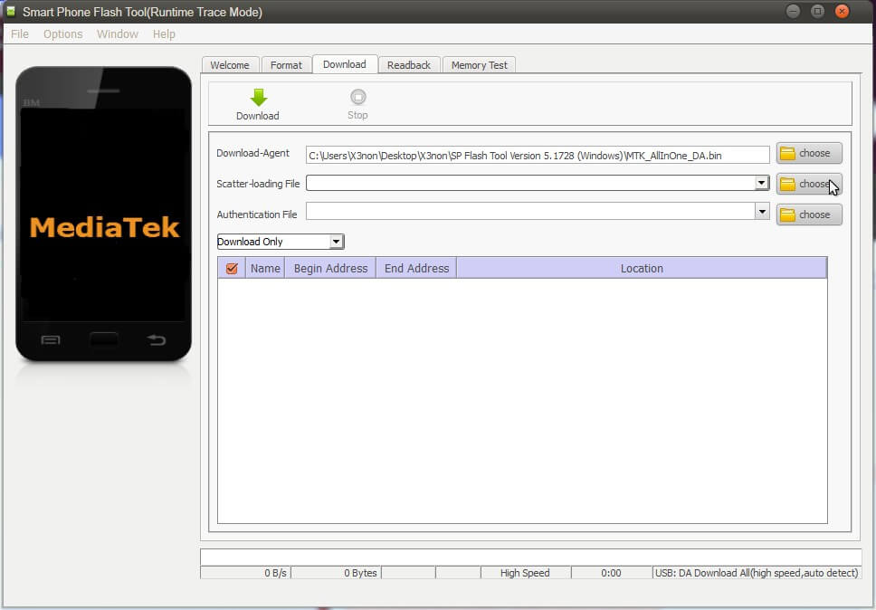

  2. Select the scatter file for your device by clicking choose beside the scatter-loading file's dropdown bar
    [Image: How-to-Format-a-Single-Partition-of-a-Me...Tool-2.jpg]

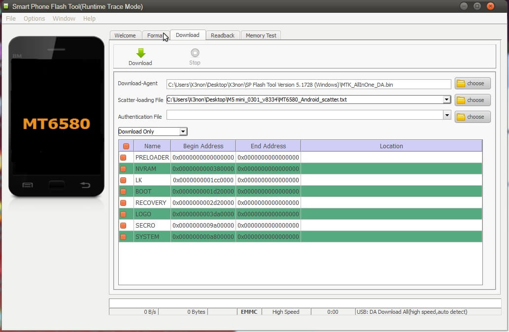

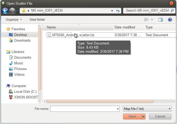

  3. In the windows that appears next, navigate to and select the scatter file
    [Image: How-to-Format-a-Single-Partition-of-a-Me...Tool-3.jpg]
  4. You should now be taken back to SP flash tool window, Click on the Format tab
    [Image: How-to-Format-a-Single-Partition-of-a-Me...Tool-4.jpg]

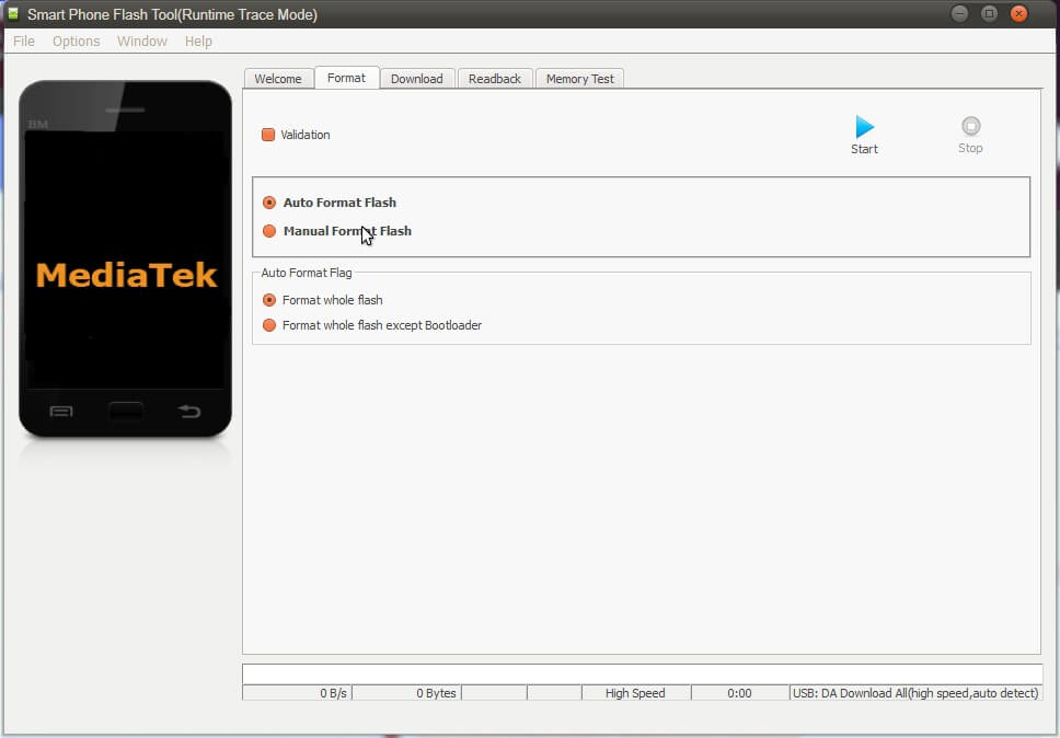

  5. Tick the checkbox beside "Manual format flash"
    [Image: How-to-Format-a-Single-Partition-of-a-Me...Tool-5.jpg]

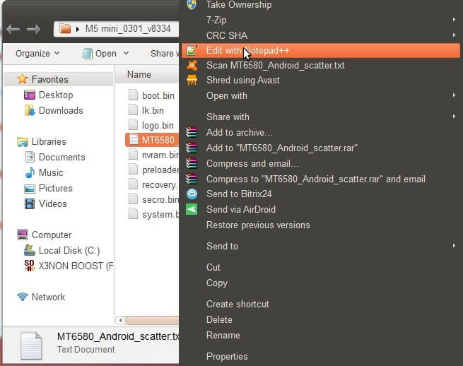

  6. Open windows explore and navigate to the location of the scatter file you selected earlier on then open it using Notepad++
    [Image: How-to-Format-a-Single-Partition-of-a-Me...Tool-6.jpg]

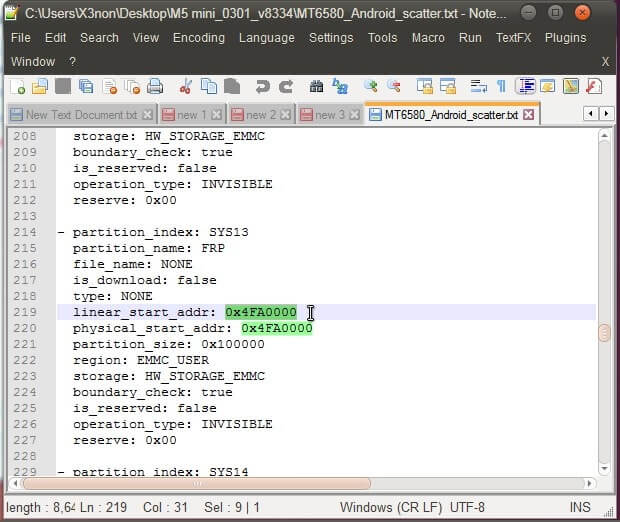

  7. Scroll down the contents of the scatter file till you get to the partition you wish to format [in my case, i'm trying to format FRP partition]
    [Image: How-to-Format-a-Single-Partition-of-a-Me...Tool-7.jpg]

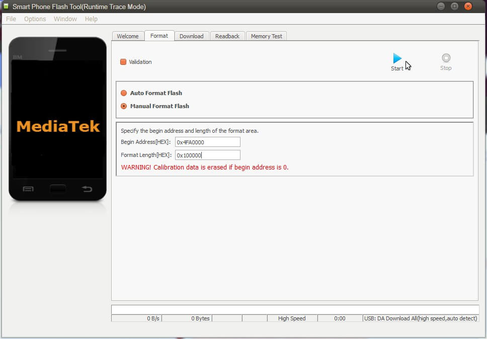

  8. Input the values of Linear_start addr and partition_size into SP flash tool then Click on Start
    Linear_start addr = Begin Address partition_size  = Format Length

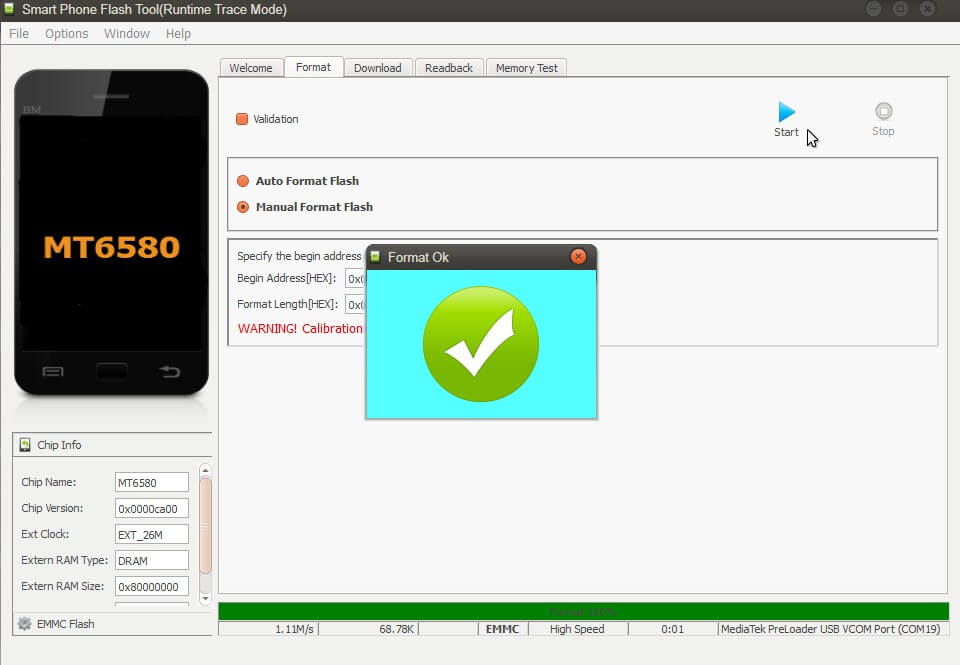

    [Image: How-to-Format-a-Single-Partition-of-a-Me...Tool-8.jpg]
  9. Power off the phone (with battery in) then connect to the PC via a USB cord. Once successful, you should get a green tick
    [Image: How-to-Format-a-Single-Partition-of-a-Me...Tool-9.jpg]
