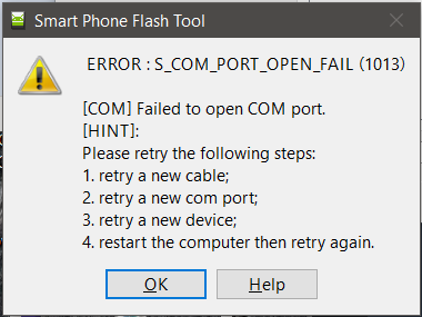

Error - S_COM_PORT_OPEN_FAIL (1013) - on Windows 10 2004 x64

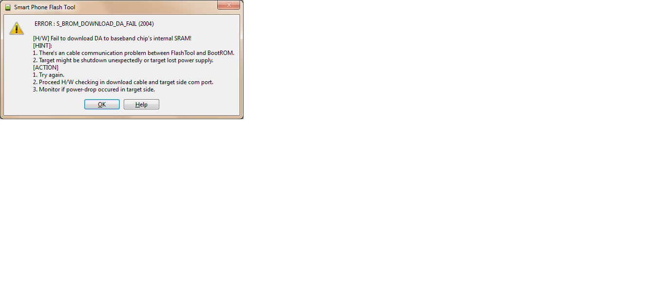

Error - S_BROM_DOWNLOAD_DA_FAIL (2004) - on Windows 7 (SP1, I think) x86

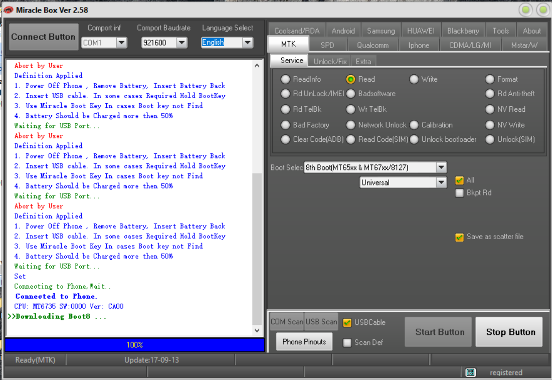

All right. Forgot you asked that I use Miracle Thunder v2.82; Box v2.58 failed, crashing every time it starts reading something, and phone starts.
I have to take out battery, try things with it out of the picture later on. I'm beginning to think it's a factor in the failure of these tools making a successful backup.

Result of Miracle Thunder v2.82: Nothing differs with the circumstances in Miracle Box v2.58, except that Miracle Thunder doesn't crash after it starts my phone, where Miracle Box would crash a few seconds after notification sound of phone being connected to PC.
