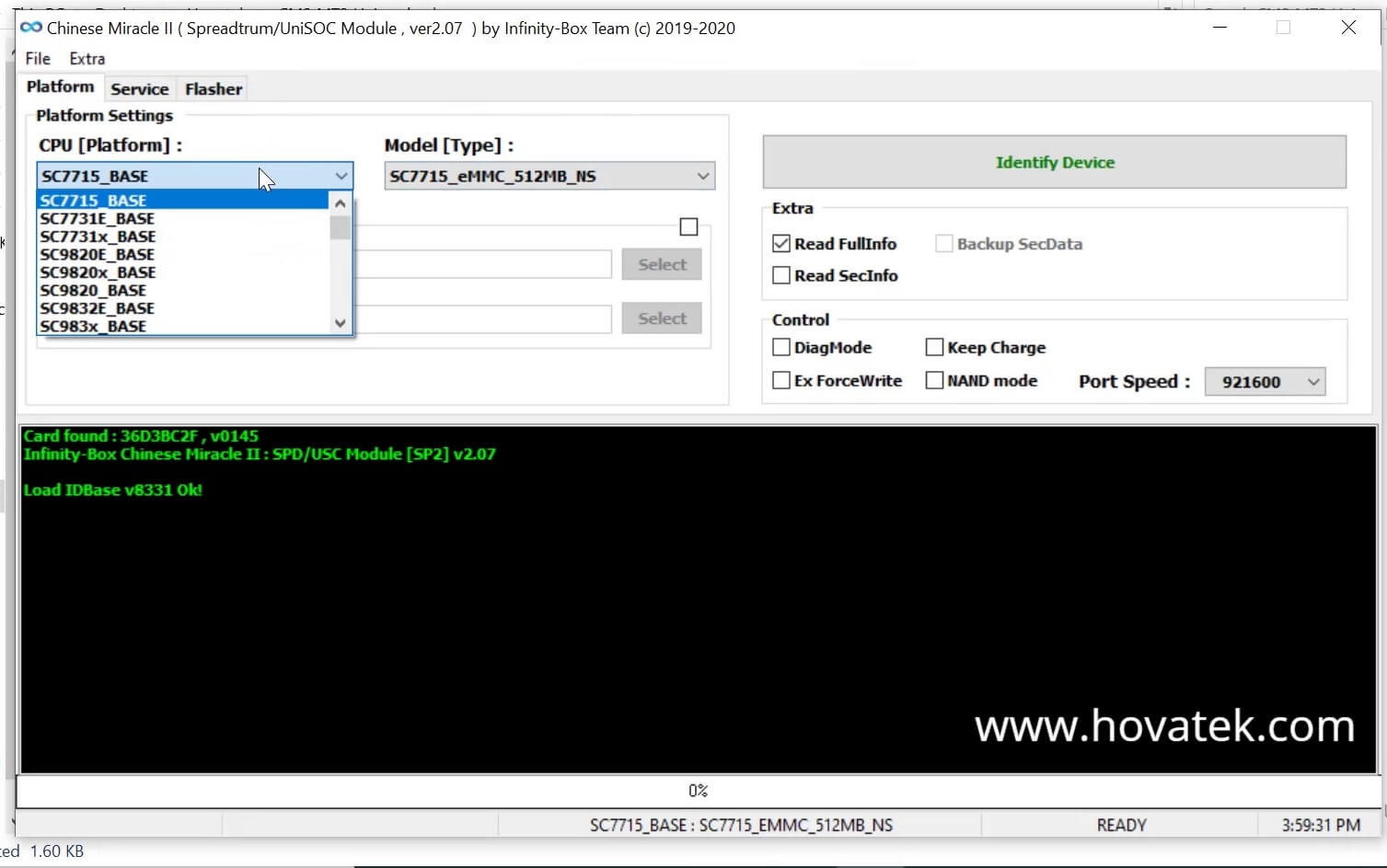

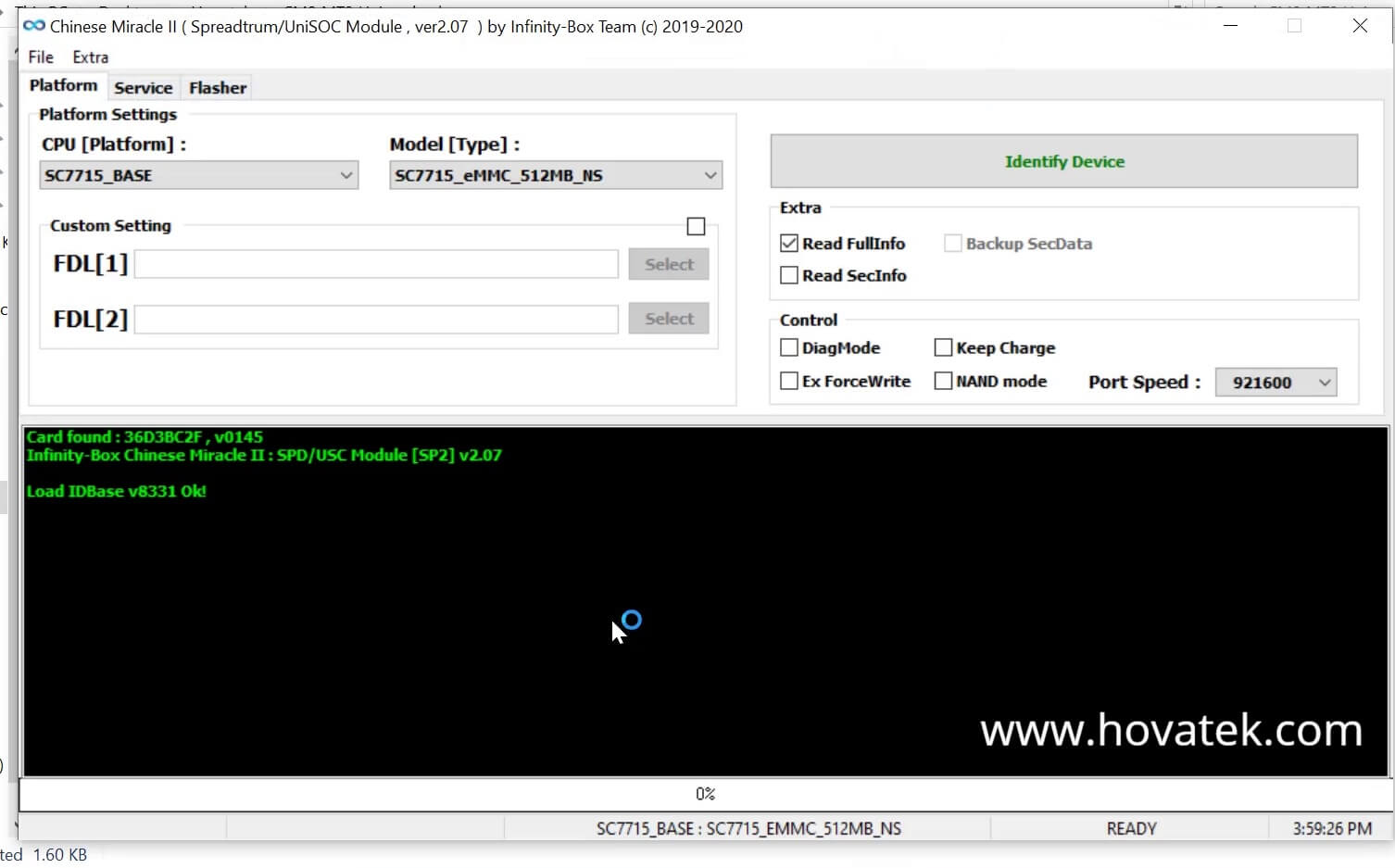

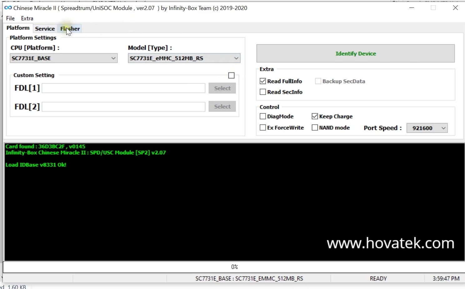

  3. Select the CPU
    [Image: How-to-use-Infinity-CM2SP2-to-backup-Uni...ware-3.jpg]

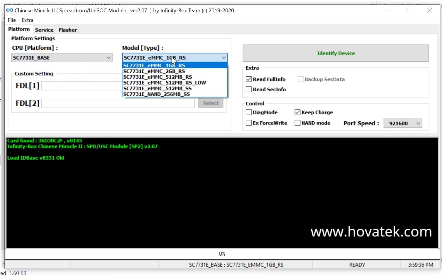

  4. Select the Model
    [Image: How-to-use-Infinity-CM2SP2-to-backup-Uni...ware-4.jpg]
  5. Click the Flasher tab
    [Image: How-to-use-Infinity-CM2SP2-to-backup-Uni...ware-5.jpg]

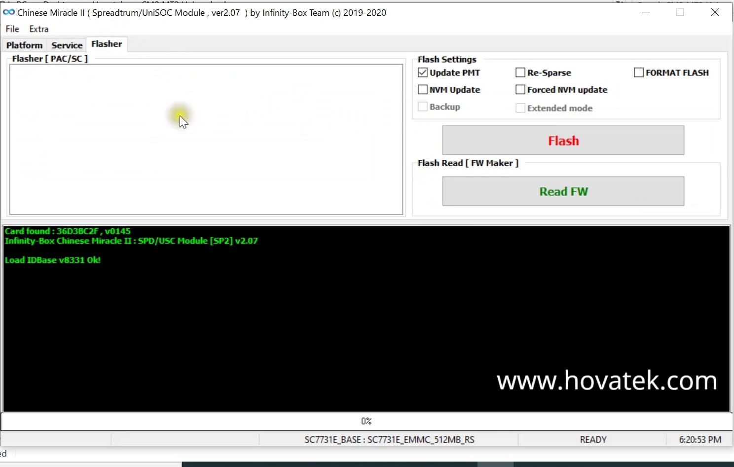

  6. Double-click the space below Pac/Sc
    [Image: How-to-use-Infinity-CM2SP2-to-flash-Unis...ware-1.jpg]

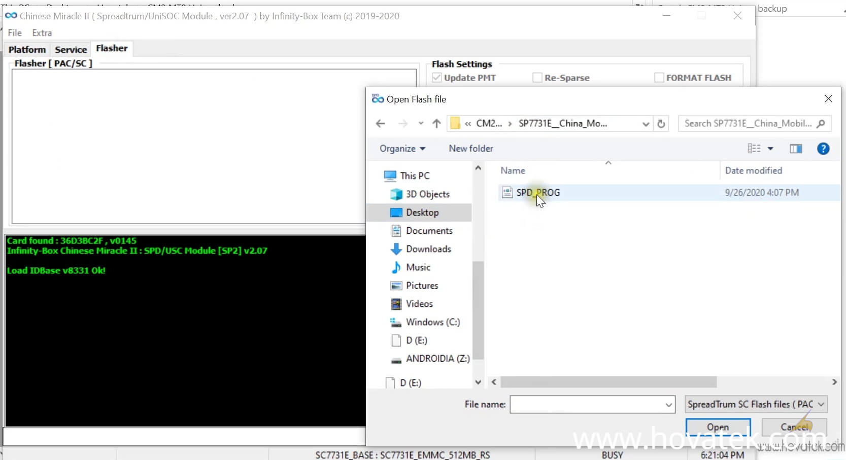

  7. In the window that pops up, select the file you intend to flash (pac, bin or SPD_PROG)
    [Image: How-to-use-Infinity-CM2SP2-to-flash-Unis...ware-2.jpg]

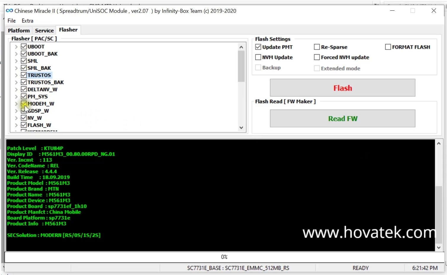

  9. Check / Tick boxes of the files / partitions you wish to flash
    [Image: How-to-use-Infinity-CM2SP2-to-flash-Unis...ware-4.jpg]

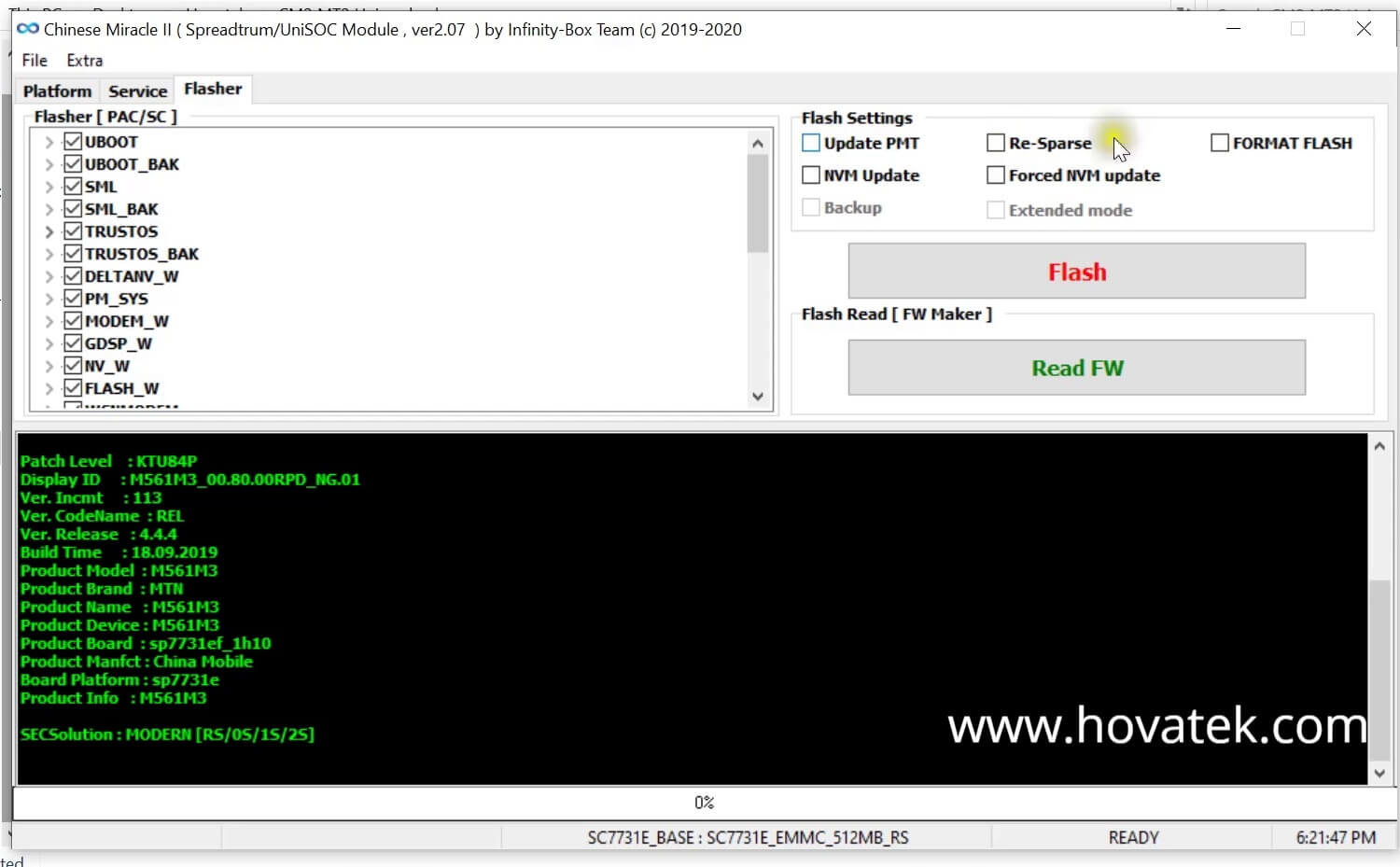

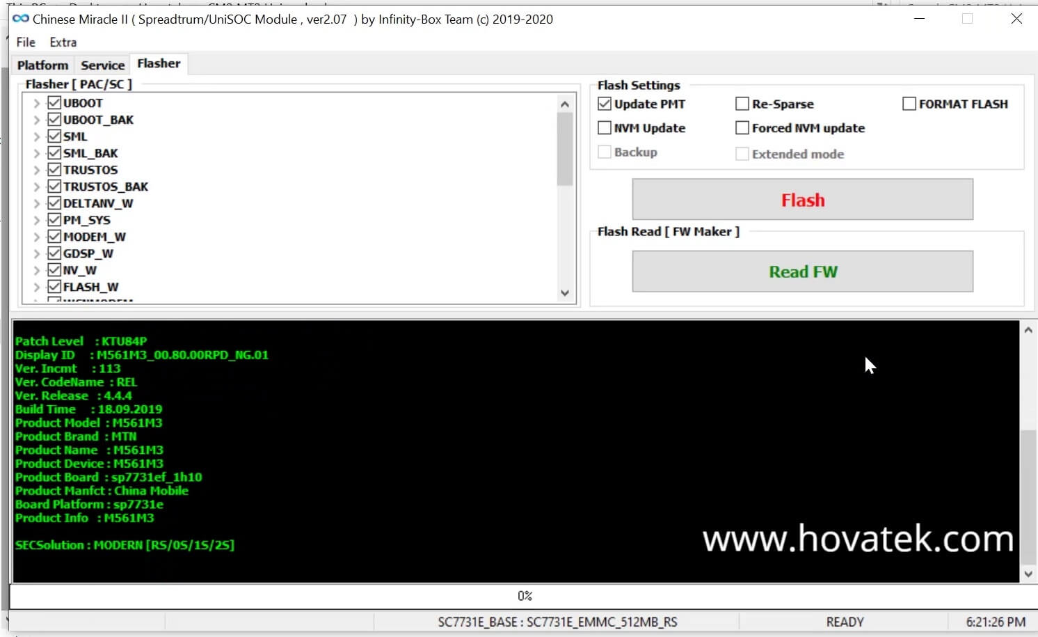

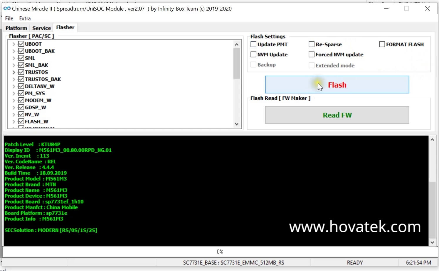

  10. Under Flash Settings, tick boxes based on your goal. Leave all unchecked if you're uncertain what to check / tick
    [Image: How-to-use-Infinity-CM2SP2-to-flash-Unis...ware-5.jpg]

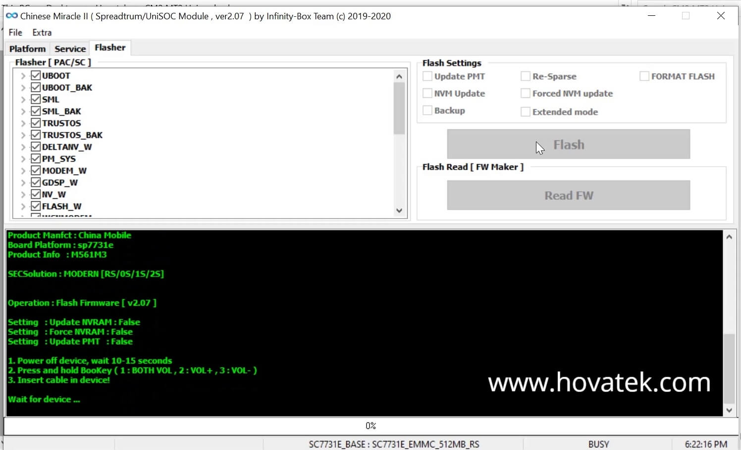

  11. Click Flash
    [Image: How-to-use-Infinity-CM2SP2-to-flash-Unis...ware-6.jpg]

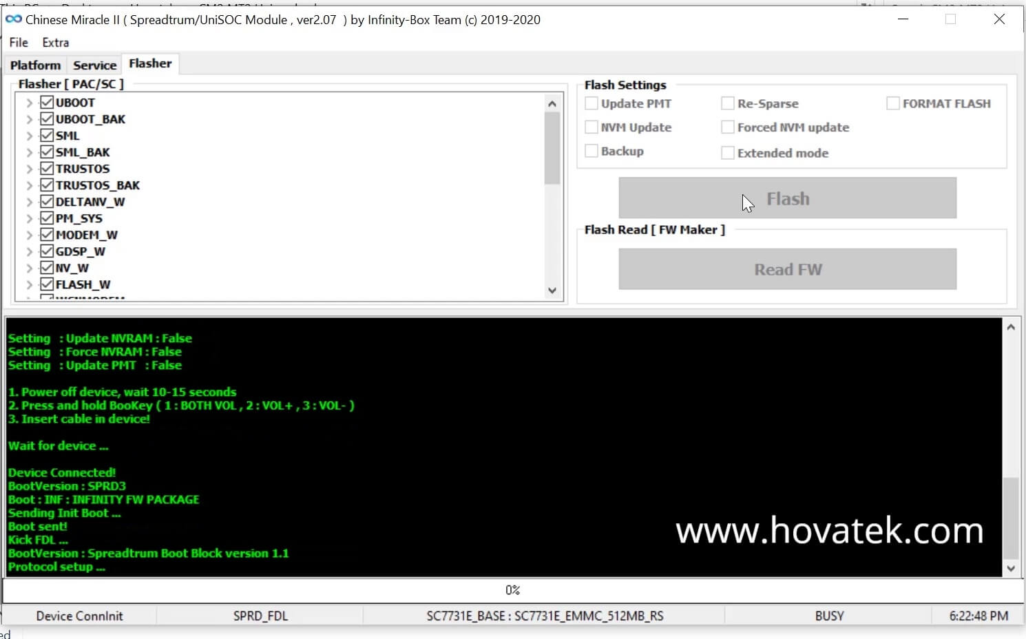

  12. Once you see Wait for device, power off the device, hold the boot key (usually volume down on smartphones and one of the keys on feature phones) then connect to PC via USB cable
    [Image: How-to-use-Infinity-CM2SP2-to-flash-Unis...ware-7.jpg]
  13. The device should get detected
    [Image: How-to-use-Infinity-CM2SP2-to-flash-Unis...ware-8.jpg]

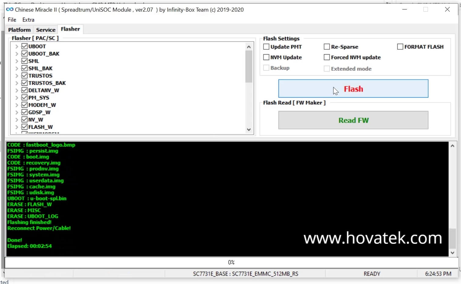

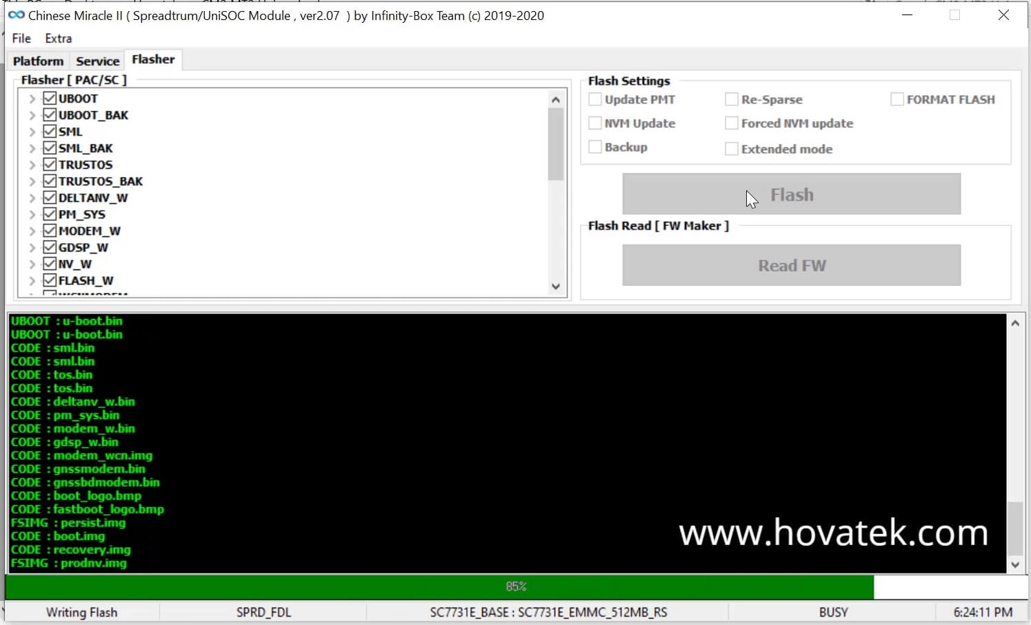

  14. Flashing should begin
    [Image: How-to-use-Infinity-CM2SP2-to-flash-Unis...ware-9.jpg]
  15. You should see a Done message once flashing is complete. Disconnect and power up the device.
    [Image: How-to-use-Infinity-CM2SP2-to-flash-Unis...are-10.jpg]
