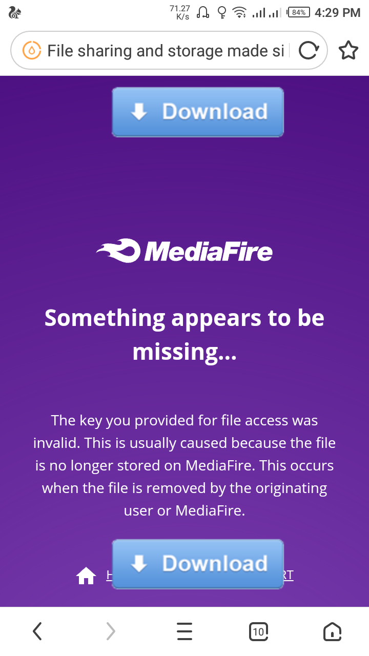

Attached is the error message on mediafire

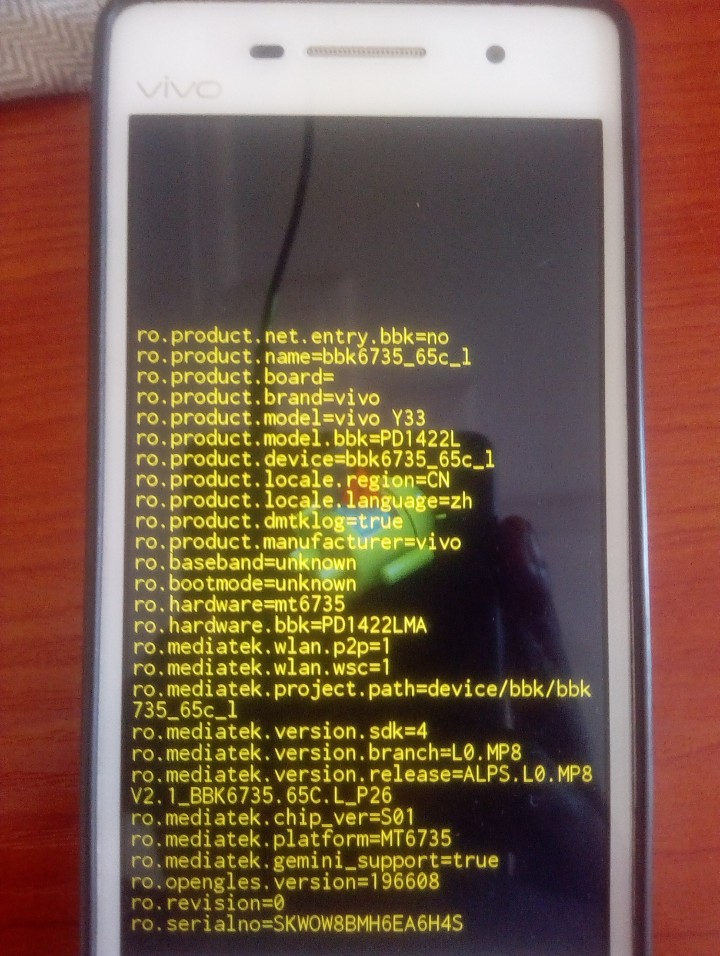

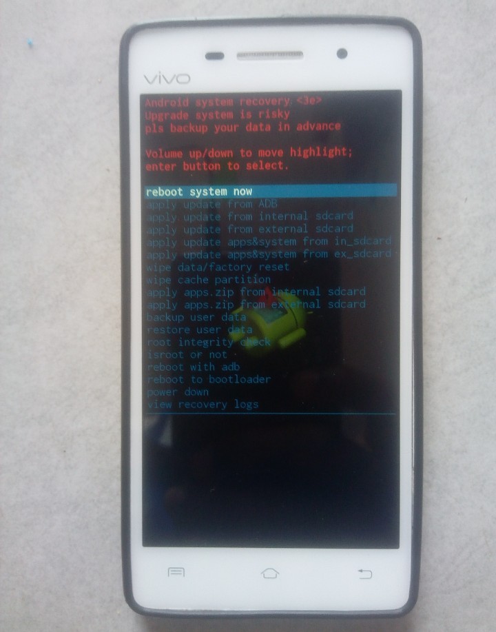

I was able to check the build of the phone through the recovery (photo attached).
What I am yet to do is check the build numbers of the 3 roms I have flashed in so far, just as you asked.
But I am sure this Vivo Y33 only has one variant. Though I noticed something new today. The recovery mode language is in English whereas it was in Chinese language before. I tried making backup Vai recovery from a phone I managed to lay my hands on today, but the phone recovery is in Chinese and I couldn't understand a thing.
