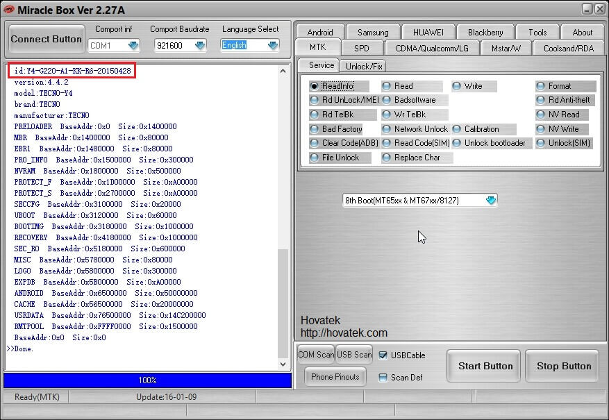

Read info with a box/dongle e.g Miracle Box
  • Download miracle box
  • Extract the contents of the zip file and launch the miracle loader
  • When the miracle box dashboard opens, click on the MTK tab then click on ReadInfo
  • Select your chip-set type from the drop-down (leave it at 4th auto if you don't know the chipset)
  • Click on the Start Button then connect your device while its powered off
  • Miracle box should display a lot of info > including ID: xxxxx
  • That's the build number of your device
    E.g Tecno Y4
    [Image: how-to-get-build-number-using-miracle-box.webp]

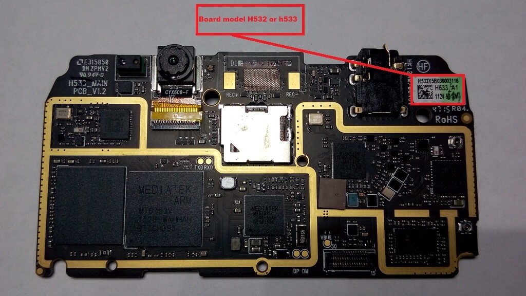

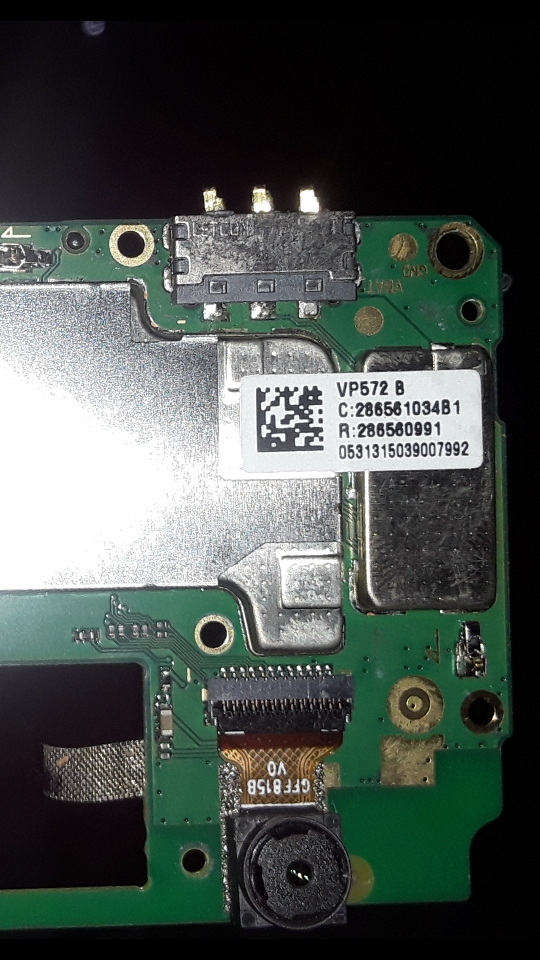

Mother Board
Loosen the phone down to the motherboard. You might find a part of the Build Number inscribed
E.g Infinix Note 2 X600
[Image: Infinix-X600-Motherboard.webp]

13-07-2018, 03:50 PM
Where can i find the build number on the motherboard?
50,906
13-07-2018, 11:19 PM
(13-07-2018, 03:50 PM)Marshall Where can i find the build number on the motherboard?
look around the motherboard of your device. there's no specific area where it will be indicated on the board.
also not all phone's will indicate this on the board either that's why there is more than one method
