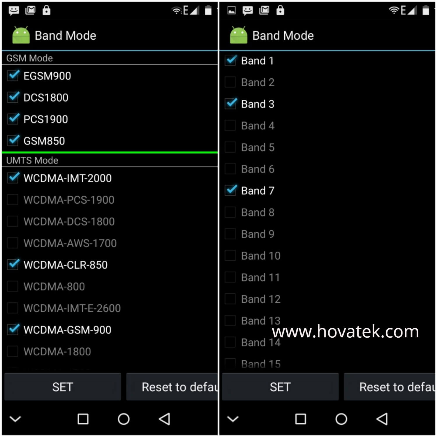

Several Forum posts and emails later, I was on a hunt for the reason why Gionee F103 wouldn’t support 3G or 4G for most Nigerian users, only 2G. I started by checking the specs online and 4G LTE was one feature but there was no mention of which bands. I was certain it was an incompatible band issue but had to prove it.
After quite some digging, it turns out some unlucky ones didn’t research the phone’s supported 4G LTE bands before purchasing.
I’ll show you some screenshots from Engineer mode > Band Mode of a Gionee F103 before I proceed.
And Here are some screenshots from my THL T7 (4G enabled)
Compared to my THL T7, the Gionee F103 doesn’t seem to support our 3G bands here in Nigeria. On the LTE band, we have band 38, 39, 40 & 41. According to the supported 4G / 5G bands in Nigeria table, it would only support 4G LTE sims from Swift and Spectranet.
Will flashing or upgrading fix this?
Very unlikely, unless there is some kind of global NVRAM for this model (which I doubt).
If you have this model and reside in Nigeria then try the above networks 4G SIMs and lets know if any works for you.

Hello everyone, although there are a lot of cloned phones out there(a whole lot, I mean Infinix hot 7 was cloned after just 2 months), Gionee f103 is not a clone, it’s a ts-cdma device due to the fact that it was meant to be used only in China. That’s the reason why it doesn’t work with Nigeria’s 3g and 4g bands and also playstore is banned from china
