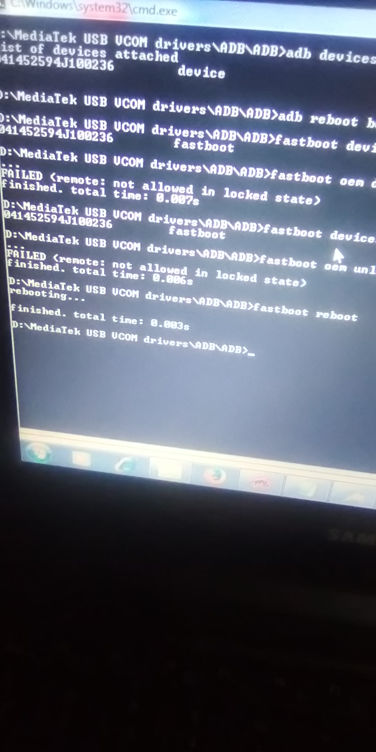

OK,I've tried flashing an empty vbmeta but the phone still gets red state warning and reboots after 5 seconds.I also found a solution for fastboot and now it is detected in fast boot mode but when I try to unlock the bootloader it fails.

attach a full clear screenshot showing the error you got while attempting to use the other unlock commands
