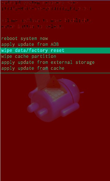

[Image: how-to-enter-recovery-mode-on-itel-phones.jpg]
  • On some Spreadtrum phones like the Innjoo Halo, you press Volume  increase or + instead of Volume decrease or -
  • If you're stuck at No Command with an Android on its back, Press Power button + Volume up (increase) button then release both. That should get you into recovery mode
  •  Above is a red-scaled snapshot of an Itel 1452 in recovery mode (Note that this isn't the original color)
  • On some devices, the boot combo changes when you switch from stock recovery to a custom recovery (i.e it could be volume down when on stock recovery but volume up when on custom recovery)
  • Its important you're able to distinguish between stock and custom recovery. The screenshot above is that of a stock recovery
