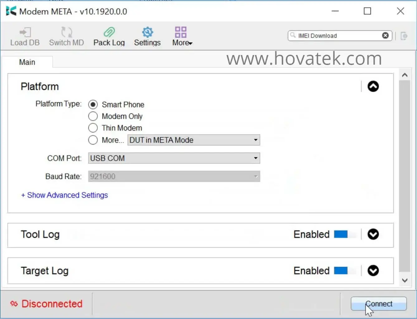

  1. Lauch Modem Meta
    [Image: How-to-use-modem-meta-to-write-IMEI-to-M...ces-1.webp]

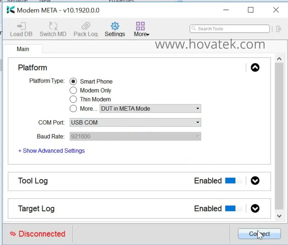

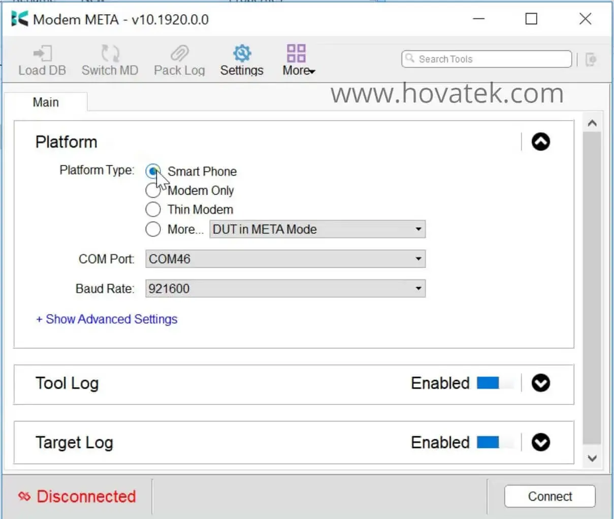

  2. Under Platform, select Smart Phone
    [Image: How-to-use-modem-meta-to-write-IMEI-to-M...ces-2.webp]

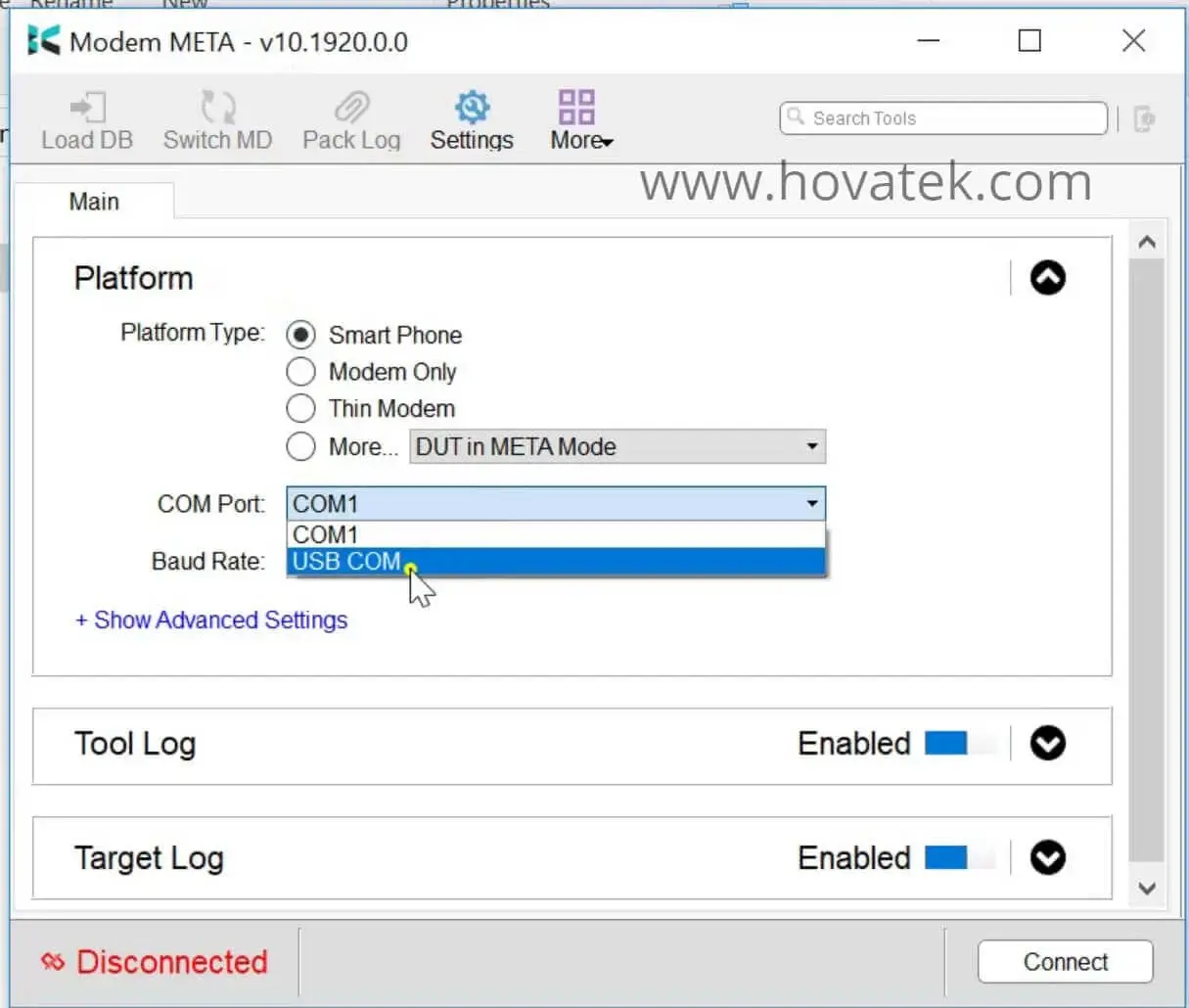

  3. Under COM Port, select USB COM
    [Image: How-to-use-modem-meta-to-write-IMEI-to-M...ces-3.webp]
  4. Click Connect
    [Image: How-to-use-modem-meta-to-write-IMEI-to-M...ces-4.webp]

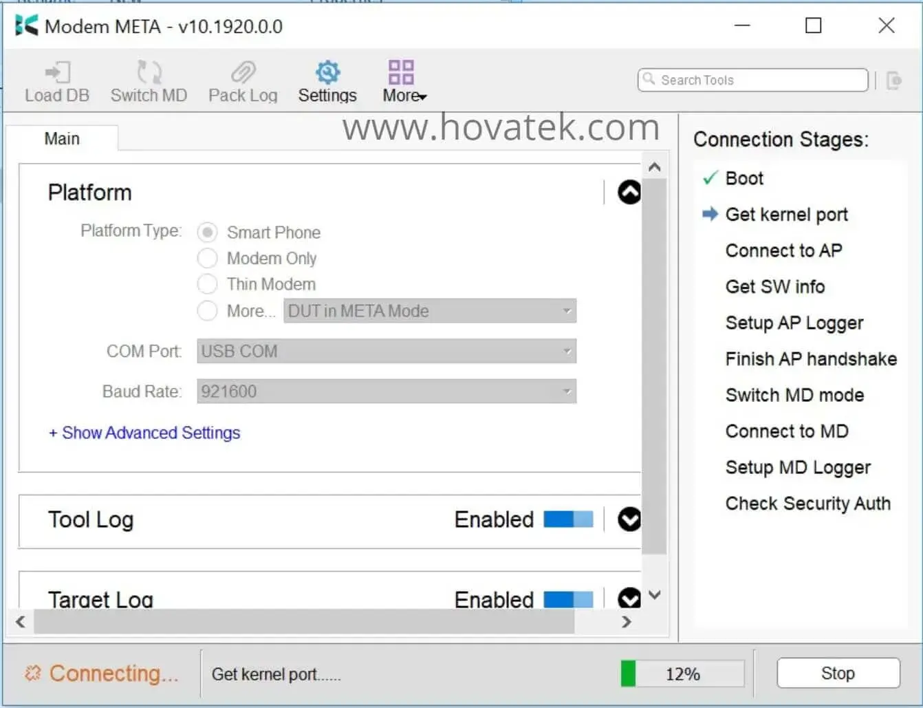

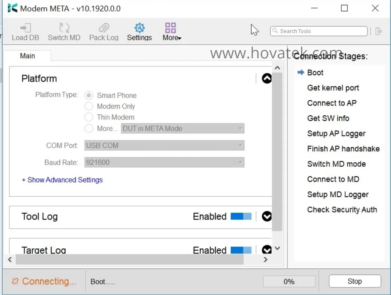

  5. Power off the device and connect to PC via USB cord (with battery inserted and not holding any button)
    [Image: How-to-use-modem-meta-to-write-IMEI-to-M...ces-5.webp]

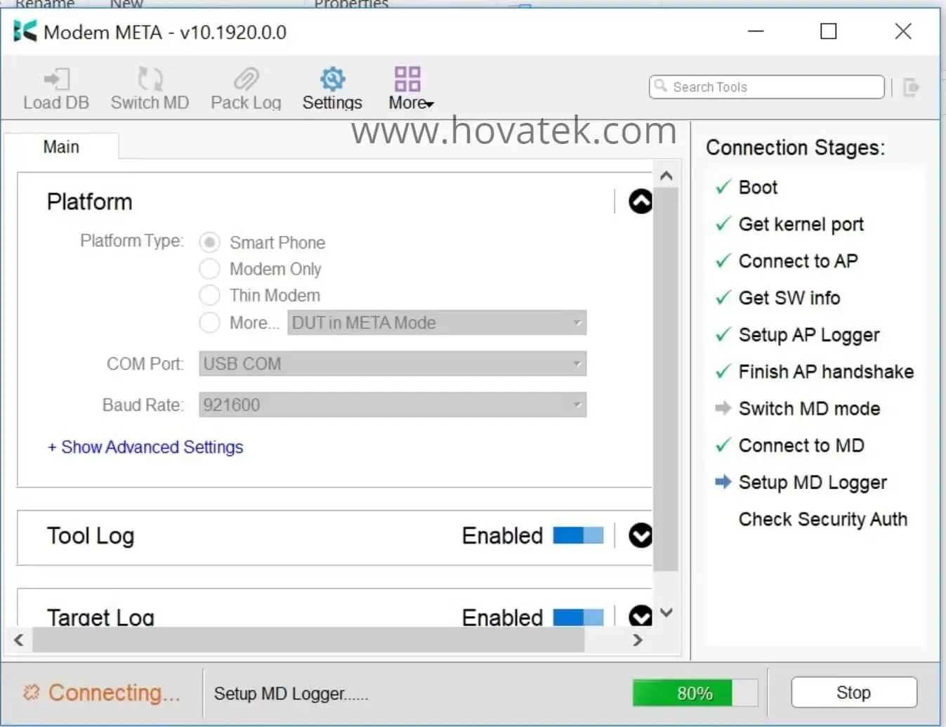

  6. Wait for the device to get detected
    [Image: How-to-use-modem-meta-to-write-IMEI-to-M...ces-6.webp]

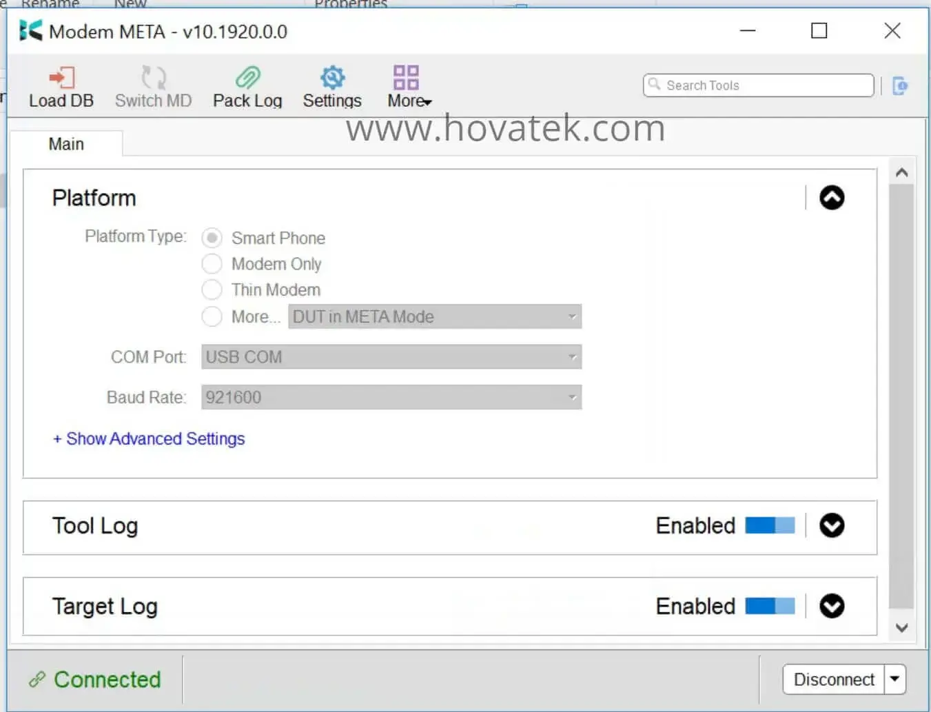

  7. The device should pass all connection stages if you'd correctly installed drivers and connected correctly
    [Image: How-to-use-modem-meta-to-write-IMEI-to-M...ces-7.webp]

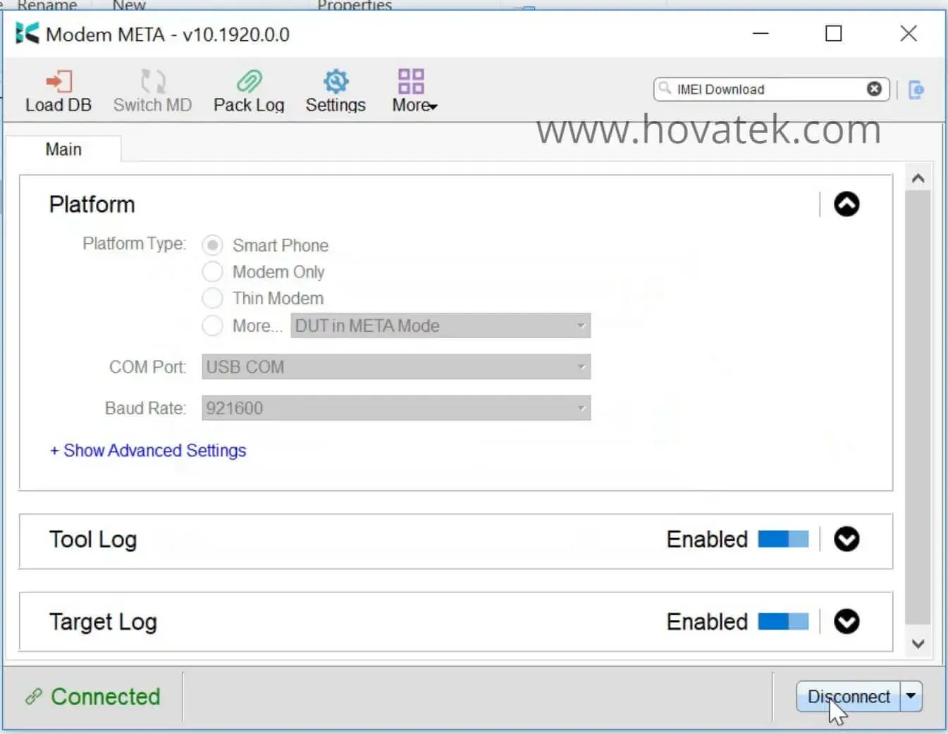

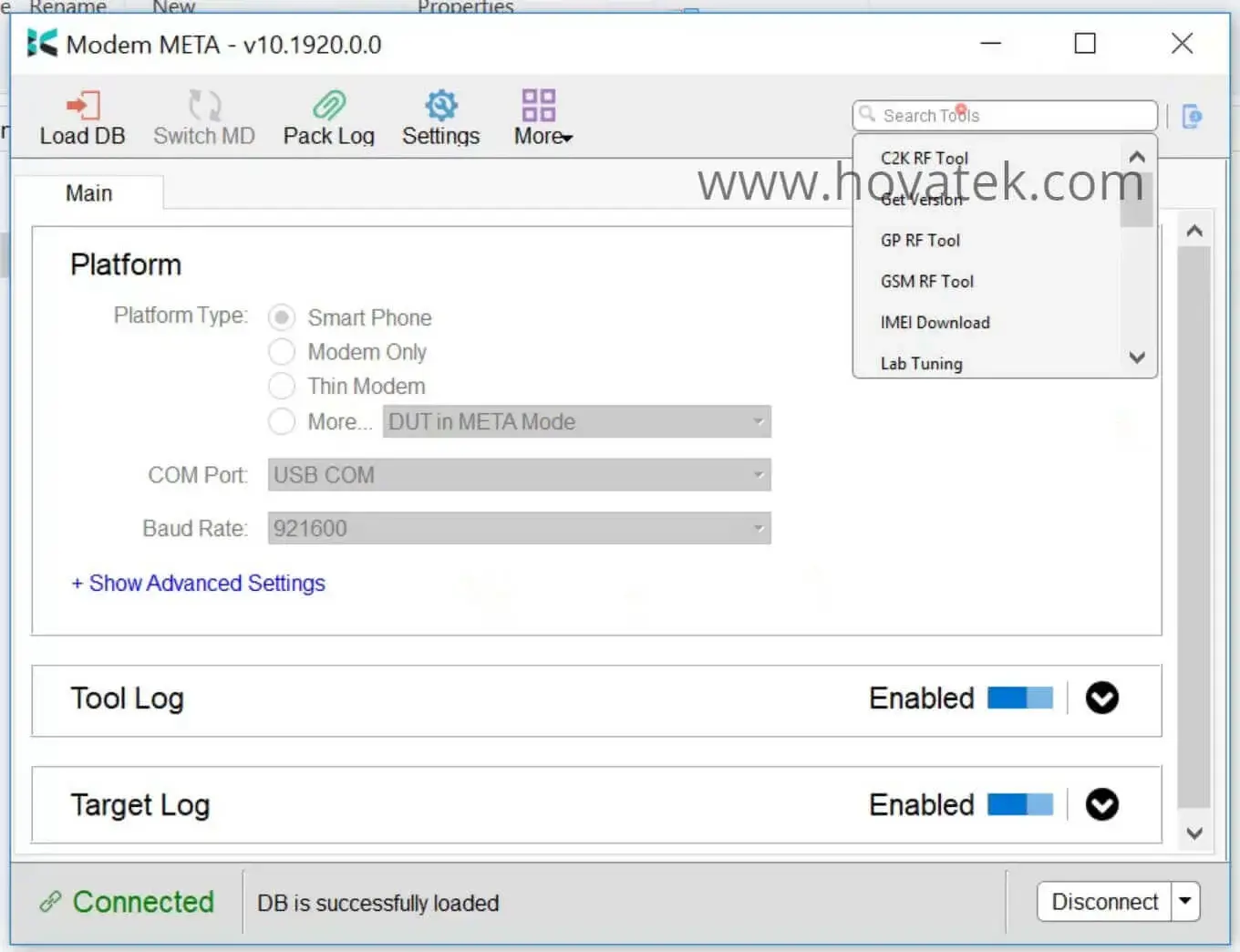

  8. You should see 'Connected' in green at the bottom left corner
    [Image: How-to-use-modem-meta-to-write-IMEI-to-M...ces-8.webp]

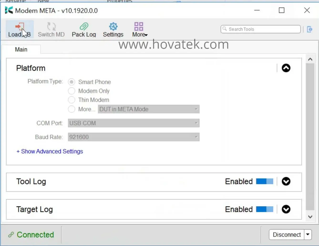

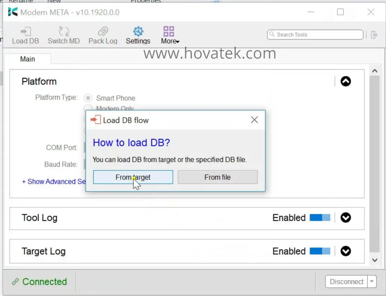

  9. Click Load DB at the top left
    [Image: How-to-use-modem-meta-to-write-IMEI-to-M...ces-9.webp]

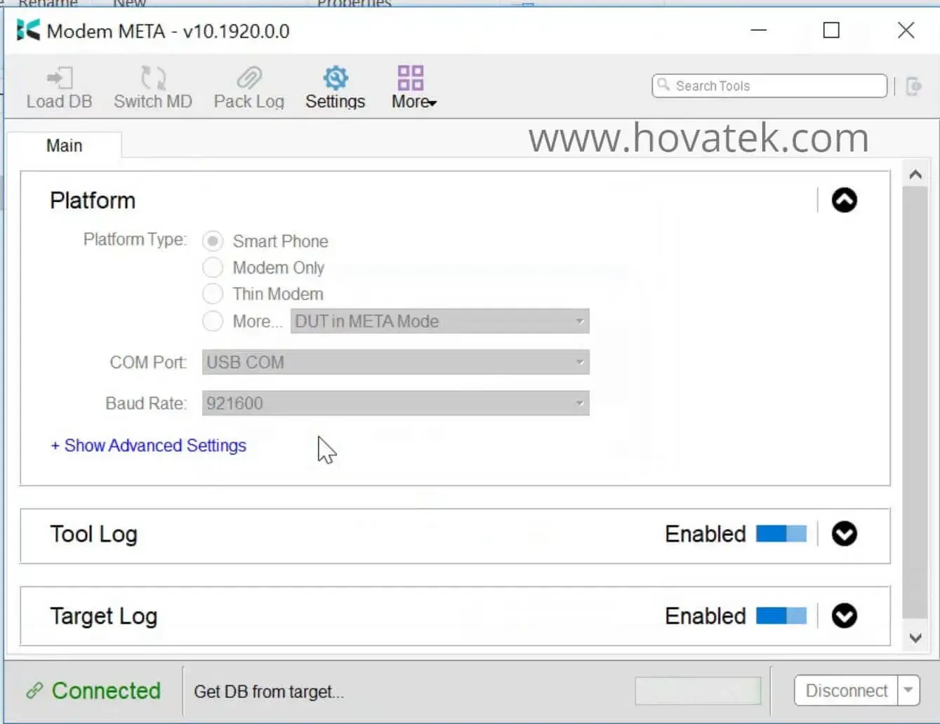

  10. In the Load DB Flow prompt, click From Target. If this fails then choose From File but you'll need the DB file for your model
    [Image: How-to-use-modem-meta-to-write-IMEI-to-M...es-10.webp]
  11. Wait while the tool gets and processes the DB
    [Image: How-to-use-modem-meta-to-write-IMEI-to-M...es-11.webp]

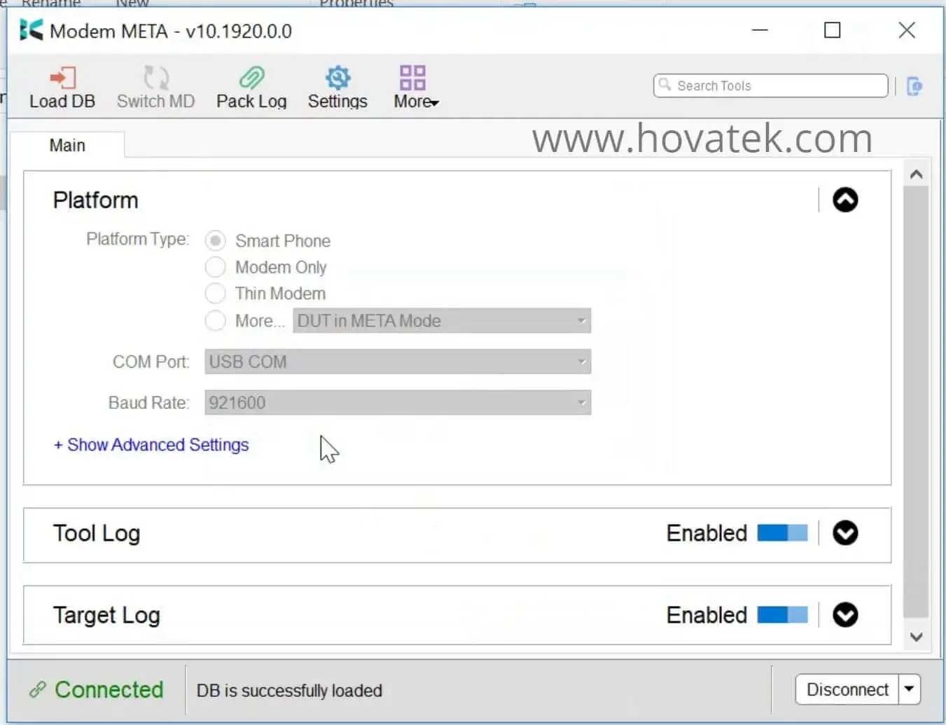

  12. Once successful, you should see DB is successfully loaded
    [Image: How-to-use-modem-meta-to-write-IMEI-to-M...es-12.webp]

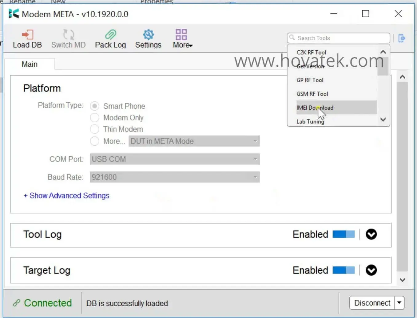

  13. Click the Search tools bar at the top right
    [Image: How-to-use-modem-meta-to-write-IMEI-to-M...es-13.webp]

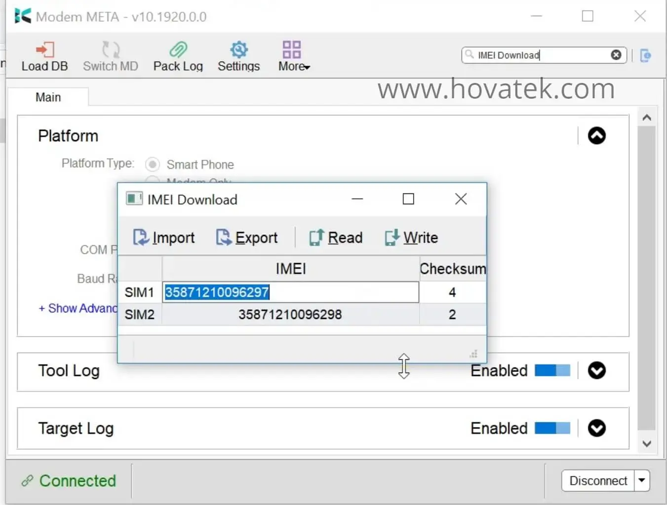

  14. Scroll and select IMEI Download
    [Image: How-to-use-modem-meta-to-write-IMEI-to-M...es-14.webp]

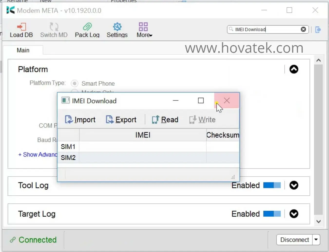

  15. The IMEI Download prompt should come up
    [Image: How-to-use-modem-meta-to-write-IMEI-to-M...es-15.webp]

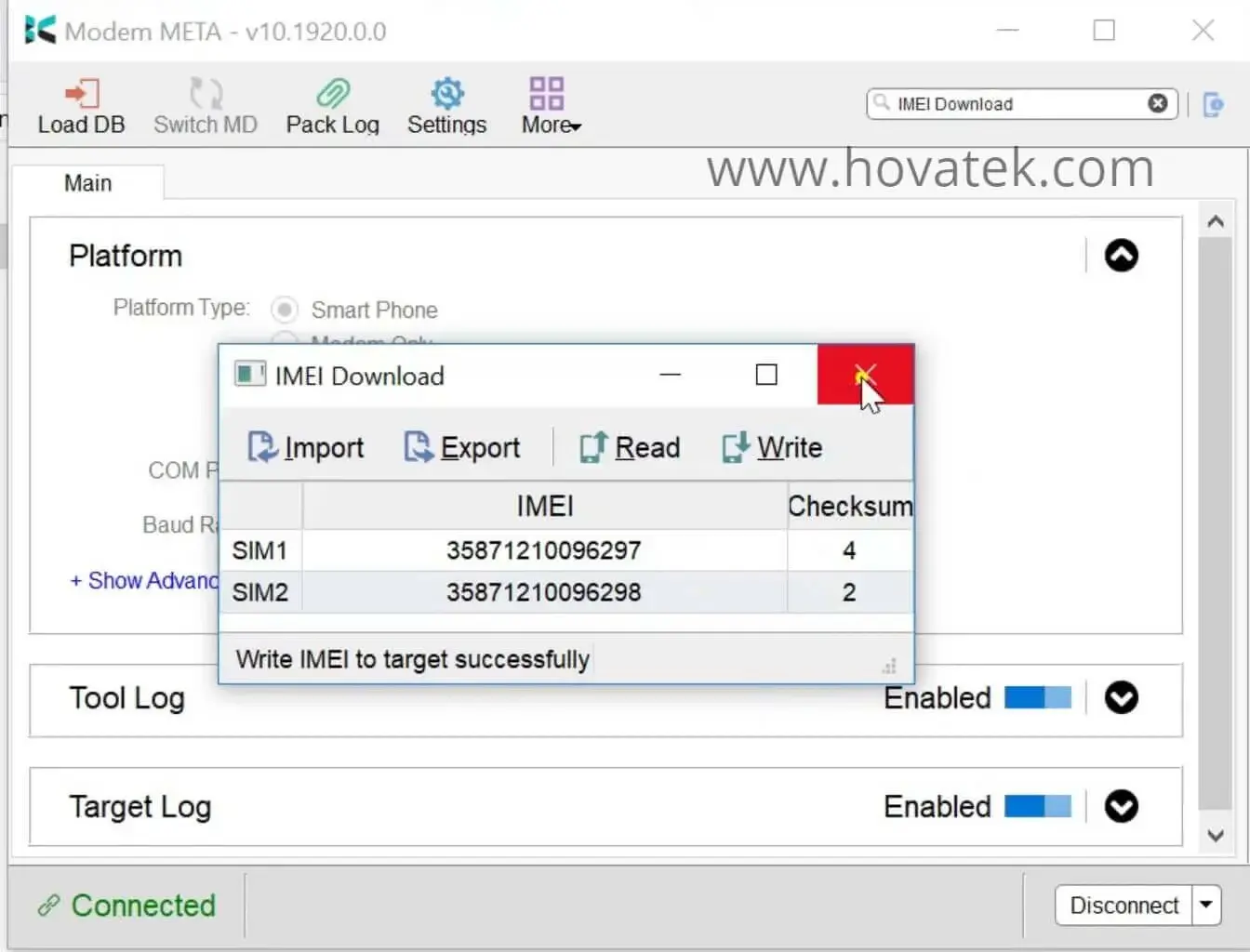

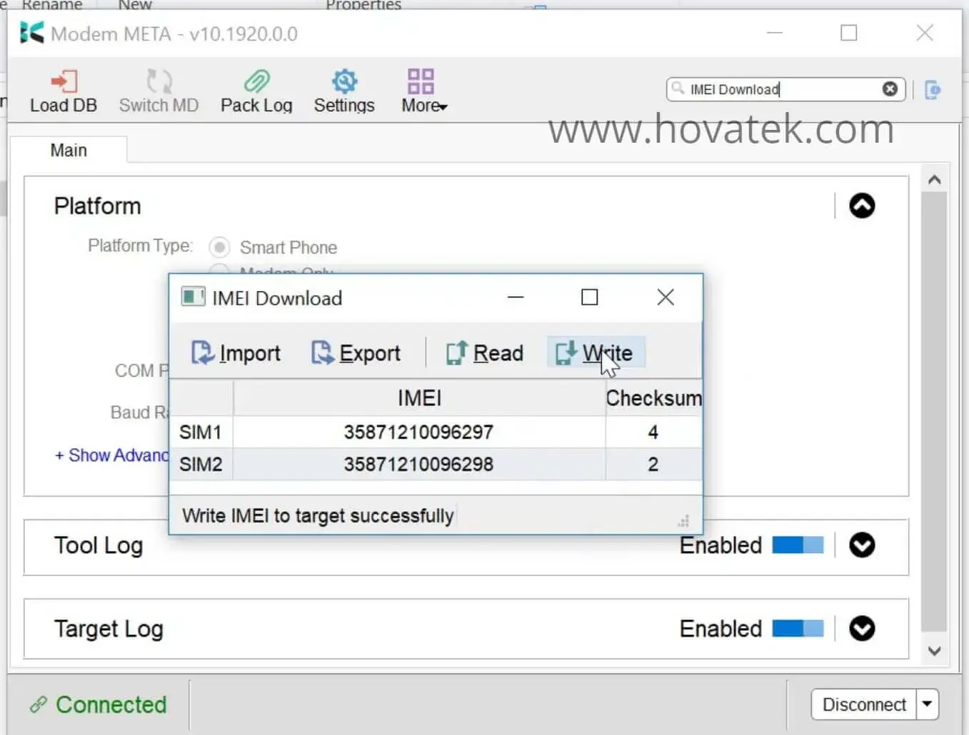

  16. Enter the first 14 digits of the IMEI you wish to write; the tool will automatically append the 15th.
    [Image: How-to-use-modem-meta-to-write-IMEI-to-M...es-16.webp]
  17. Click Write
    [Image: How-to-use-modem-meta-to-write-IMEI-to-M...es-17.webp]
  18. If done, you should see Write IMEI to target successfully
    [Image: How-to-use-modem-meta-to-write-IMEI-to-M...es-18.webp]
  19. Click the close icon
    [Image: How-to-use-modem-meta-to-write-IMEI-to-M...es-19.webp]

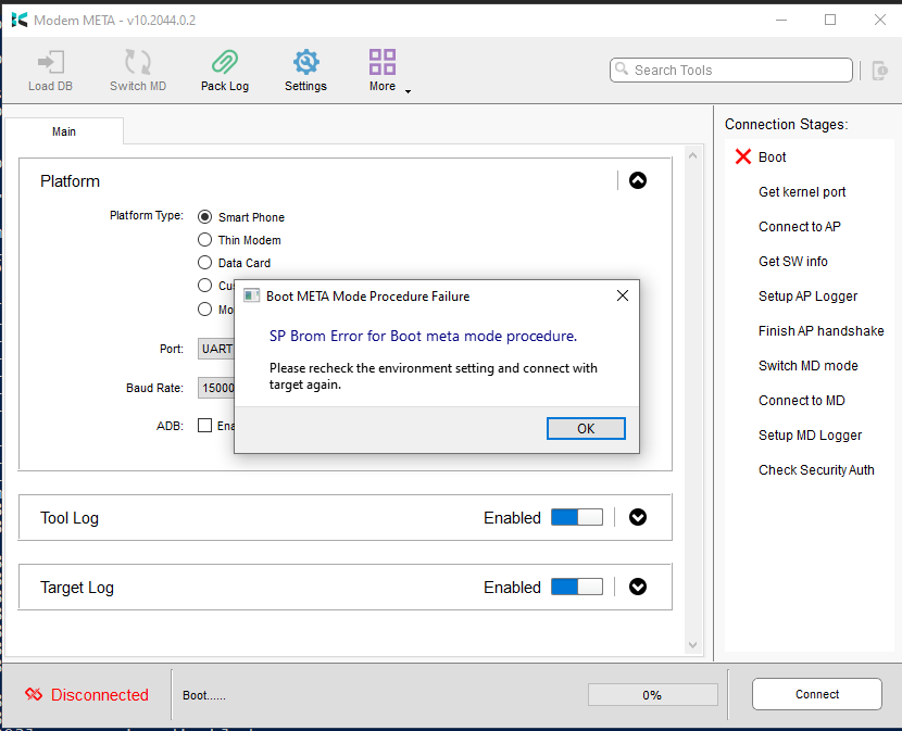

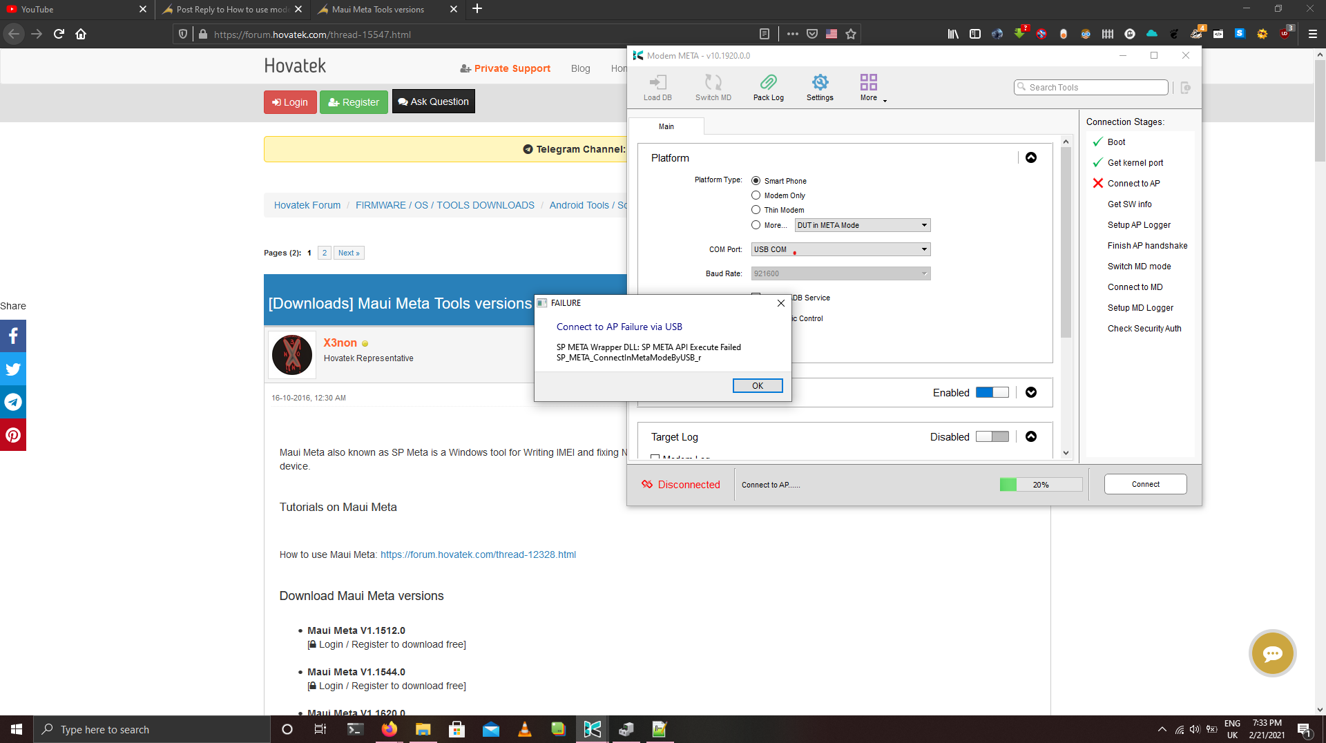

30-03-2020, 05:34 PM
hello,
i have problem while connect to MD, it always  failed. what is the problem?
https://drive.google.com/file/d/1Fz_3HgQ...sp=sharing
This post was last modified: 22-05-2020, 09:51 AM by X3non.
30-03-2020, 11:36 PM
(30-03-2020, 05:34 PM)ungiecoolz@gmail.com hello,
If it didn't work try other method @ https://www.hovatek.com/forum/thread-116.html .
This post was last modified: 22-05-2020, 09:52 AM by X3non.
