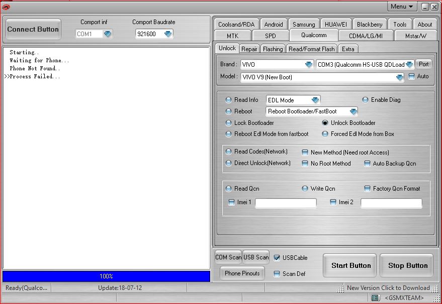

(14-11-2019, 12:06 PM)X3non
(14-11-2019, 01:47 AM)ahhl i am trying to flash firehose file to my vivo v9 to unlock my bootloader.
i manage to connect to edl mode. miracle can detect qualcom 9008. and it auto detect the correct port.
but when i press start button, it says waiting for device connection.
vivo v9 when connect to edl mode. the screen blank. is it what it suppose to be?
stick to your original thread @ https://www.hovatek.com/forum/thread-30847.html
can i still on this thread cause i use emmcdl to extract devinfo.img in works ( in edl mode) but miracle says phone not found
This post was last modified: 23-11-2019, 12:51 PM by ahhl.

(23-11-2019, 12:48 PM)ahhl can i still on this thread cause i use emmcdl to extract devinfo.img in works ( in edl mode) but miracle says phone not found
you selected "unlock bootloader" in miracle, that operation can only be carried out while the phone is in fastboot mode not edl mode
you should use the method @ https://www.hovatek.com/forum/thread-19578.html if you're trying to unlock bootloader

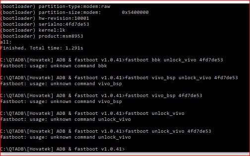

(23-11-2019, 11:38 PM)X3non you selected "unlock bootloader" in miracle, that operation can only be carried out while the phone is in fastboot mode not edl mode
thanks.
is there anyway to unlock using edl? i have sent my phone to repair shop, they use mrt dongle, still unsuccessful
I have tried using fastboot command as per that thread, non working. theres specific fastboot for other vivo created, but still not successful
i might go emmcdl way if it work. i can extract boot. img, i can patch with magisk, i have not try to flash, until i am sure it will not cause bootloop and i am asking around xda and here.

(24-11-2019, 02:07 AM)ahhl thanks.
Sent from my Redmi Note 7 using Tapatalk
i already answered in my previous reply that bootloader can ONLY be unlocked in fastboot mode
about fastboot not working, ensure you're using latest adb & fastboot version ; download @ https://www.hovatek.com/forum/thread-26886.html (run the command "adb version" to verify you're using the latest version) and if there's an error message when you attempt to unlock bootloader, attach a full screenshot of the error

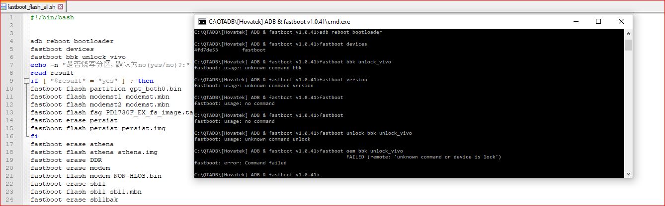

i also found a file fastboot_flash_all.sh in the firmware update file which contain fastboot command to unlock bootloader but when i issue command following the format, it doesnt work.

(25-11-2019, 12:05 PM)ahhl can i ask about fastboot command here, not at the fastboot section. i don't want to skrew because of posting all over the place it just happend that i am searching for solution and stumble on certain thread, so it comman to ask there.
i try searching hidden fastboot command. i manage to extract some string from aboot.img ( i use emmcdl to extract)
but have tried to issue some command, not successful. attached some file i extracted.
regular adb & fastboot mostly support only oem commands and won't support device specific commands like the ones you have in your screenshot, you mentioned earlier that you tried special fastboot for vivo that didn't work... is it the same "unknown command error" you got or some other error message?
https://drive.google.com/open?id=0BwcKR-...TJkWXAzcUU ; is this the same vivo fastboot binary you tried using?

(25-11-2019, 05:27 PM)X3non
its the same unknown command error.
i am using hovatek latest adb/fastboot.
ok. i ll try using adb/fastboot from the link
