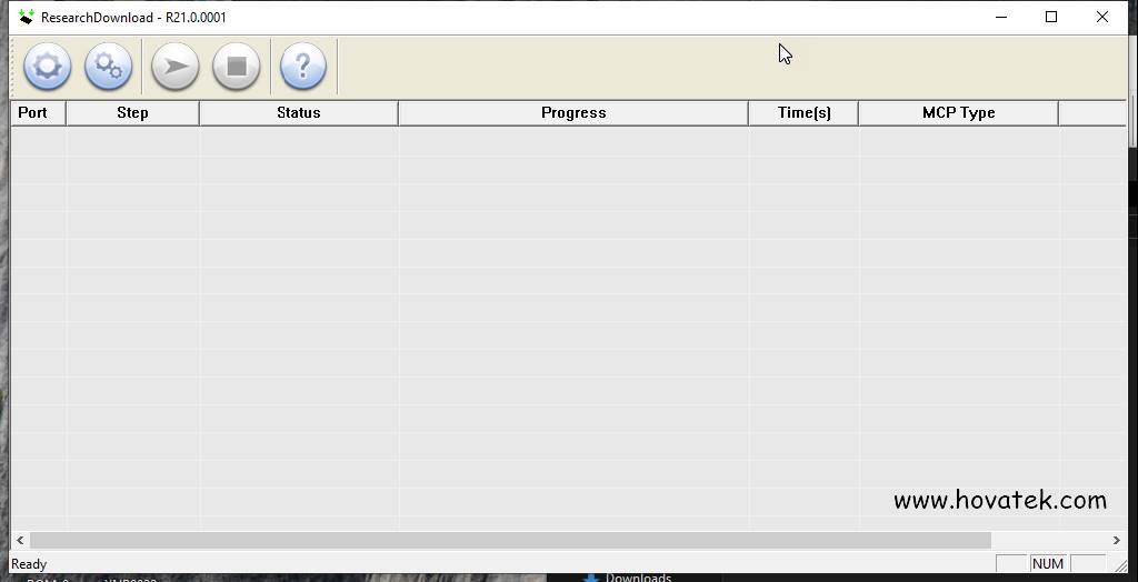

  1. Launch the exe i.e ResearchDownload.exe

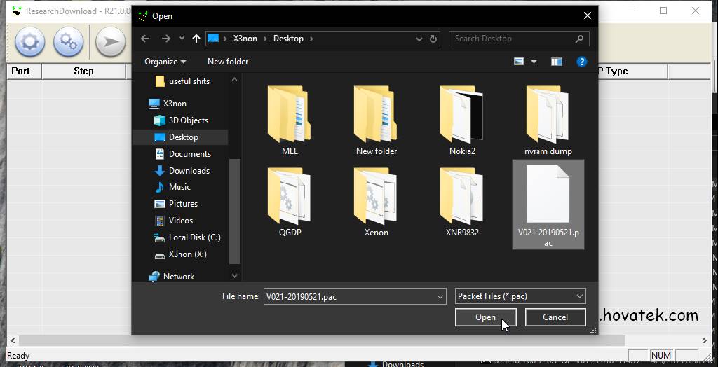

  3. In the window that pops up, navigate to the location of the .pac file, select it then click Open

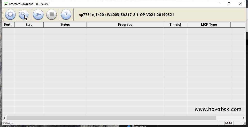

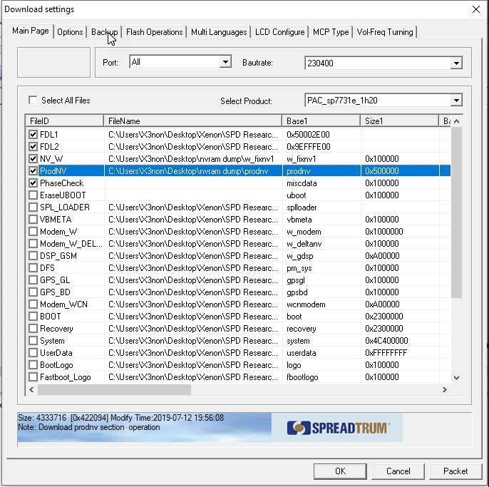

  5. Click the Settings Icon (top left corner)
    [Image: how-to-flash-single-files-onto-a-spreadt...Tool-5.jpg]

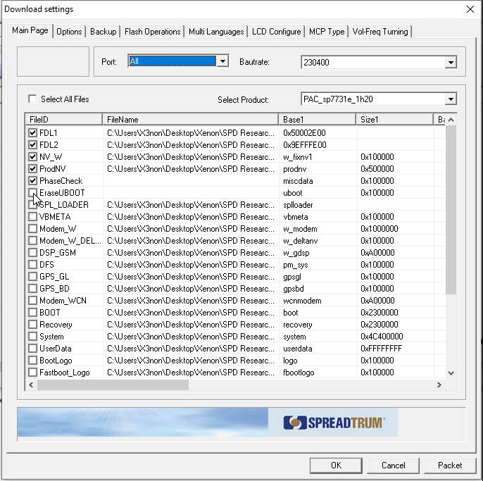

  6. In the window that pops up, untick any item(s) you do not wish to flash then click OK and note that fdl1&2 must remain ticked. e.g if i want to flash twrp recovery.img then i'll untick all except fdl1&2 and recovery but for this tutorial i'm flashing nvram backup and the backup contains prodnv and nv file so i'll untick all except fdl1&2, nv_w and prodnv

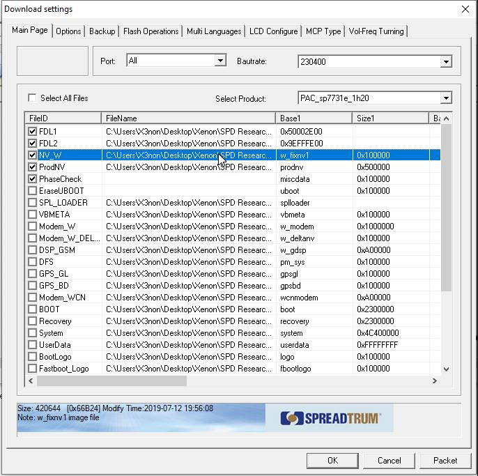

  7. Right click on the file name of the item you have ticked i.e the items to intend to flash (do this for each, one after the other)
    [Image: how-to-flash-single-files-onto-a-spreadt...Tool-7.jpg]

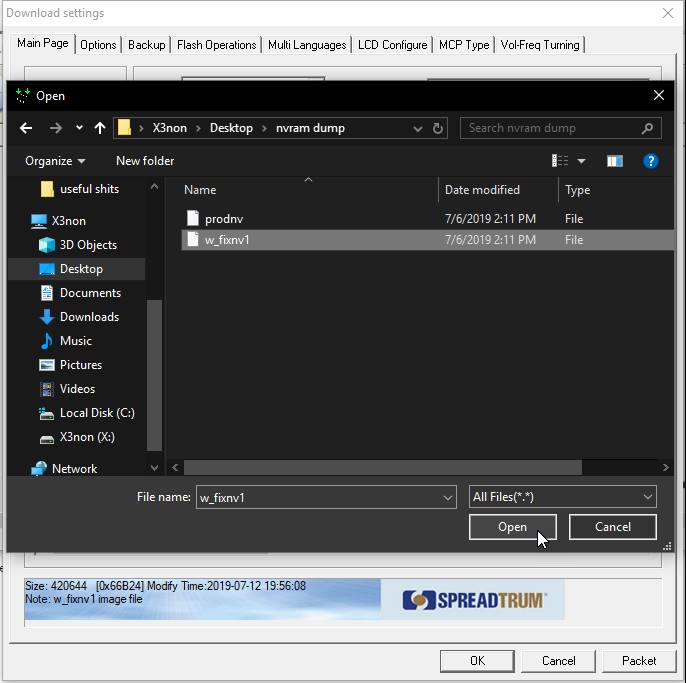

  8. A new window will open, navigate to and select the file you intend to flash
    [Image: how-to-flash-single-files-onto-a-spreadt...Tool-8.jpg]

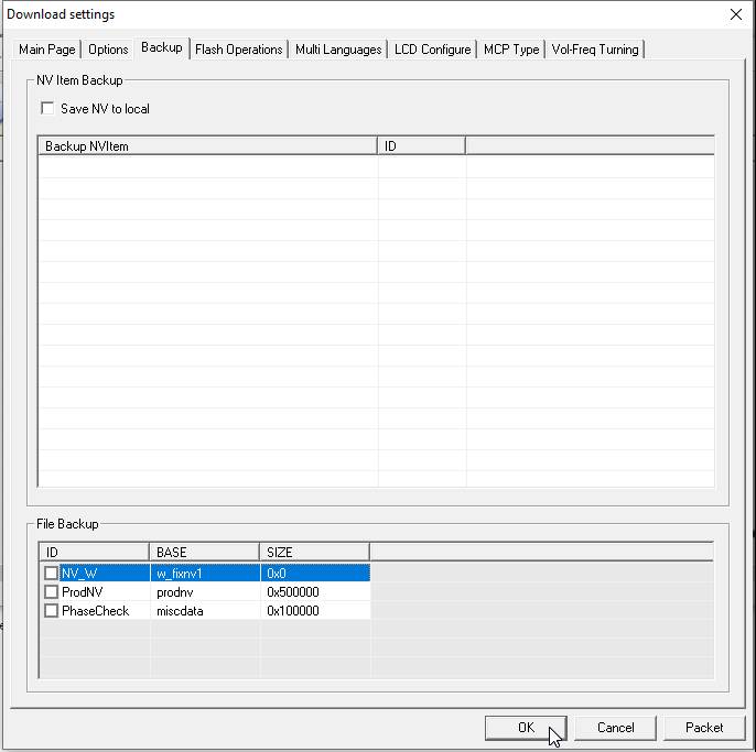

  9. Click the "Backup" tab (Do this only if you're flashing NV)
    [Image: how-to-flash-single-files-onto-a-spreadt...Tool-9.jpg]
  10. Untick all the items under "File Backup" section (Do this only if you're flashing NV)

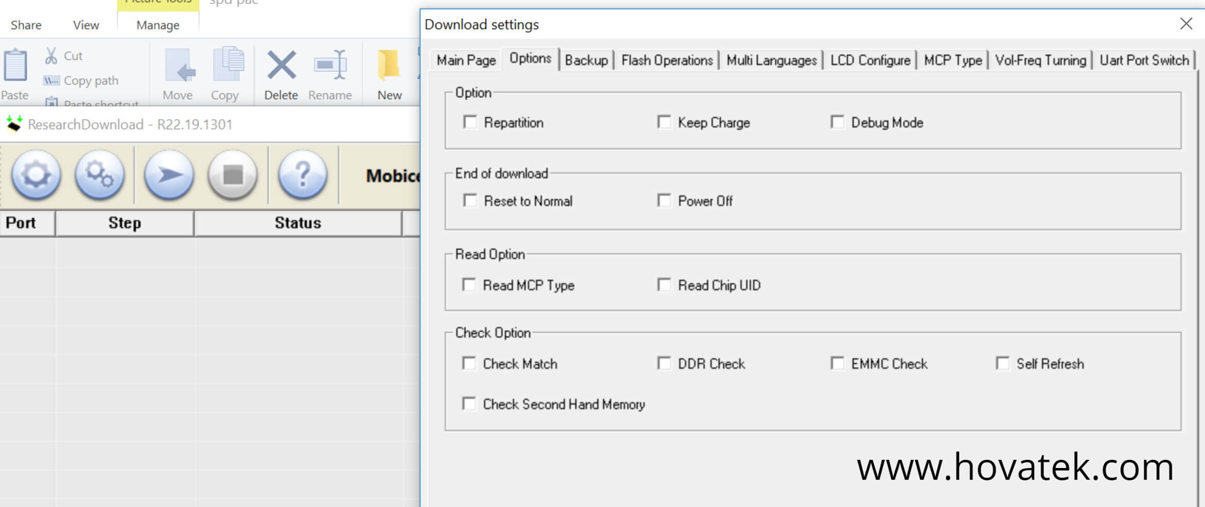

  11. Navigate to the Options tab and untick Repartition
    [Image: build-SPD-pac-using-research-download-tool-17.jpg]
  12. Click Ok
    [Image: how-to-flash-single-files-onto-a-spreadt...ool-11.jpg]

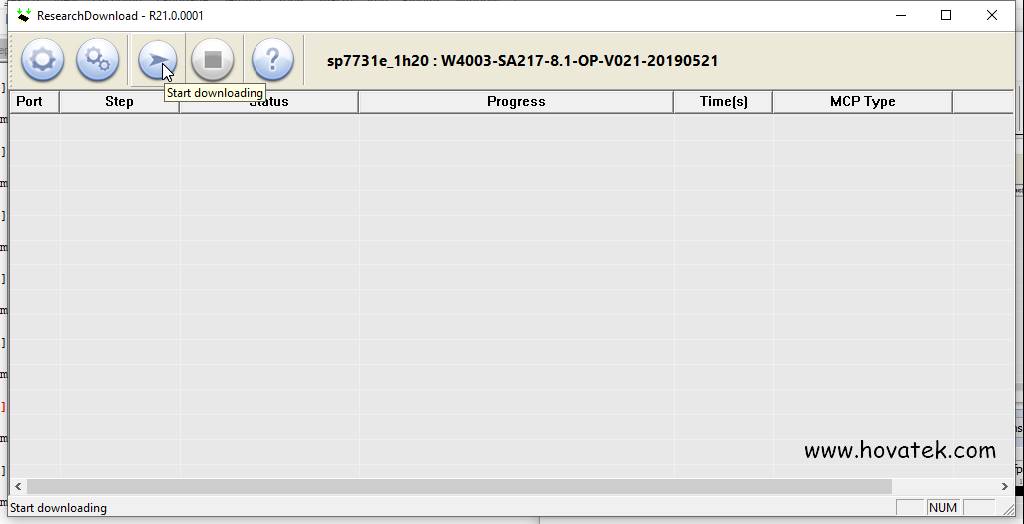

  13. Click the Start downloading button
    [Image: how-to-flash-single-files-onto-a-spreadt...ool-12.jpg]

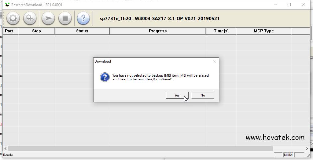

  14. If you're flashing NV items, then you'll get a prompt that you have not selected to backup imei item... Click Yes to proceed
