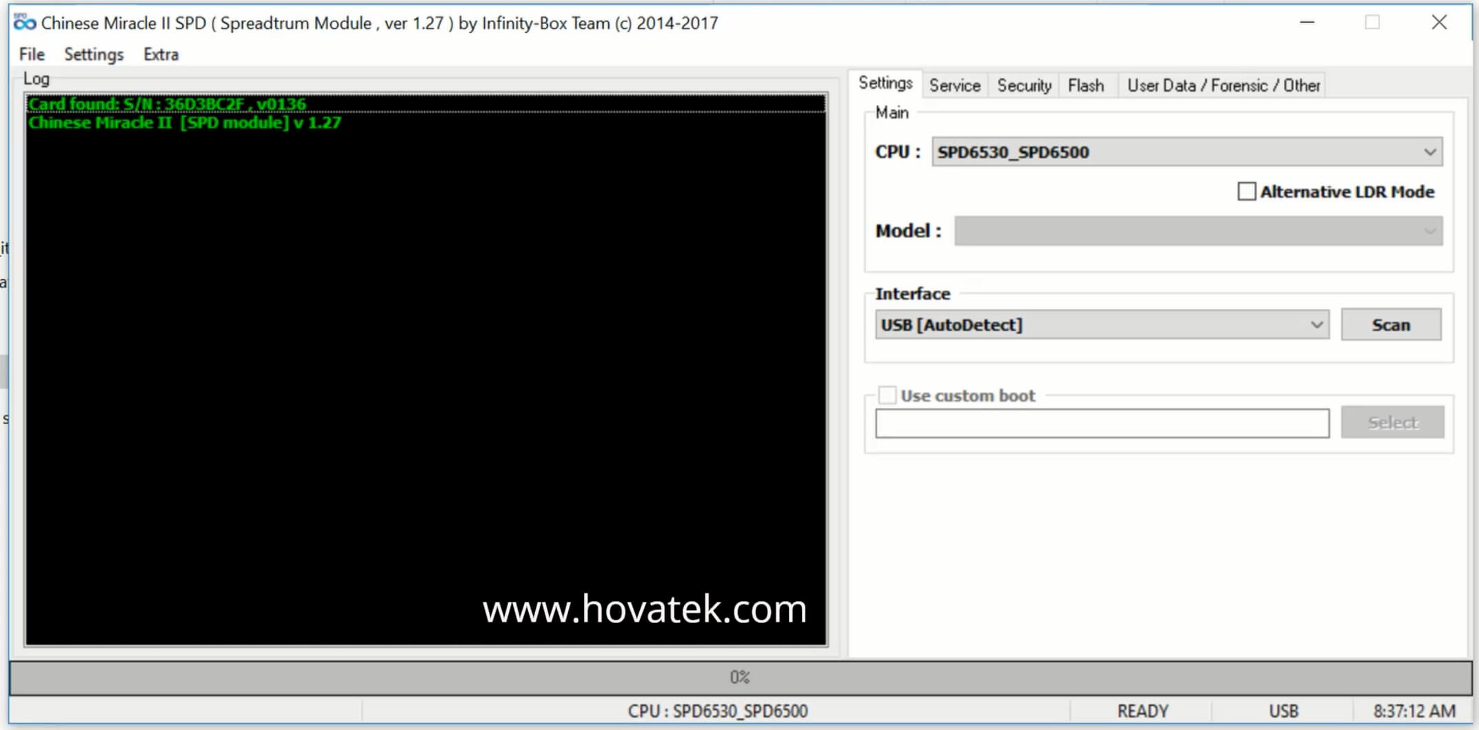

  1. Launch Chinese Miracle II SPD
    [Image: How-to-convert-Chinese-Miracle-II-CM2-SP...file-2.jpg]

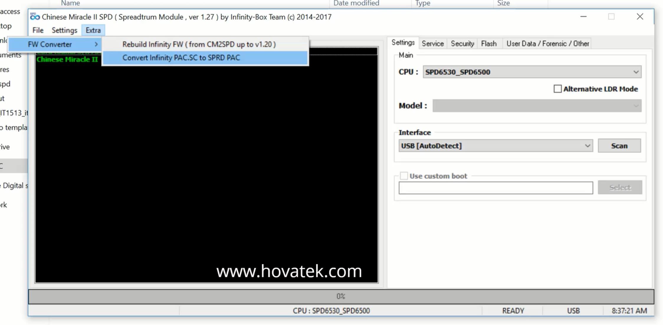

  2. At the top, click Extra > FW Converter > Convert Infinity PAC.SC to SPRD PAC
    [Image: How-to-convert-Chinese-Miracle-II-CM2-SP...file-3.jpg]

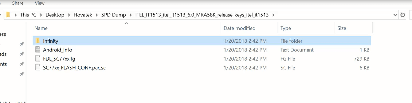

  3. In the Window that pops up, navigate to the location of the CM2 SPD backup, highlight the pac.sc file and click Open
    [Image: How-to-convert-Chinese-Miracle-II-CM2-SP...file-4.jpg]

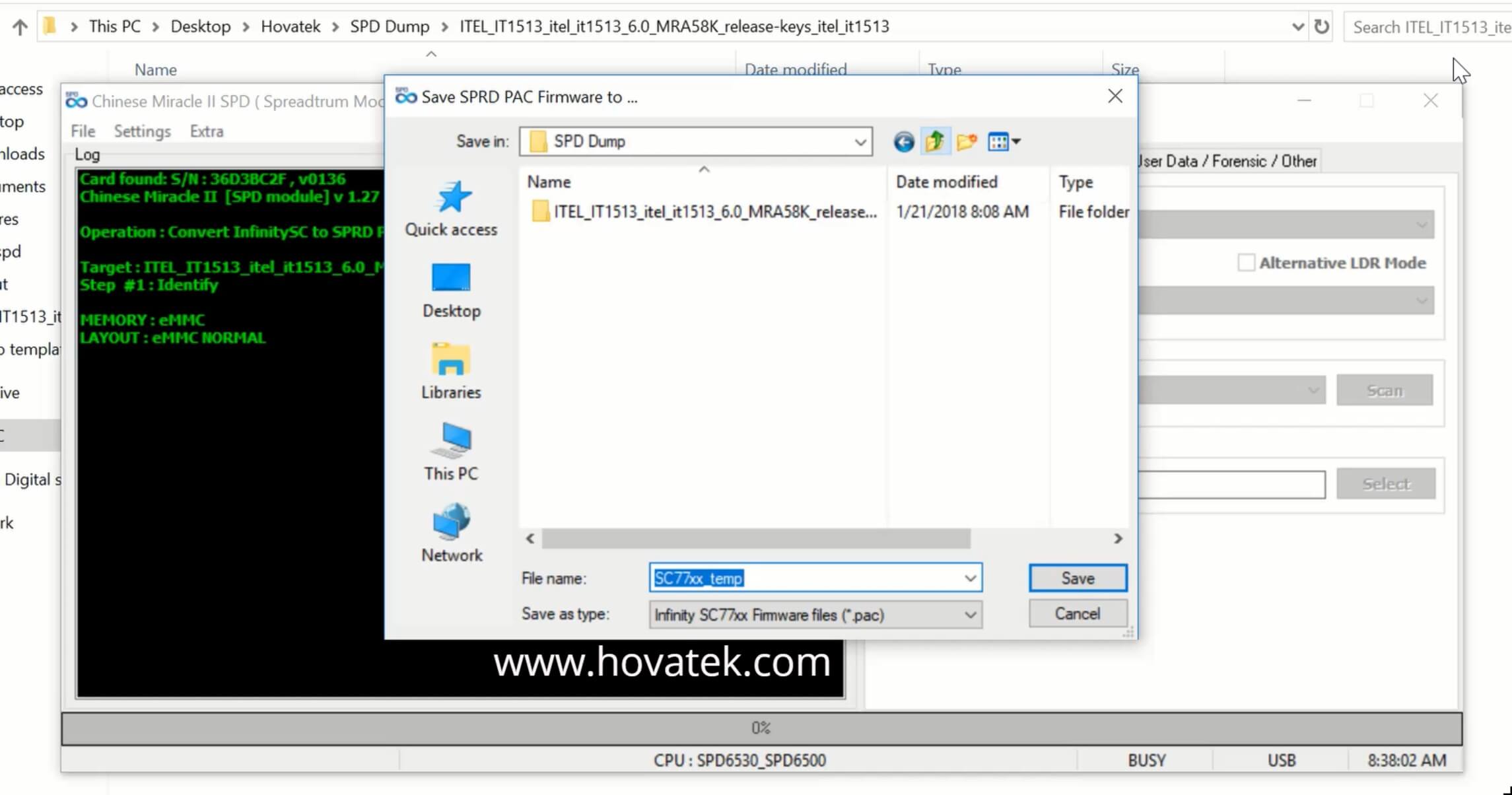

  5. In the next Window that pops up, navigate to the location you wish to save the pac file to and click Save
    [Image: How-to-convert-Chinese-Miracle-II-CM2-SP...file-6.jpg]

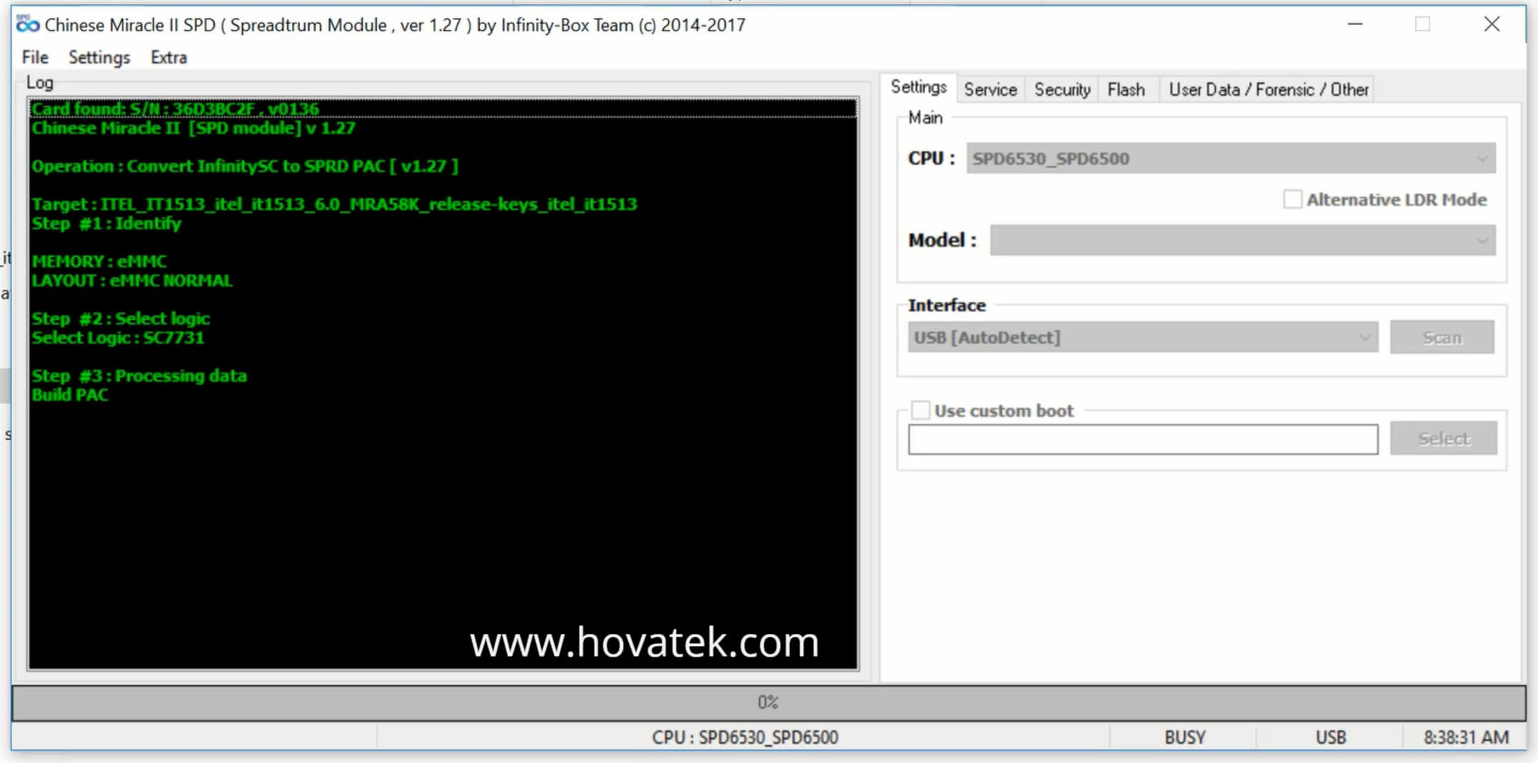

  6. CM2 SPD should start processing the pac file
    [Image: How-to-convert-Chinese-Miracle-II-CM2-SP...file-7.jpg]
  7. CM2 SPD should now start packing the various partitions into a pac file
    [Image: How-to-convert-Chinese-Miracle-II-CM2-SP...file-8.jpg]
  8. Once packing is done, CM II SPD should start signing the PAC file
    [Image: How-to-convert-Chinese-Miracle-II-CM2-SP...file-9.jpg]
