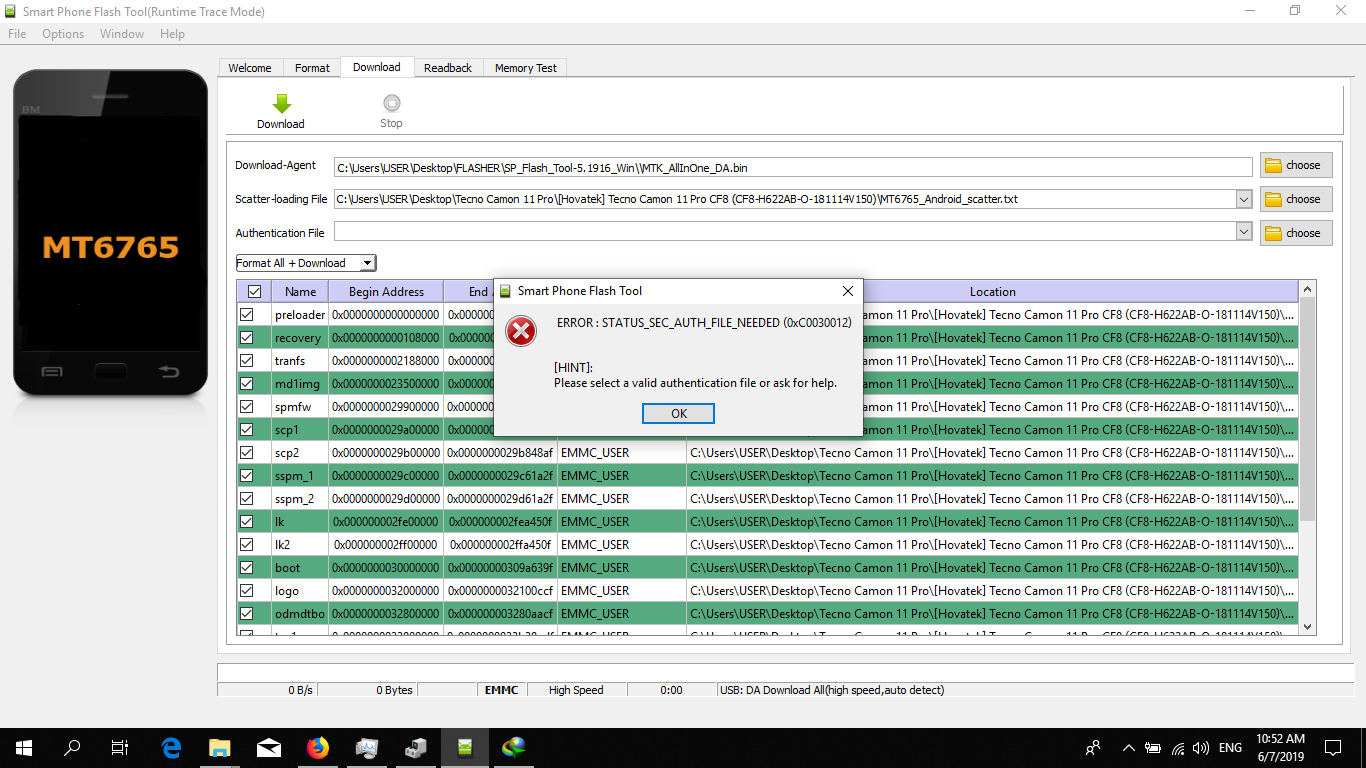

i am having this error on flashing my Tecno camon  11 pro
 error : status_sec_auth_file_needed (0xc0030012)

(07-06-2019, 10:53 AM)Onipede1 i am having this error on flashing my Tecno camon  11 pro
you're not supposed to format an mtk secure boot phone, change format all + download to download only
then download and use custom DA for your model @ https://www.hovatek.com/forum/thread-23243.html

i tried i the custom DA of camon 11 pro to do the download but is still given me the same error
What error does it give now? can you attach screenshot of the error.
Also, try flashing the firmware using the Software Download Tool @ https://www.hovatek.com/forum/thread-23709.html

i used different version of sp flash from (SP_Flash_Tool_v5.1524.00.000 to SP_Flash_Tool-5.1916_Win)
but still give me same error. please what should i do

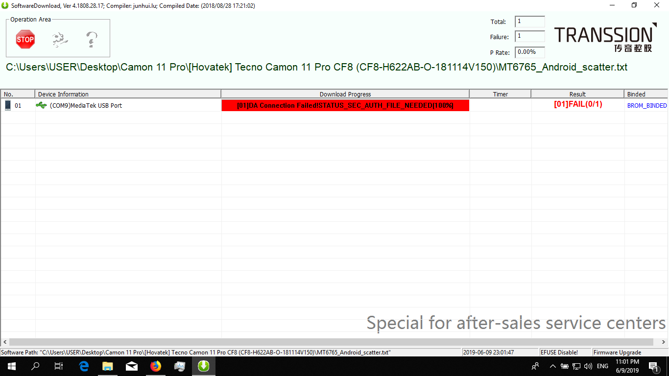

i used software downloader still give same error

(09-06-2019, 11:06 PM)Onipede1 i used software downloader still give same error
what is the present condition of the phone? and how did the problem begin?
and you're to try using latest version of software download tool @ https://www.hovatek.com/forum/thread-23708.html
